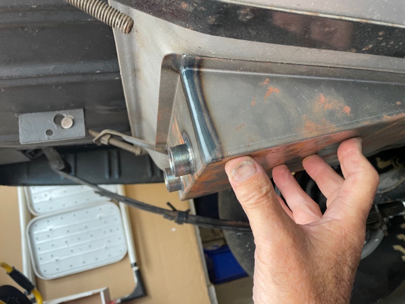

So this is the plan. Combination of stock tank and tailpipes gives pretty much one option for mounting the pump. I’m using a Holley HP150 which should be adequate. As welding will be required, I’m waiting for a new tank to work on. First job is to weld on the pre fabricated Comp Engineering sump.

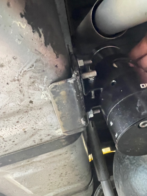

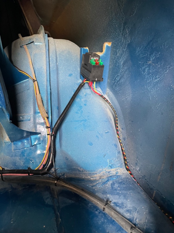

The pump will sit in the very tight space between the tank and axle, adjacent to the shock. I’ve made a mount which will be welded direct to the tank which gives as much clearance as you can get. The relay and fuses mount neatly to the now redundant jack stowage bracket and everything is wired direct to the battery for maximum output. Can’t do anymore till I have the tank fitted and then I can decide how best to plumb it.

Like the sump Blue. Not sure if i missed it, but what size lines are you going to use?
Posts: 14658
Re: Blue's Barracuda
AN10 into the pump and then AN8 going to the front, that’s the equivalent of 1/2” Dave.
