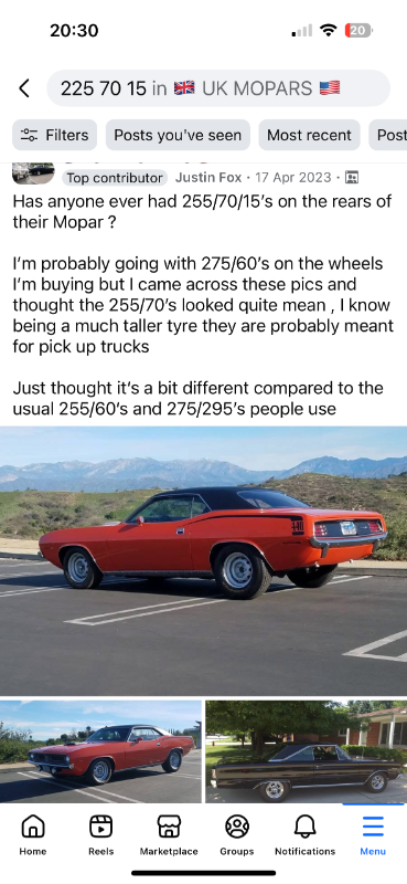

Here’s an ebody with 255/70/15…not my car.

Thanks for replies,much appreciated.Im up north near Lancaster but thanks for offer to mock up youre wheels.Yes refurb.arch springs ,there is a place in North West that does classics.The 255/70/15s pic is cool,it would create ground clearance for sure but looks too crazy high for me.

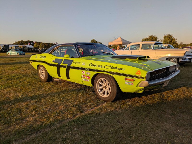

My exhausts are genuine T/A boxes with the forward facing side exits pipes, no ground clearance issues and I live in a town with 10 speed humps.

Thats a great tribute car,i want to make some t/a side pipes for mine,ive already got hood scoop
