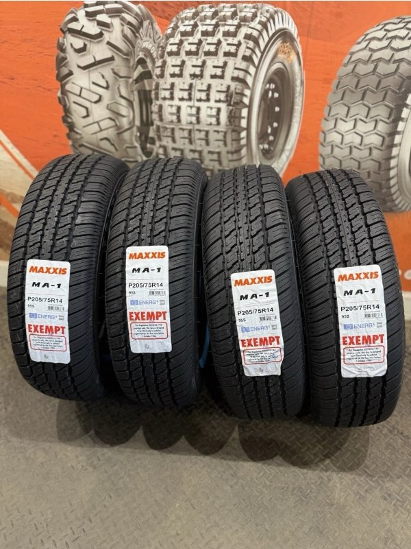

Kilnhurst Tyres and Exhausts Ltd on Ebay are doing some great deals on 4 Maxxis tyres (£360 with free fast delivery). I dont think thats bad at all. Quite hard to find 14" tyres that look period so Im pleased. Will post some pics when they are done

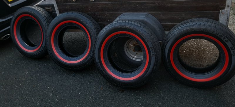

Visited Ant at Mr Whitewalls today and he did a grand job on the tyres for me.
At the moment Im a bit inbetween the 'less is more' camp and 'go big or go home'

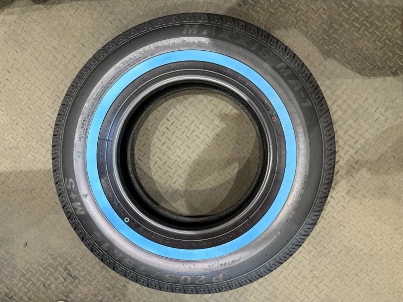

As was explained to me, there are perameters and limits to the process so I had a choice to make. The tyres I bought had a fairly thick raised whiteline, thicker than a standard 3/8 line.
The choice was to cut a 3/8 shallow groove in the black side of the tyre but the red line would probably be affected by the black 'bleeding through' and would turn it brownish. Alternatively (and recommended) was to scuff the whiteline and do that red. Backed by the white would make the redline much sharper, bolder and permanent so I went for that.
In a perfect world it would be a bit narrower but I still really like it and am looking forward to seeing them on the wheels after the New Year.

- 20251220_130629.jpg (163.7 KiB) Viewed 115127 times
- 20251220_130515.jpg (150.66 KiB) Viewed 115127 times

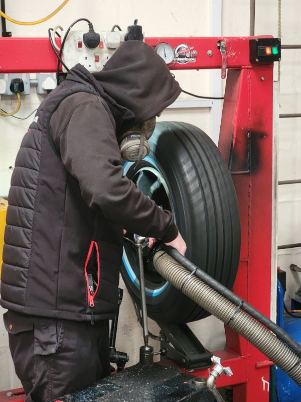

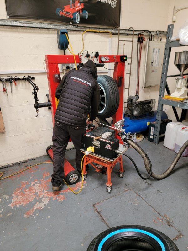

Ant was great, he took plenty of time explaining the pros and cons and was 100% sure the colour and durability would be much better on the existing whiteline. The redline now is raised from the tyre wall as he scrubbed the blue coating and a thin layer of white off with the machine he uses. The other way, on the black side is slightly sunken on the wall, though only very slightly but can be a width of your choice. Colour bleed from the black is also a concern that he took time to explain.

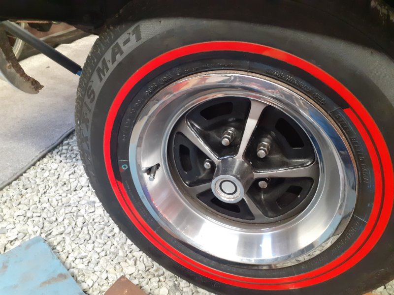

Finally got the tyres on my painted 500s and as I suspected, I was a bit disappointed as the line was definately too thick. Looked too bling for my liking.
I must point out that this in no way reflects on Ant at Mr Whitewalls. He talked me through the pros and cons of what he could do and I just made the wrong choice. On hindsight, I would have put the line on the black side of the tyre, 3/8" and risked the black bleed through.
However....I think Ive sorted it.......

Used a sharpie to draw the line whilst spinning the wheel and some really good black tyre paint. Not cheap but worth it. Im much happier with the look now. Will put a few more coats on then move on to the other wheels.

Thanks gents. Ive only done the one so far so will chip away at it and take some shots of the car when its all done. That tyre paint is very good (black). Ive used stuff in the old days on cars that looked good for a few days then cracked etc. This stuff is much better. Ive practiced on some old tyres and it seems to be very permanent and extremely flexible. I cant scratch it off and it doesnt crack when I press the side wall in
Re: REDLINE TYRES
I think you’re right the single stripe is just enough, subtle but definitely there. Its a great look with the Magnum wheels.
