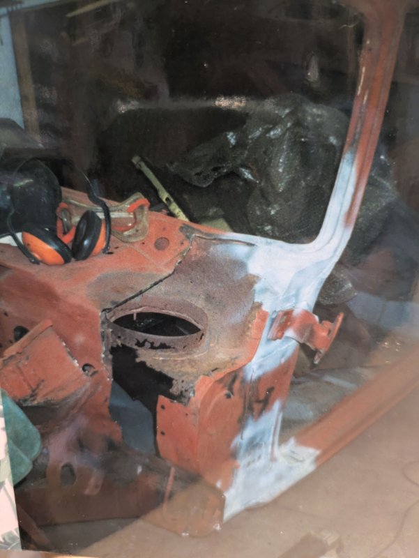

Posts: 5926
Whilst you are there check the upstands in the plenum that duct the air for the heater are not rotted away, they stop the water running through the plenum and falling on your feet inside.
I had to cut the top of my bulkhead off, fix it all up inside the put the top of the bulkhead back on. A camera inside should help to see what it is like.
Posts: 7183
That’s an interesting one, Matt. I’ll have a look and see what I can see today.
Posts: 5926
This shows what I mean, top corner of bulkhead cut away to access it.
plenum 2.jpg (68.19 KiB) Viewed 62 times
Plenum 1.jpg (81.81 KiB) Viewed 62 times
