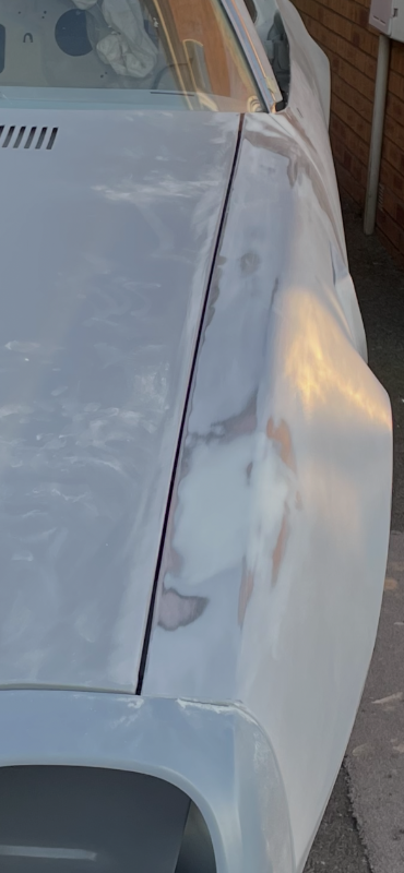

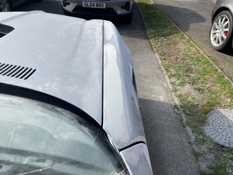

Well I’ve finally managed to fully align the front end metal,
Still got a few small tweaks to make but overall it’s pretty sharp,
I’m currently about 6 months behind schedule so looking very unlikely it’ll be done this year,
Ces’t la vie
Ces’t la vie

Re: My very last restoration!!!
Looks absolutely spot on....all that hard work was worth it.
better to have it right than have it on time mate. you always do it right so.....

Great job and well done
She looks GOOD
She looks GOOD

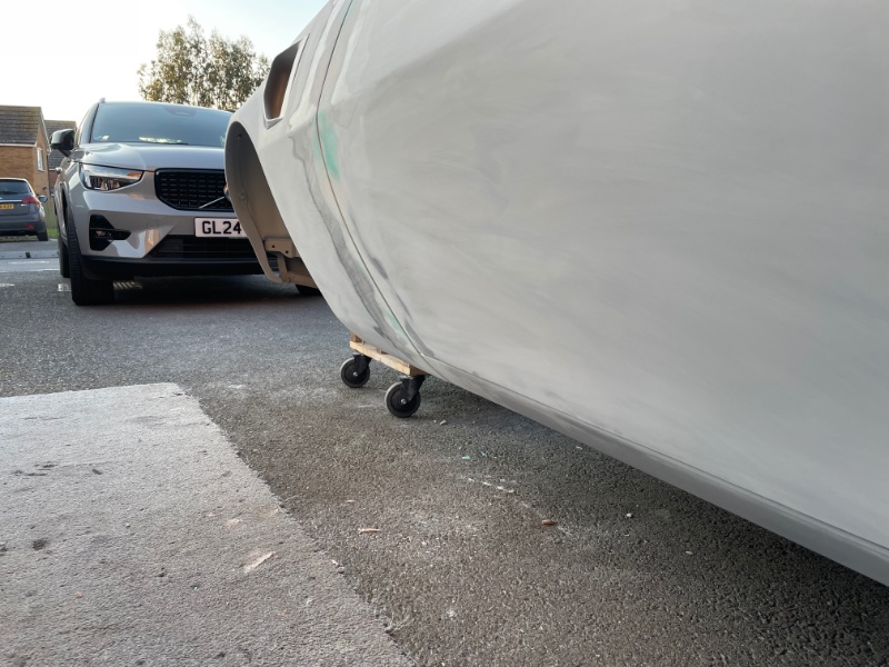

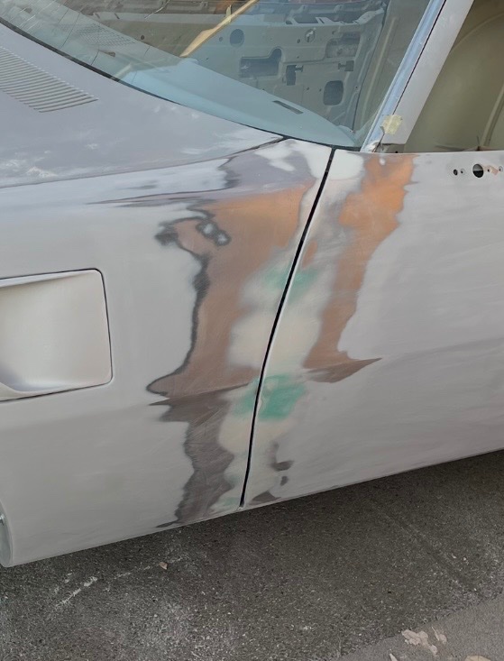

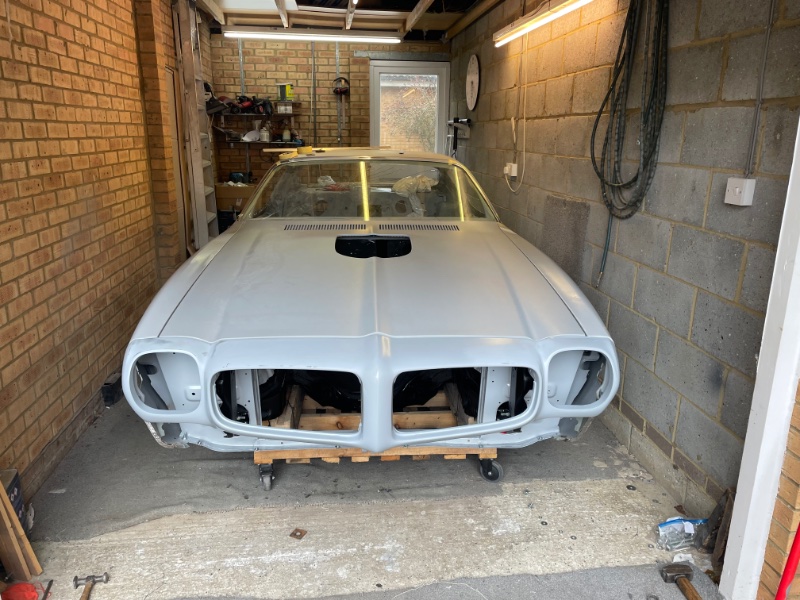

Virtually finished the gapping now , just the nose panel to finish off, this is being a right pain, stripped it twice and twice it’s moved and cracked after about a month?
Tried two different epoxy’s neither worked,
I’ve been trying to follow guidelines from the US but obviously I can’t get the particular type of epoxy recommended, so thought sod it and try the old way,

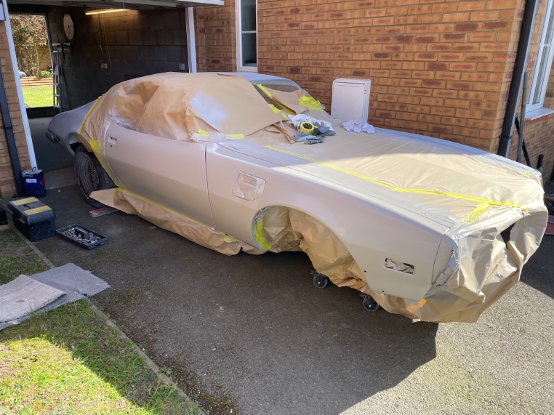

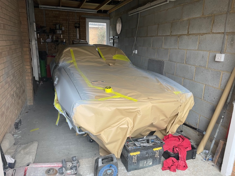

So following a good old blocking session last Saturday I’ve actually now started the primer stage,
I’m trying out a new twist on 2k this is apparently a hybrid 2k and has some kind of epoxy additive so it dries with a proper sheen,
I guess in a decent workshop one probably would appreciate the shine as it highlights wobbly bits a tad better,
However it flats lovely dry long blocking with 240
Is fairly easy going,
