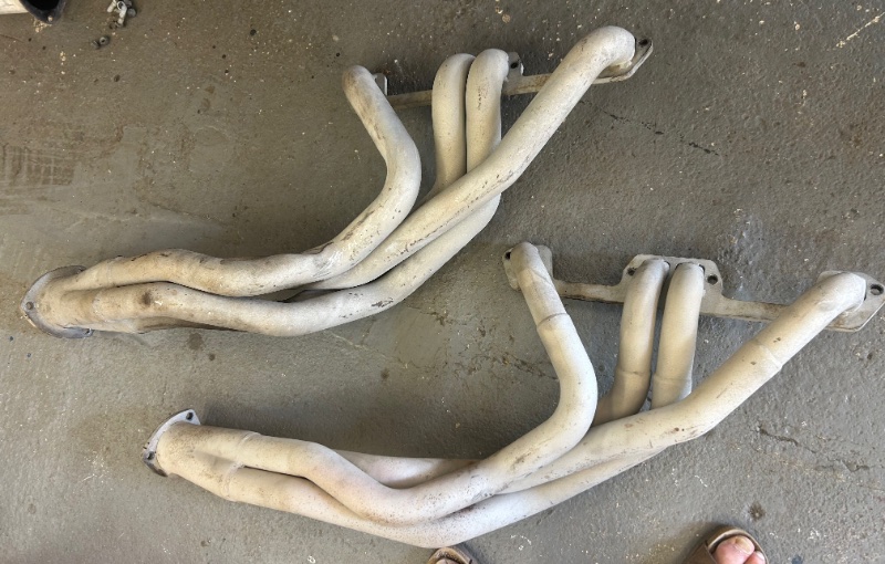

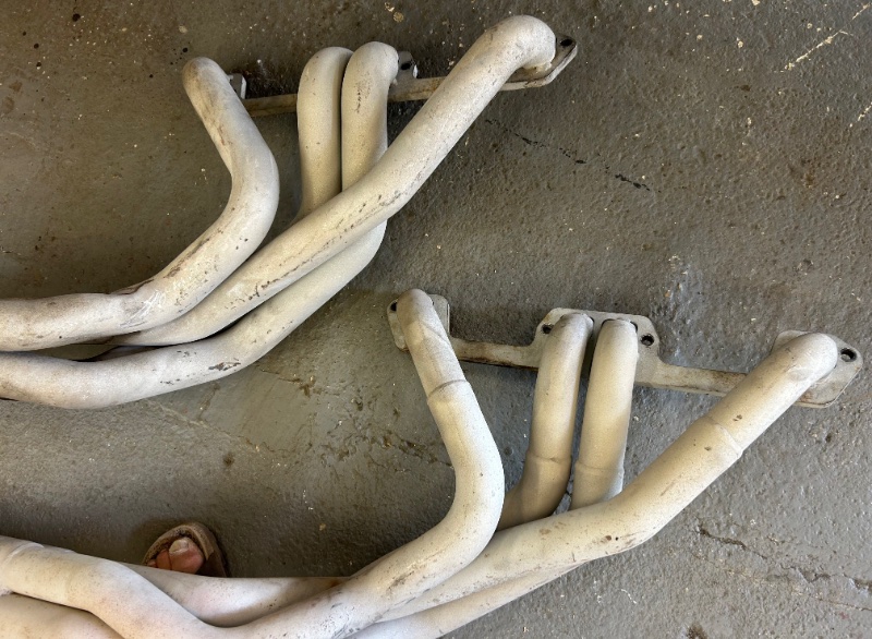

In the search for just a bit more out of the current combination, I’ve borrowed some race headers for the Euronats. My street headers are 1-5/8” stepping up to 1-3/4” with a 3” collector, the race headers are 1-7/8” all the way to 3-1/2” collectors. Hopefully they’ll be more efficient at taking out the trash..
