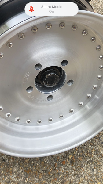

I'm running Autodrags on my cuda - 10x 15 rears with 325 x50x 15s on the rear. The springs have been "inboarded" though. The centre of the hub is 1" thick. The wheel nut pictured I'm using is 1 and half inch long and I'm using a flat washer. The nut is stamped 1/2-20 LH. I got them form North Hants tyres who are very helpful and carry stock. I think my front street wheels (also autodrags are 8x15. Hope this helps

redneck75 how did you get on with this ?
The problem you’re having is that the “Classic Line” ones that Northants sell are not Centerlines, they are copies , hence why the call them “Classic Line” , even though they do have Center line written on the front
Genuine Centerline Auto Drag all have 0.75” lug nut hole depth where as these classic line ones have 1.75” so the factory studs are not long enough, also genuine Centerlines don’t have the same backspacing as those classic line ones and there are subtle differences in the looks of them , they look decent enough though
Not sure why they made these copy ones with such a deep lug nut hole
I did buy some myself but sent them back as I didn’t want to change my studs to longer ones as I want the option of going back to steelies with dog dish caps in the future
I did think about getting the longer shank wheel nuts that they sell but even with those I don’t think they would be long enough but let me know how you got round it ?
The 2.0 Centerlines they sell in the states have the correct 0.75” hole like the old ones but shipping is quite expensive so if anyone has any Centerlines for sale over here please let me know
