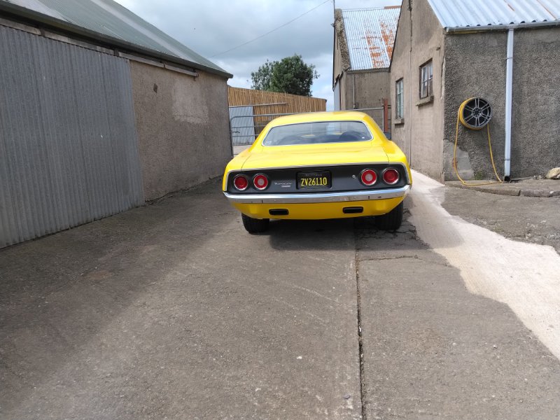

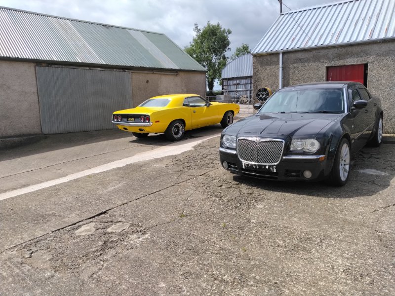

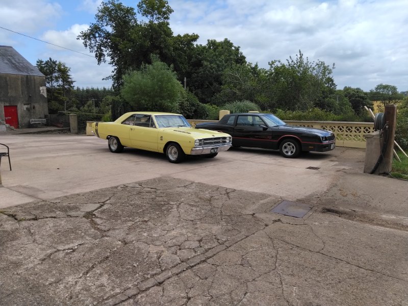

Well finally got the dart over to my mates. 70 miles away with only left front brake. Left early to avoid traffic. Will be removing gearbox and will put a more factory clutch in. The dual friction centre force is too heavy for me now. Any recommendations for a factory clutch? 340ci manual 4 speed. I believe rockauto aren't shipping to UK now. Will be a while though, couple booked in before me. The barracuda needs a lot of work. Pics attached.
