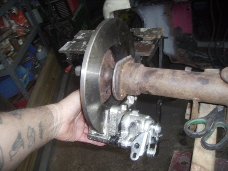

Post by mygasser »
after tidying the garage today we put the viva magnum axle up on the bench to start mocking up parts for the disc conversion. the discs fit perfectly which was a good start. the calipers look like they'll need to hang under the disc to get the handbrake cables pointing in a sensible direction but they won't care where they are, lol. it all came to a stop when we found the pads were wrong, doh! so we'll be ordering the other much less common type. it is what it is and won't stop us getting on with mounting the calipers to the axle though, it's just a nuisance.

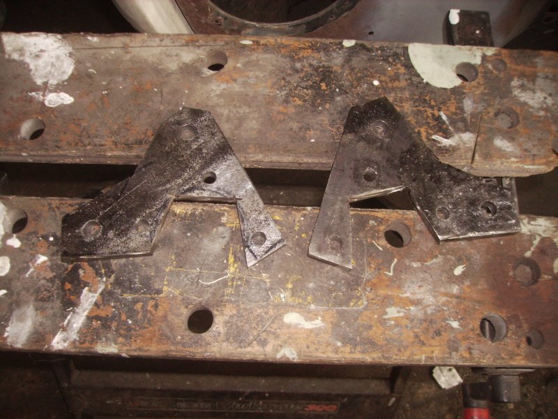

Post by mygasser »
today we got some more done on the rear disc conversion. we first made a pair of ally shims to go where the drum backplates used to go between the axle ends and bearing retainer plates (see pic). then we slid a caliper carrier over the disc on some soft ally strips to keep it central. then with the caliper bolted to the carrier and in the rotationally correct position we made a card template. these are now partially cut from 10mm steel plate with their holes all drilled. more tomorrow? :-k
