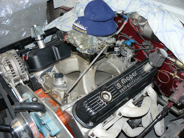

Inlet back on tonight. What a twat of a job!
No rubber end gaskets so a big fat bead of black rtv at each end and I'm re-using the paper gaskets so a skim of sealant on those too, also to stick 'em in place!
Of course I lower the inlet gently into place and it's trying to push the gaskets down.
Then the bolt holes don't quite line up.
Then you can only get a spanner on most of the bolts with about 1/8th of a turn of room.
Then some of them bottom out as they're slightly different lengths and I've got them mixed up.
Then I dig out the torque settings for an ally manifold, which seems to be 25-30lb.
Then realise I can't even get the damn torque wrench on 8 out of 12 bolts so that was pointless... :?
Anyway, they're precisely hand torqued to: as-tight-as-I-can-get-with-a-3/8-spanner-until-my-hand-really-hurts.
I'm now on the cider...

Great to see you back working on the car Paul.
Bet you forgot about how much fun they can be ???

Looking good Paul, almost identical to what mine looked like cept for the covers and small tube headers ;)
