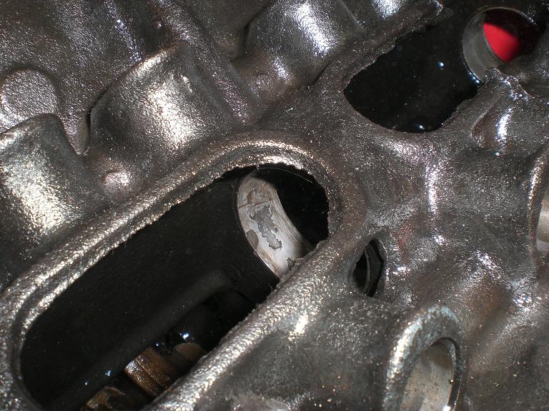

I started to rebuild the engine today after i picked up all the parts i need from real steel this morning and when i went to install the new cam this is what i found on cam bearing no 4.
This has set me back as i was hoping to finish rebuilding the engine this weekend. Now i either have to put into a machine shop to have the bearing replace or do the job myself if i can find the tools required to do it.

Dropped the block to the machine shop this morning to have the cam bearings replaced and should get it back tomorrow and with a few late nights I should have it ready for Saturday to go back in the car.
Gringo
Post by Gringo »
ANTON wrote:Dropped the block to the machine shop this morning to have the cam bearings replaced and should get it back tomorrow and with a few late nights I should have it ready for Saturday to go back in the car.
I hope you dropped the cam off as well. When the machine shop did mine, the bearings weren't fitted quite right. The cam wouldn't spin! :roll:
If they've got the cam, they can trial fit and make sure everything turns as it should. :thumbright:

I did give them the cam to test fit and ease if needed.

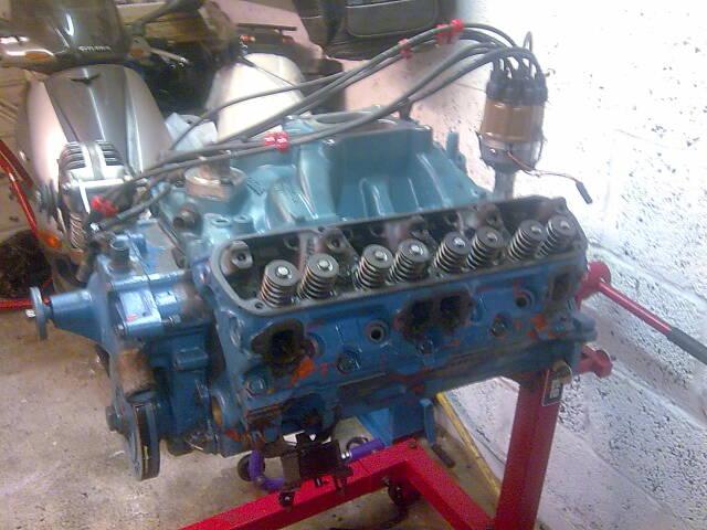

Image010 (Small).jpg (51.76 KiB) Viewed 1829 times

It took 21/2 hours to get this far and It should be done tonight and ready for paint. All that is left to do is fit the oil pump and the sump.
You don't hang about do ya,looking forward to seeing the completed engine,with new paint.

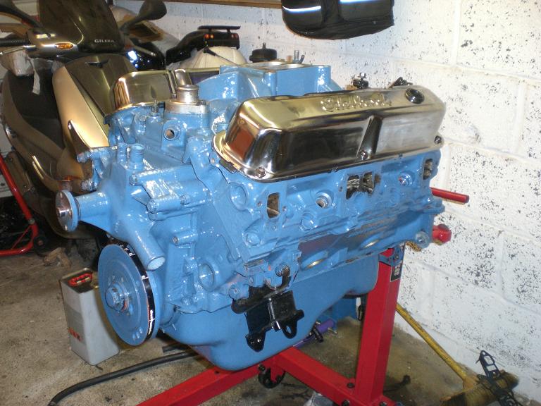

Finished re-assembly last night and put the first coat of paint on last night. Tonight I'll fit the new leads, fit dip stick tube and tie up any loose ends and then refit the engine tomorrow.

Chancer
Looking good Anton would you like to run it in in my truck :D
Looking very smart Anton, very smart indeed :thumbright:
Scrape off all the paint on the damper that the crank pulley will sit against. If you have paint between the pulley and the damper you run the risk of vibrations from the pully not seating 100% flat.
Been there made that mistake before. ;)
