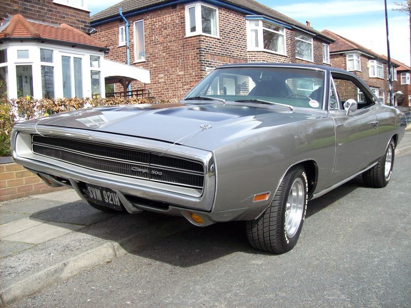

Love the new wheels Si :thumbright:
Posts: 4295
I like the ride height. I've been thinking about nudging mine up a bit. When the rear end is out this winter I might bring it up a snadge...
Good work.

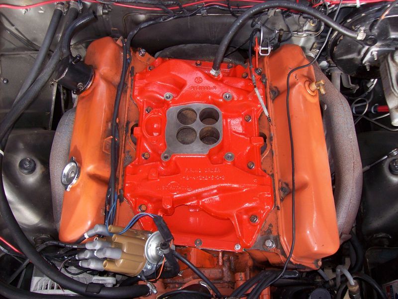

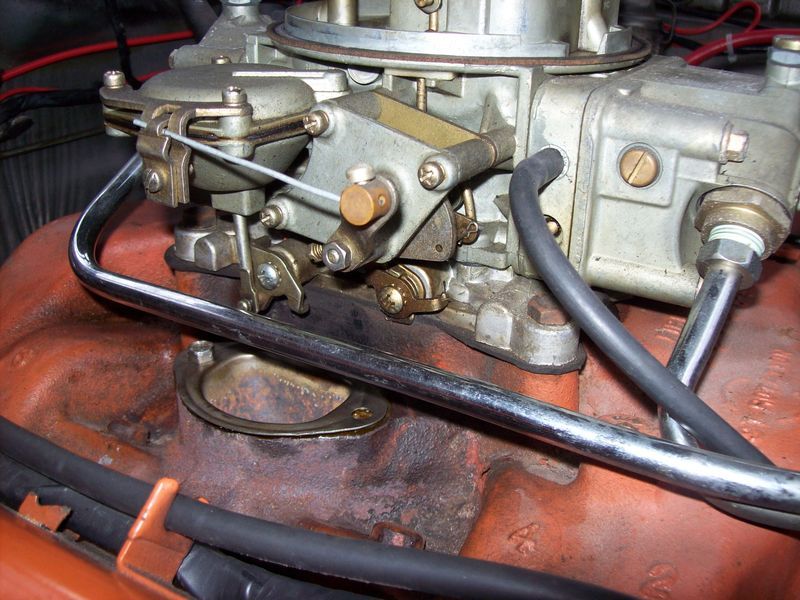

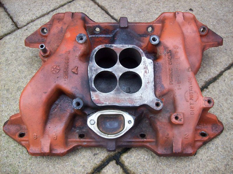

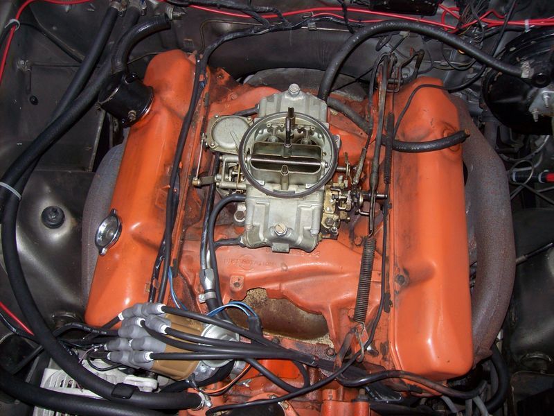

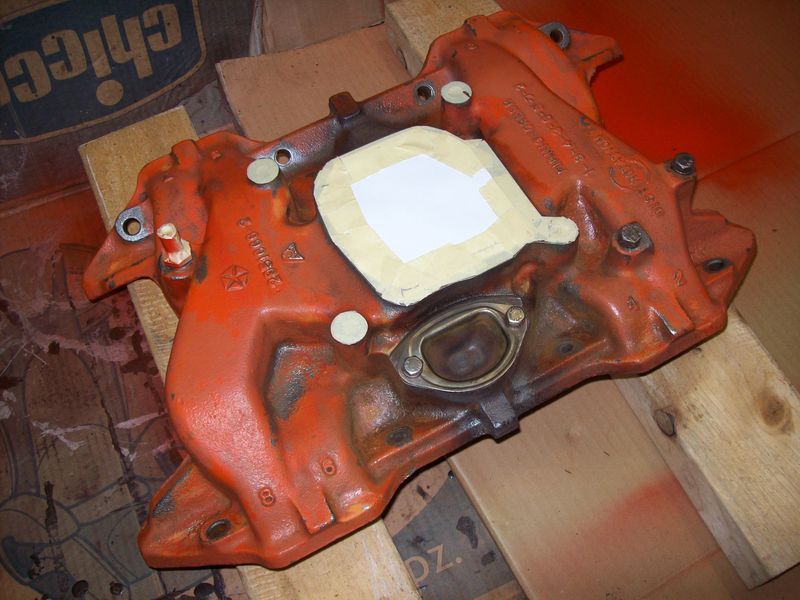

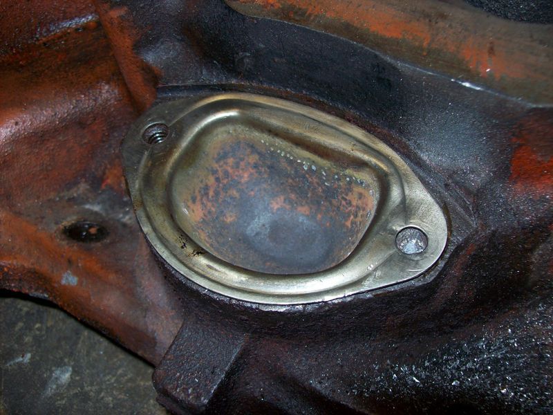

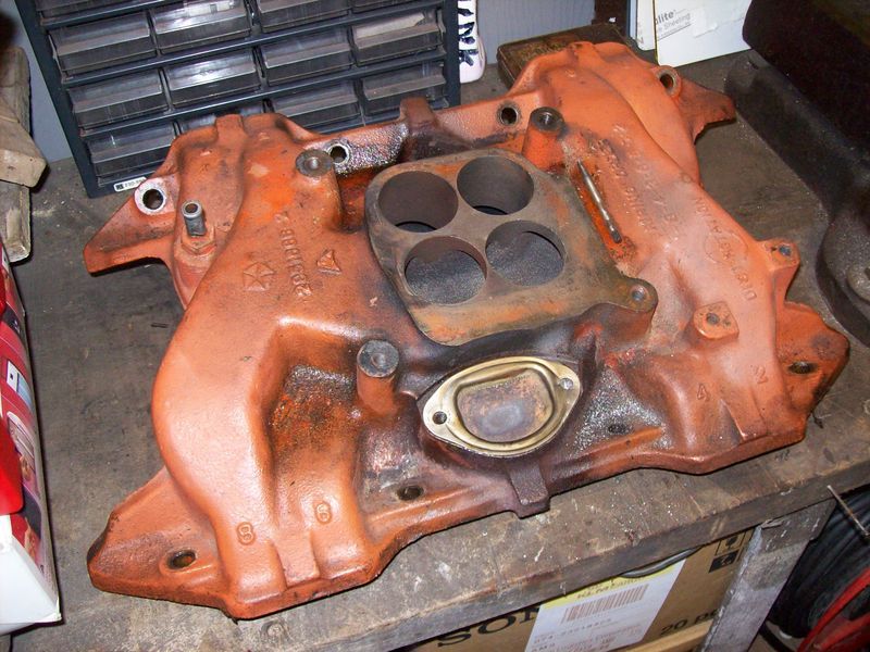

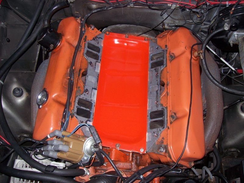

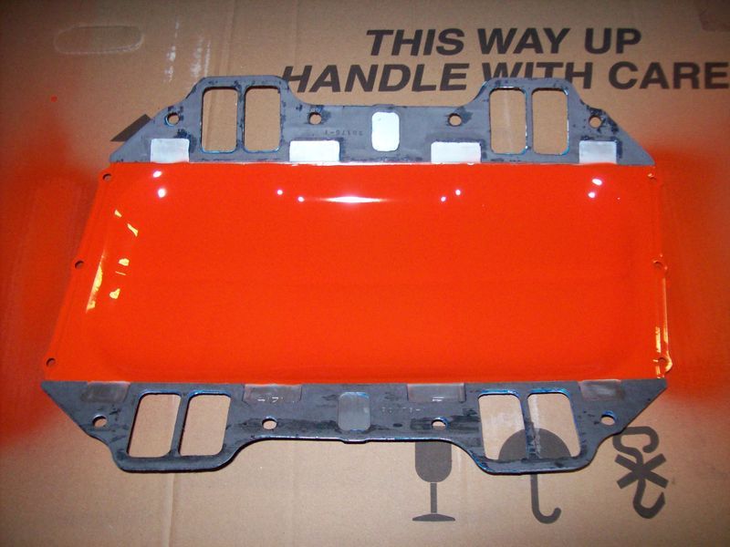

Heat riser block off
In an attempt to improve hot starting I wanted to replace the valley pan gasket to block off the exhaust passage
Evidence of burnt paint either side of the carb suggested the passage was open
The heat control valve in the right side exhaust manifold was long gone

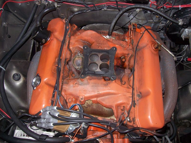

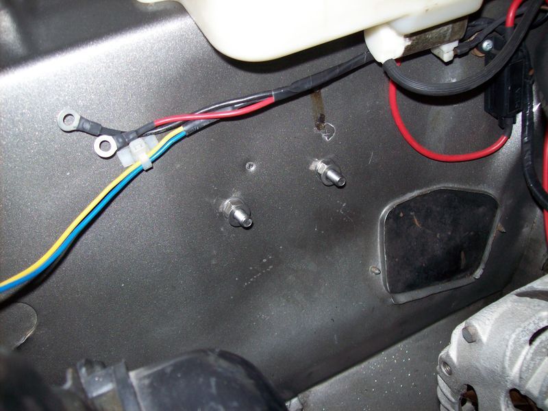

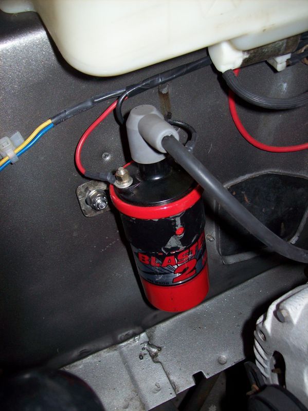

I started out by relocating the coil to a vertical position on the inner fender
And prepared the new valley pan gasket

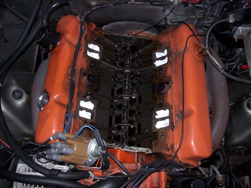

Posts: 5254

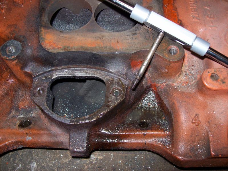

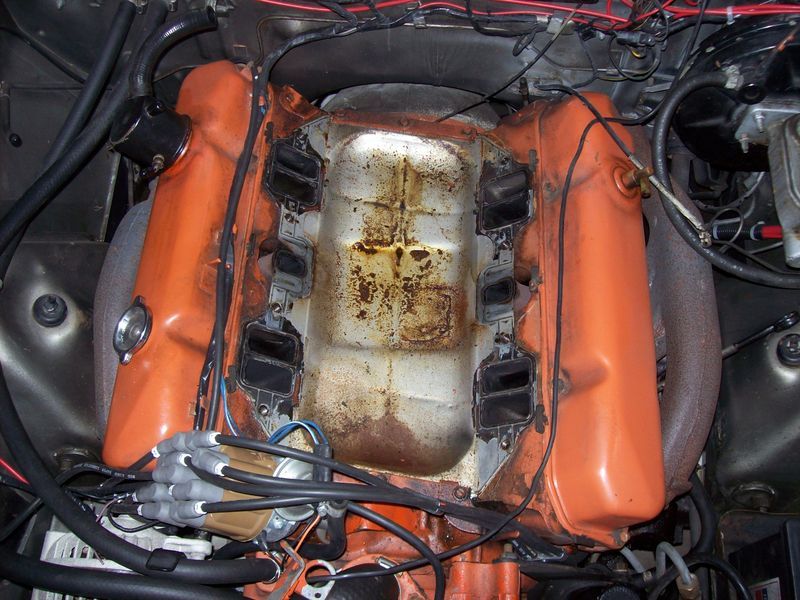

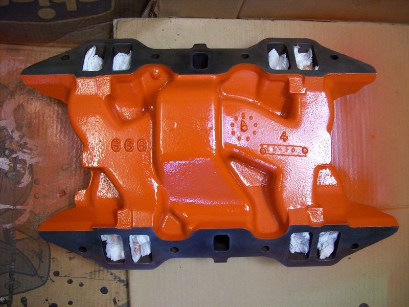

Off with the intake

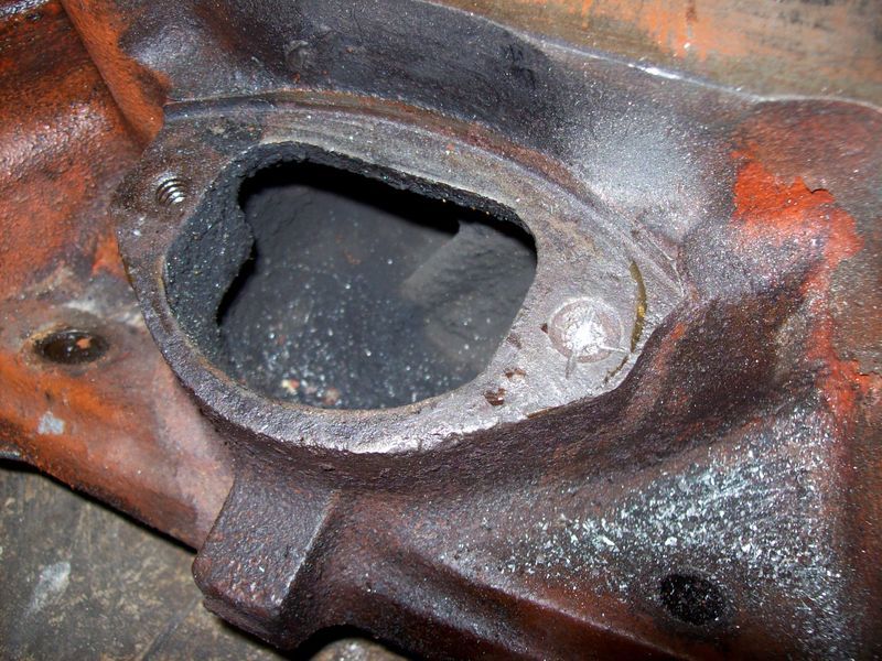

Removed broken thread from choke well cover plate

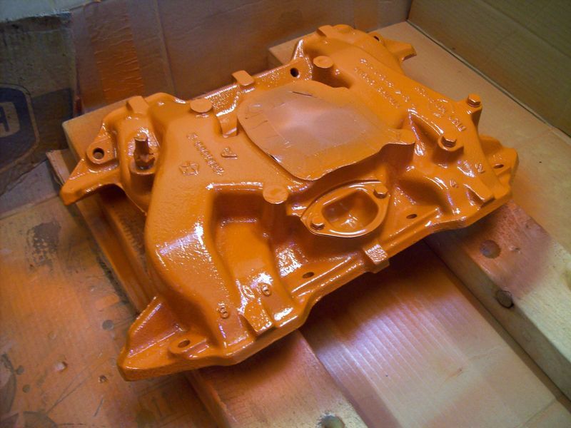

Posts: 5254

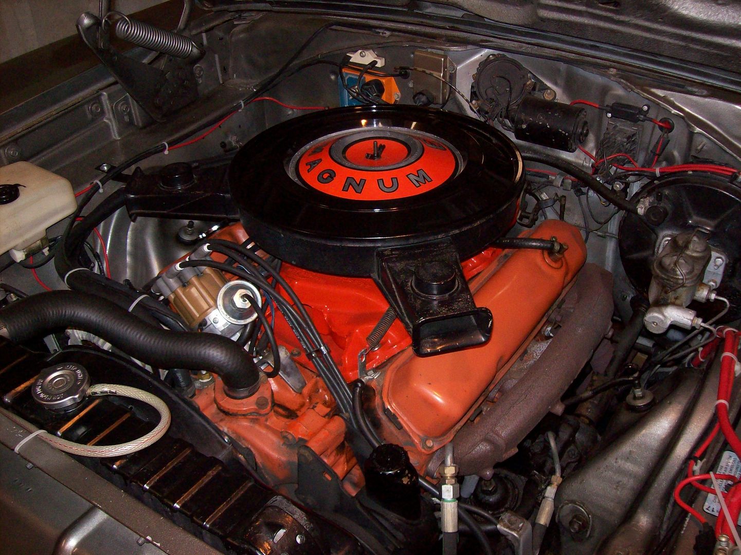

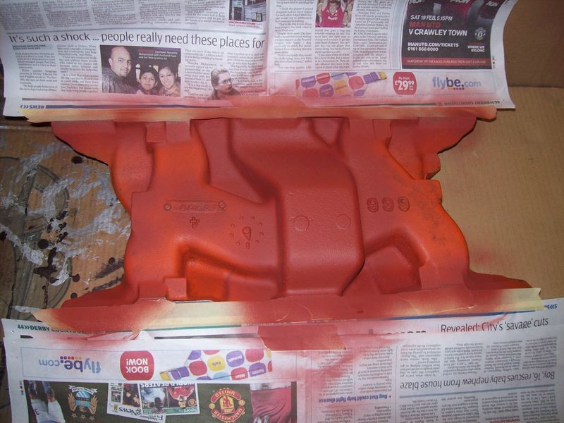

Prep for paint
Put everything back

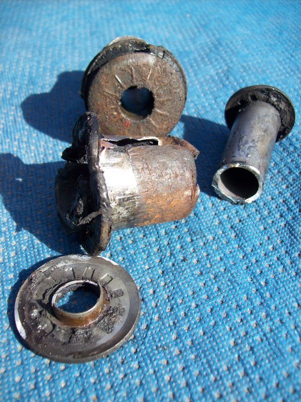

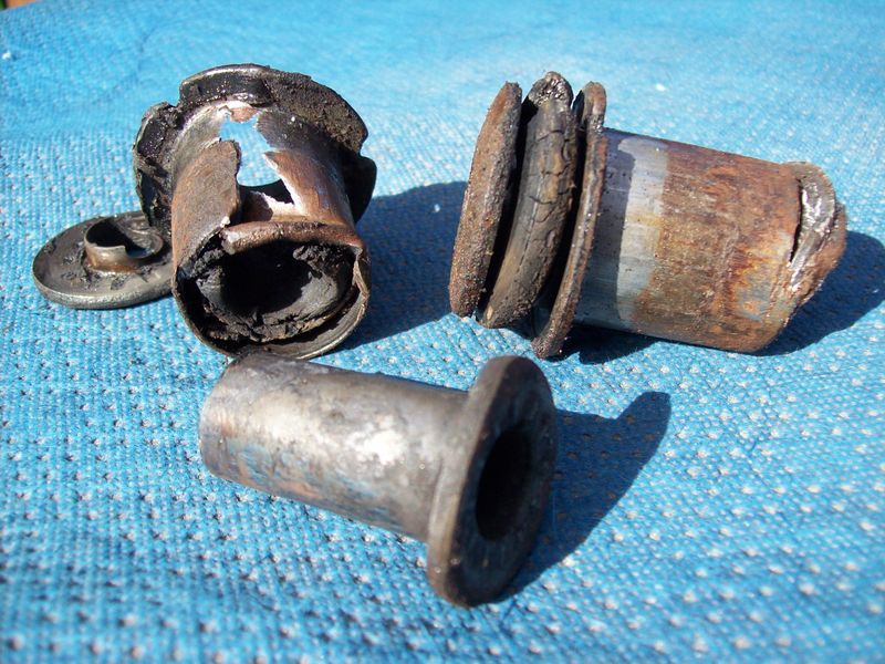

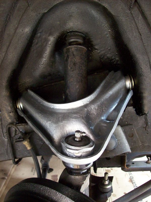

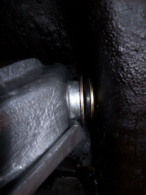

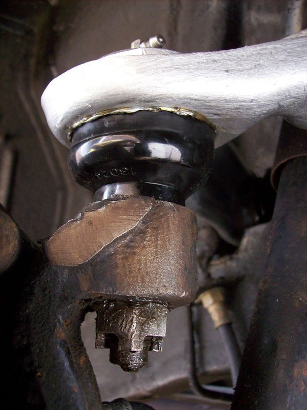

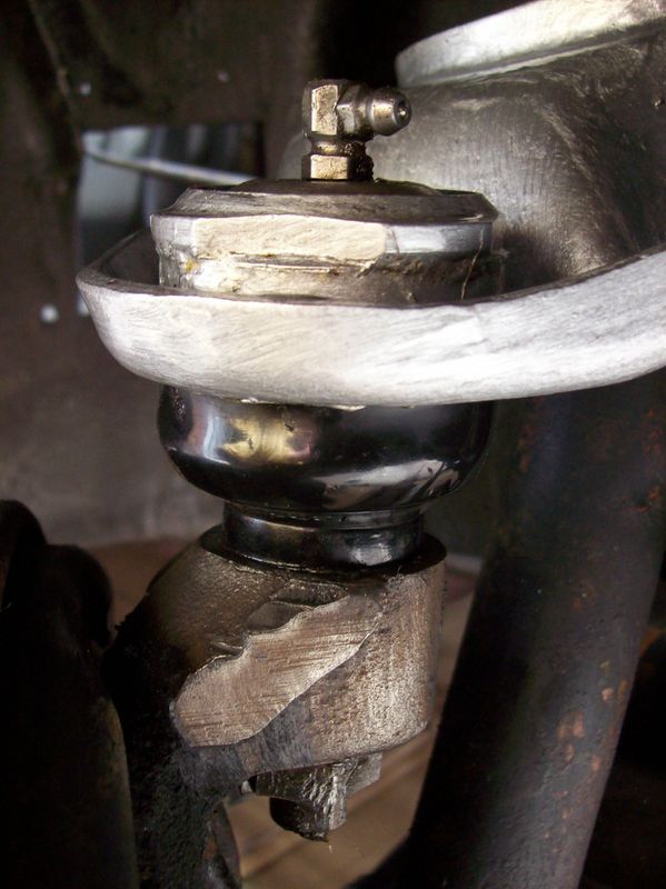

Next up was upper control arm bushes
The old ones were quite buggered, but they came out relatively easy with a selection of tubes, sockets and a big vice
In with the new

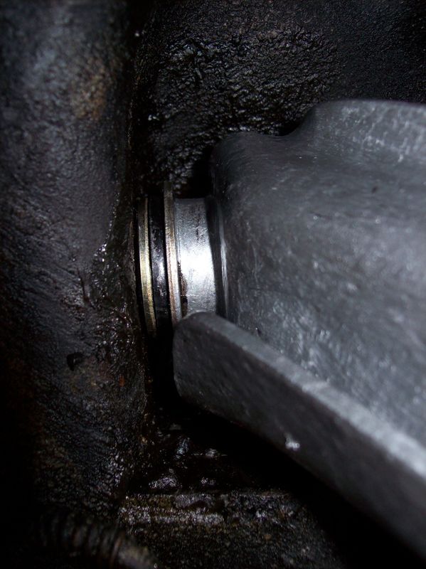

Posts: 5254

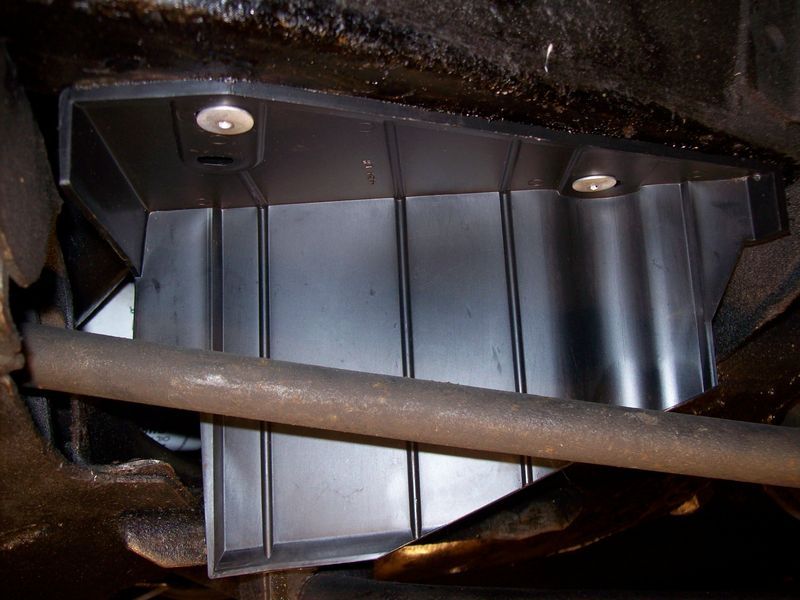

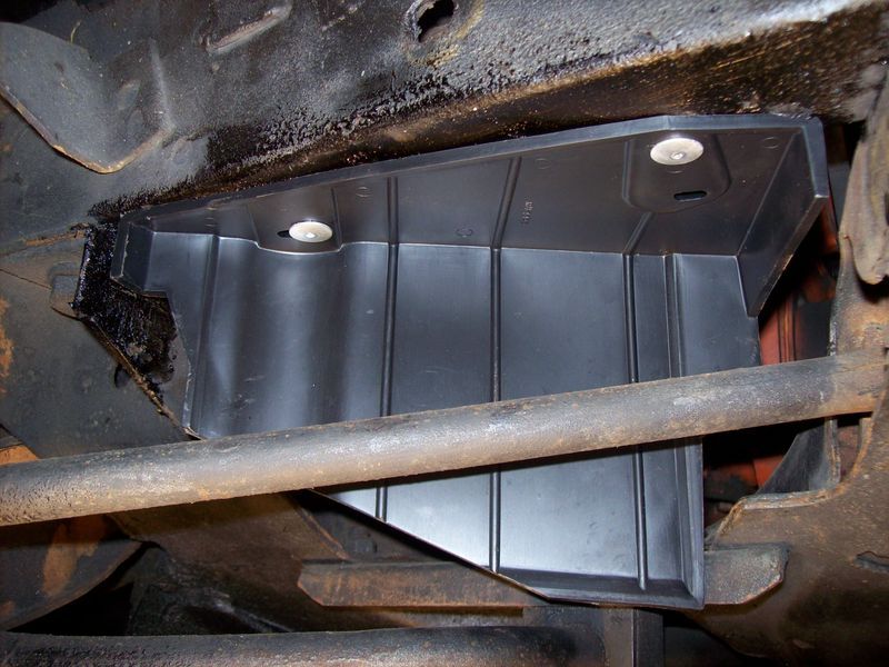

Can't remember what these are called, some sort of splash shield fills the gap where the lower control arm strut passes through to the K frame
ready for another summer

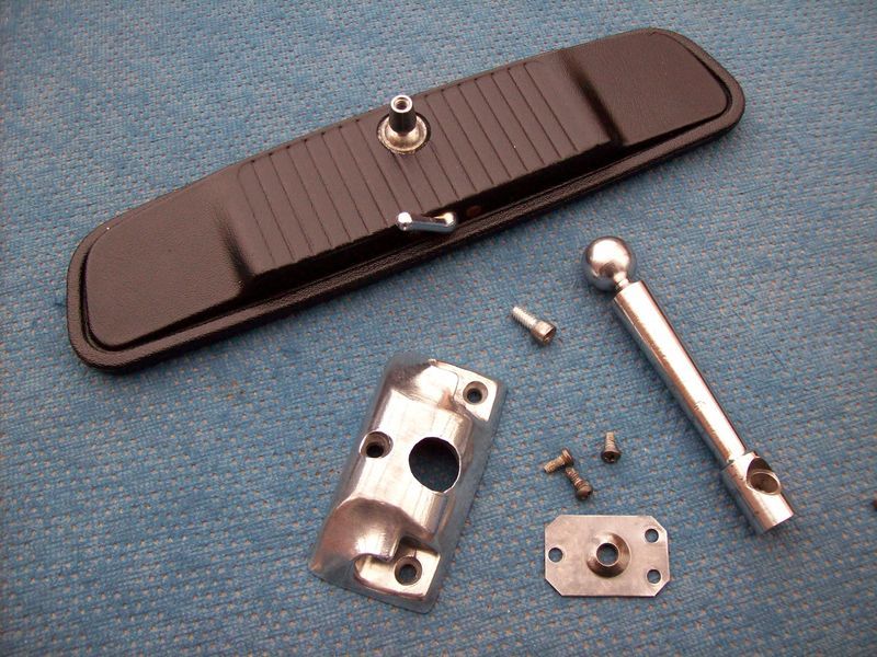

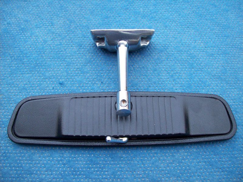

Seems a bit lame on the ‘work in progress’ front

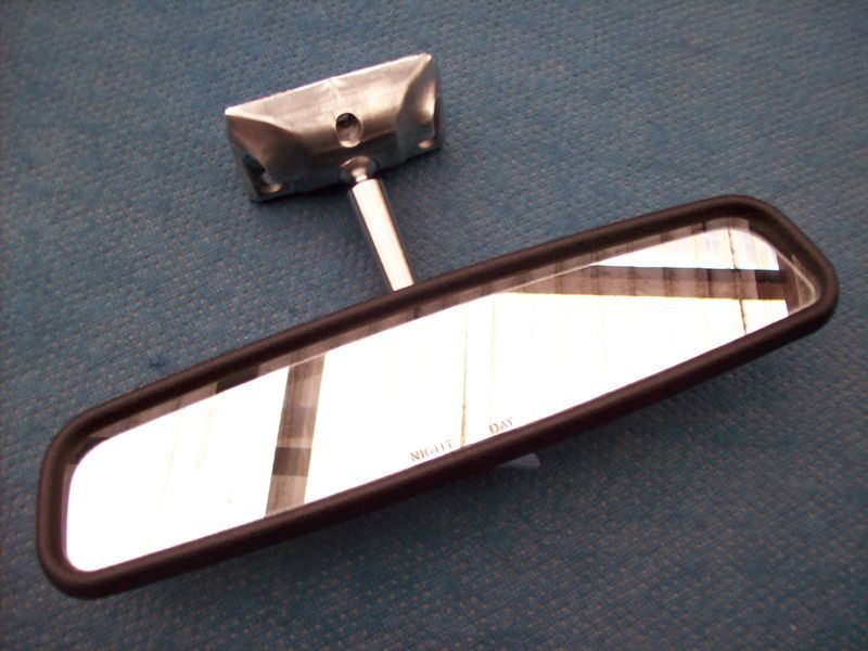

But I was quite pleased with the rejuvenated shiny bits on the rear view mirror …

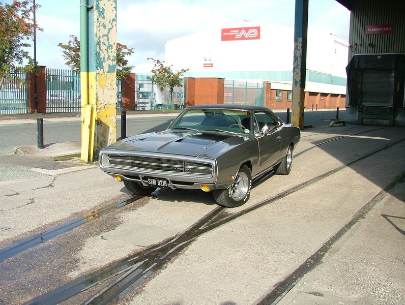

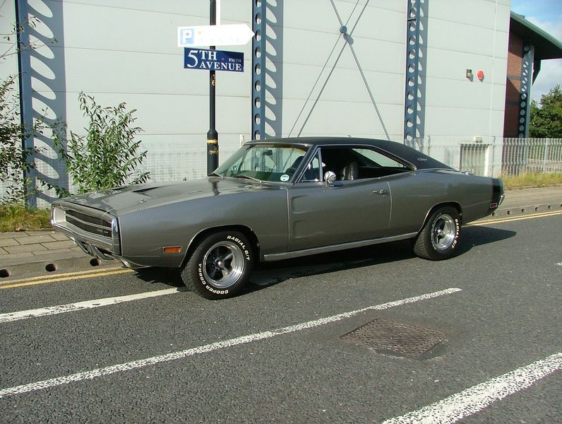

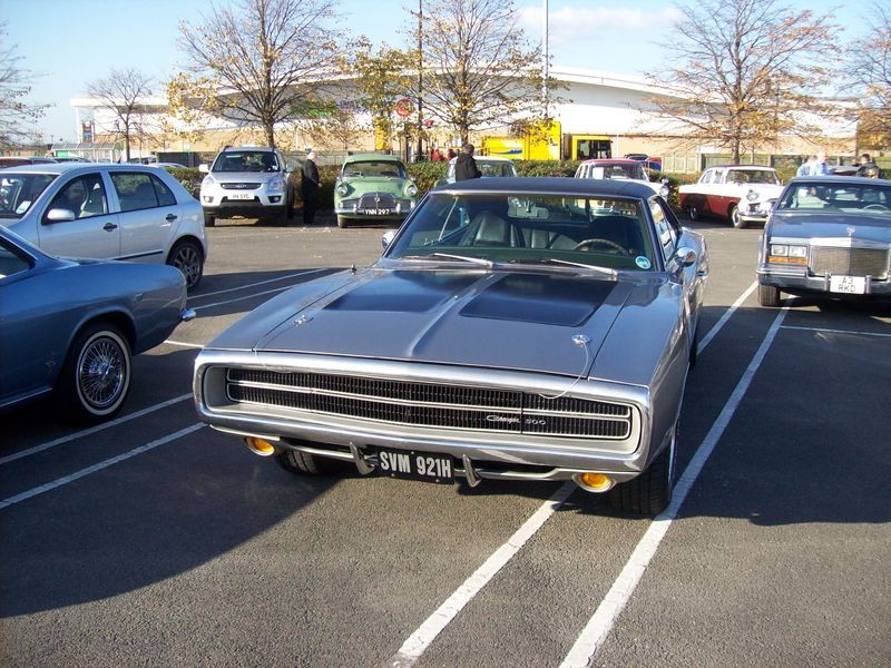

Some photos in Trafford Park …
68 beeper
Posts: 473
Joined: Tue Jul 23, 13 12:28 pm
Location: Christchurch dorset
Post by 68 beeper »
Very nice :thumbright:
Posts: 7149
Great photos Si! :thumbright:
I love this Charger.
Not the norm , and suits it well.
Cheers :thumbright:
steveo
Posts: 3920
Location: Kent
Post by steveo »
charger looks good , liking picture 7 8-) :thumbright:
