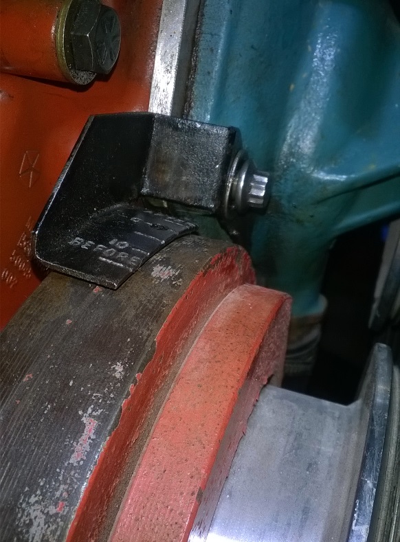

So I reckon I've found the latest oil leak...A loose water pump bolt!

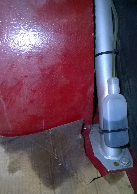

My axle is still puking oil out into the catch tank. I'm sure the level is low if anything so I dunno what's going on there.
I'll re-check and if it ain't over filled I'll fit a bigger catch tank ;)
Oh and I need new front shocks- one is leaking pretty badly :?
Axle catch tank.jpg (208.01 KiB) Viewed 2497 times
Latest oil leak.jpg (204.26 KiB) Viewed 2497 times

Axle breather blocked?
1965 Belvedere 2 426 Wedge.
Posts: 8369
It's been blowing for a long time. When I couldn't cure it I replaced the breather with a bayonet fitting and ran a pipe to a catch bottle in the trunk. It's still blowing...

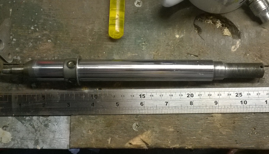

So, current front strut plan is to have new shock rods made by my engineer mate Terry. He's going to make them 2" longer and I'll fit longer springs to give me a bit more scope with ride height adjustment. They'll need to be sent off for hard chroming once he's carved them out.
If it's going to take ages, I can throw it back together with the old rods until the new ones are done.
Shock rod.jpg (231.22 KiB) Viewed 2396 times

the axle catch tank needs to be above the axle and the pipe going into the bottom with breather holes at the top. the oil will then syphon back into the axle.
Posts: 8369
Close Pete but it won't fit my struts. I scoured every catalogue everywhere and found nothing, including Strange.

Thanks Boz I'll redesign it.
