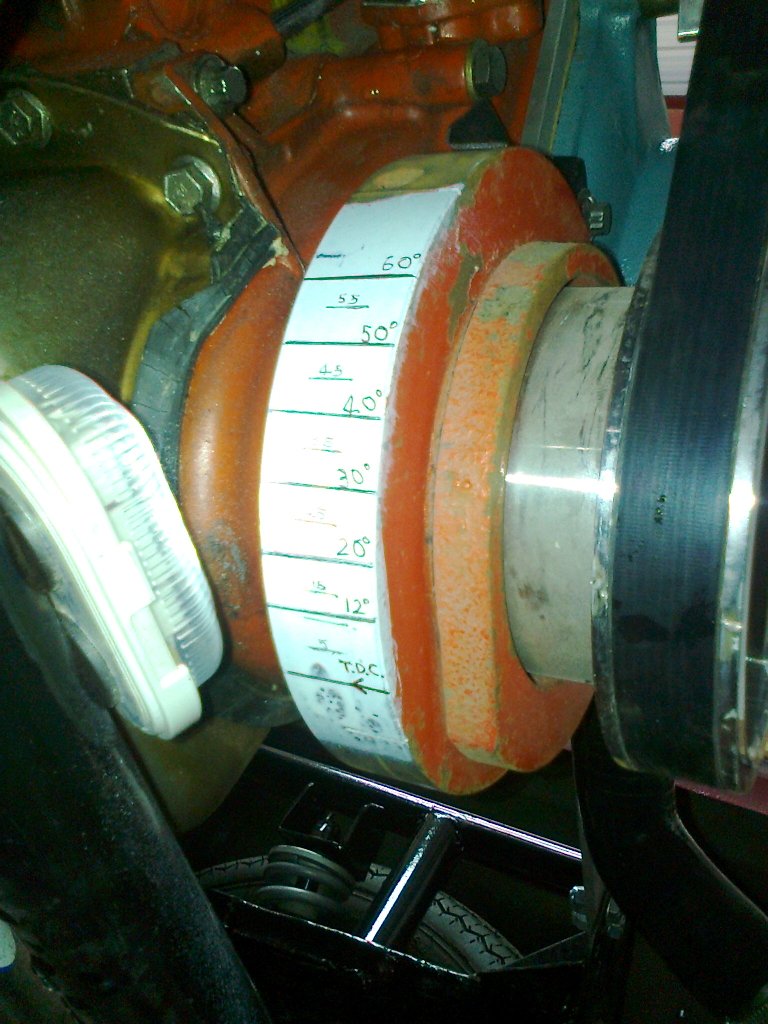

db wrote:Surely all i need to do is measure the approx damper cirumference.
Cut an arc out of card with 0* to say, 60* marked on it in maybe 5* increments.
Find exact TDC with a piston-stop.
Hold this against my damper and transfer the marks onto the damper with white paint.
Or wait for Ade to fix his fancy-ass timing light ;)
Fancy -ass timing light is now fixed & available for collection :lol:

Meanwhile... who needs timing tape and fancy-ass timing lights?
Just some white gloss spray, a tape measure, a calculator and a black marker pen. Sorted :D

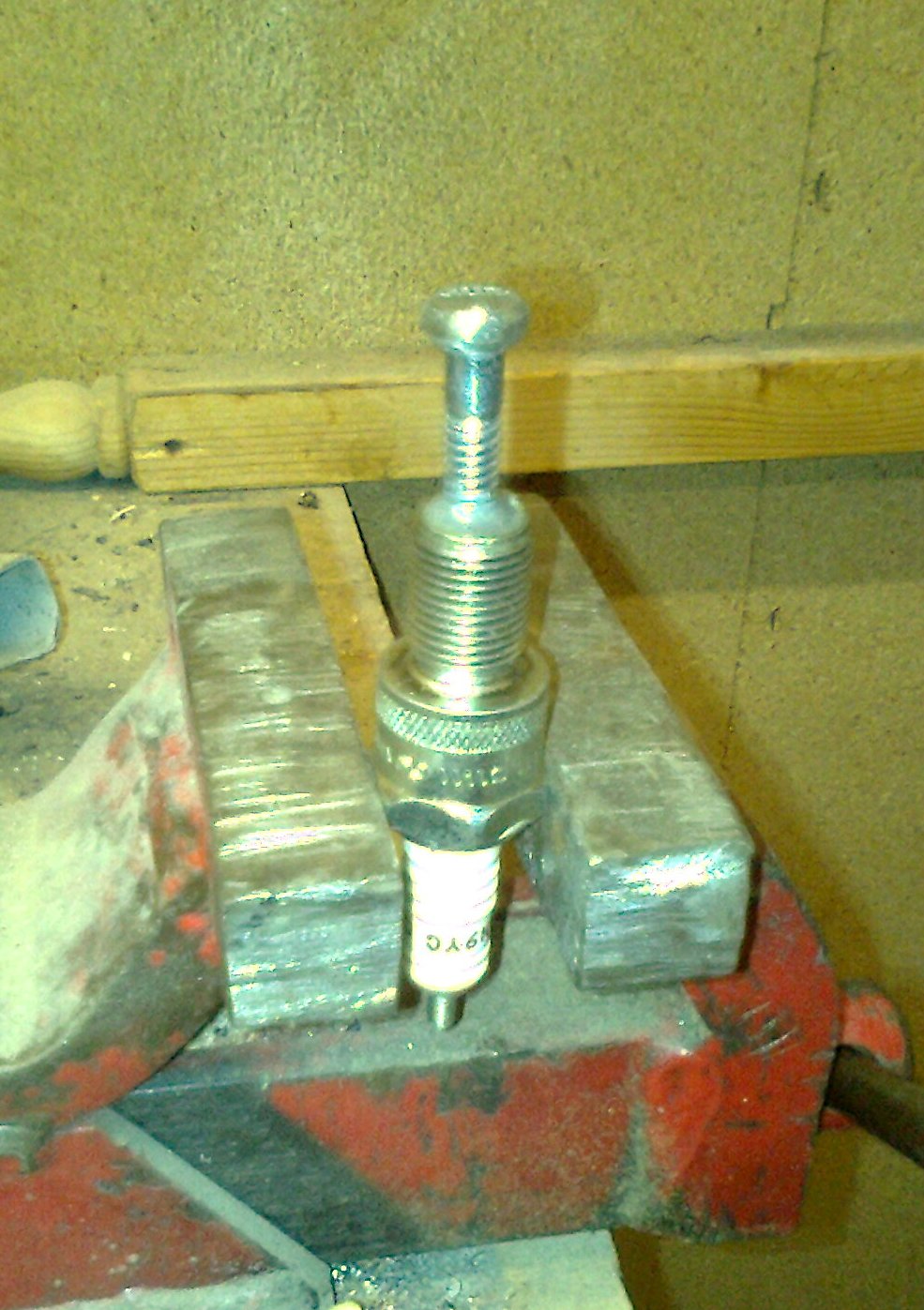

We also have here a d.i.y. piston-stop. I broke the centre electrode out of an old plug. I rounded-off a 7/16 bolt with a grinder and Araldited it in the hole. Did the job perfectly.
