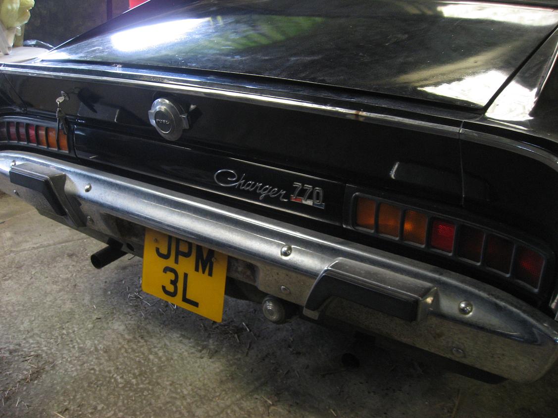

Interesting chassis no. facts there Matt - might need to try and persuade DVLA that it should be free tax in due course. Wonder if it's possible to get official confirmation of build dates?
I was told it was an official export car so that seems to tally. Cursory examination in dark barn failed to yield the build plate, but the number stamped on the driver's side inner wing goes 6H29 (which makes sense)674SOA579...
Anyone got a Fijian Charger 8-) ?

i think that reg no is on a lads car in crewe area it was a m5 bmw his name is RANDAL RAN5L

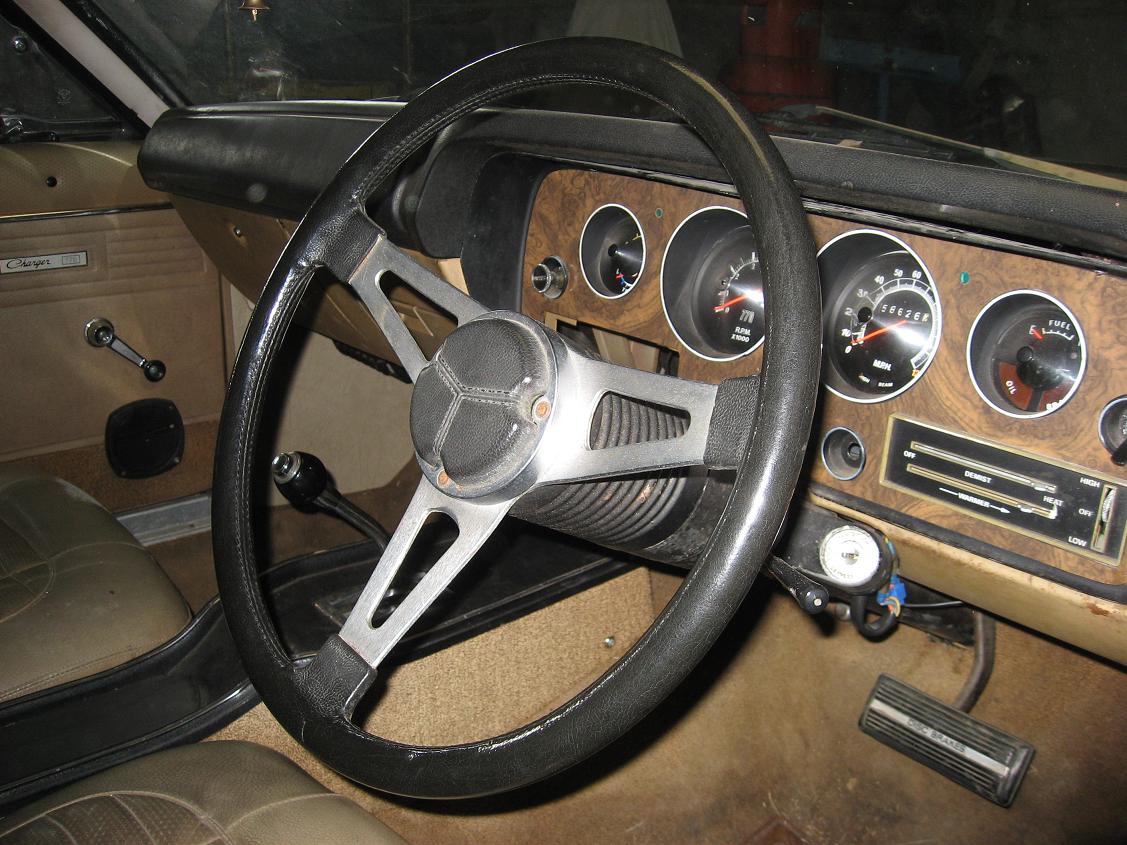

I think you do have the akward ignition switch
NICE interior mate
thet steering wheel is worth 800 Bux to the right australian :thumbright:
looks like you are missing your D/Lights switch
a spare could be summond up from the shed

daward wrote:Interesting chassis no. facts there Matt - might need to try and persuade DVLA that it should be free tax in due course. Wonder if it's possible to get official confirmation of build dates?
Dave, I am the DVLA authorised club official. I write them a letter detailing your car and it's date of build from VIN etc, and DVLA will modify your V5 to be Historic , saving you £215 per year in road tax.
They are usually pretty good, and the chassis number tells you the bulk of what they need to know. I just explain it to them in laymans terms.
A small charge for the letter goes into club funds.
