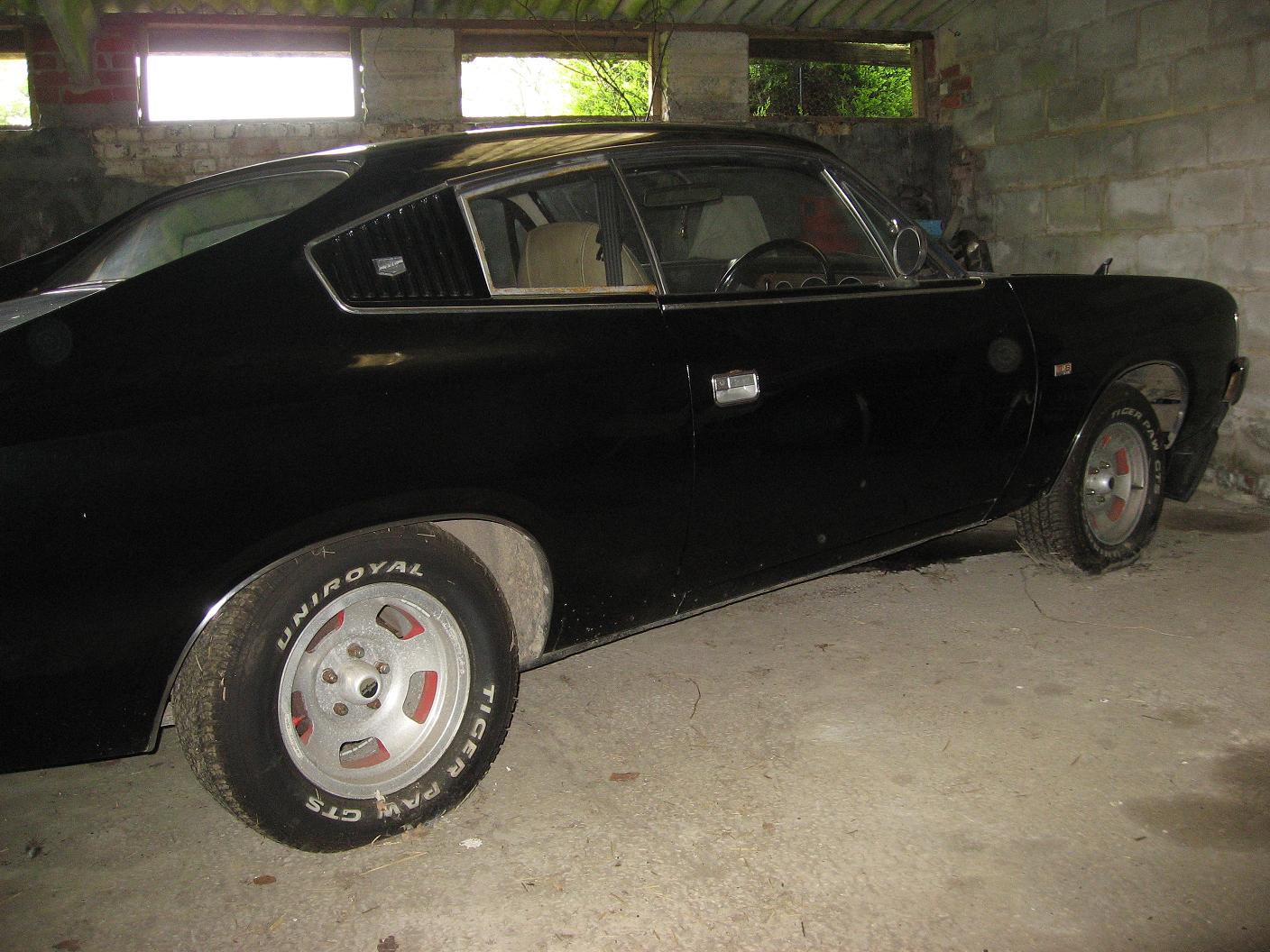

A new Charger arrival. Myself and 2 mates have just bought a Valiant Charger 770 - currently more than a little sad, without engine, averagely resprayed and needing serious TLC.
I was living in Melbourne as a car mad kid in the early 70s so the Bathurst Chargers, 351GTHOs and Toranas left a real strong impression. Done plenty of things with cars and bikes over the years but never scratched the growing muscle car itch. So when a biking mate of mine mentioned that he knew of this Charger needing reviving a deal was swiftly done.
I've been doing plenty of homework but there's still a lot to learn, which I guess is where you guys hopefully come in.
I've been told it was one of a small number (?10) that were officially imported in '73. It seems to be a VH and is badged 770 318. Reg plate is JPM 3L. The original engine is gone (cracked block) and the vendor had sourced another cooking 318 but that has not been fitted. The original colour looks like a metallic type mid blue, but it has a tired black respray. Interior is beige, complete but pretty tired.
It doesn't seem to have a chassis no. plate under the bonnet, only a number stamped into the inner driver's side wing. DVLA have the chassis no. as VH6H29674. The digits don't seem to quite tally with the codes on the Valiant websites... I guess it must be a '72 car as it was registered at import in the UK in '73. The headlights look a little different to most of the pics of VH cars so I'm slightly confused.

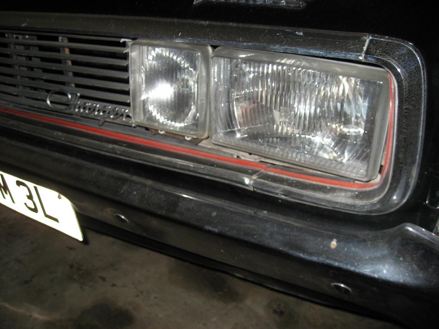

Early thoughts are a proper restoration - something that looks a bit like an R/T but with a hot V8 and decent running gear, capable of some track work/tarmac historic rallies etc but OK for regular use as well. Seems not too difficult to source a 360 motor here, a 340 (more desirable maybe with the E55 thing) seems more difficult. I guess a lot of the other bits will need to come from Australia but I have been impressed at what seems to be available over there - just need to sort the shipping...
All thoughts welcome regaqrding plans. Anybody know anymore about the official UK import story? Might be able to get it recognised as a '72 car with the benefit of historic tax? I apologise in advance for what I supect will be a lot of questions (some dumb...) over the next few months

hi matey
i think your front end is home grown the inner lamps look like
vauxhall vx 4/90 circa 74ish
the outers are also wrong yours should have austin allegro lamps .....

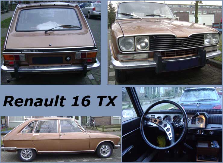

I think the inner lamps look like they are from a Renault 16TX to me. Good luck with the car. I'm sure Dave999 will be along soon to sort you out.

Wheels may be factory fit, I have the same on mine, code W35 on the fender tag on the bulkhead.
I would be very interested to see the car as the VIN has SOA on it, which is Special Order Accepted.
The only R/T auto ever built was SOA so there might be something special on it.

Its definitely a VH 770, as Duncan says it should have the allegro/hunter front lights and inner spot lights like mine. The grille surround is correct, but the grille itself looks to be from something else.
Dave 999 has a spare grille, but it may still be a little mis shaped and full of fruit and bits of oasis from his filming antics last year.

yes wrong lights and grill cut to fit
the wheels are Wolfrace UK made slot mags these came in 14 and 15 inch if they are 15 inch you will have a much easier time getting tyres
your grill is correct for a 770 but has been trimmed to fit the inner lights in.
i have some grill parts so when you get round to doing the lights we can see whats there that might be of use

any VH valiant grill will do. all they did in the factory was cut off the bars for the inner lights with a pair of shears

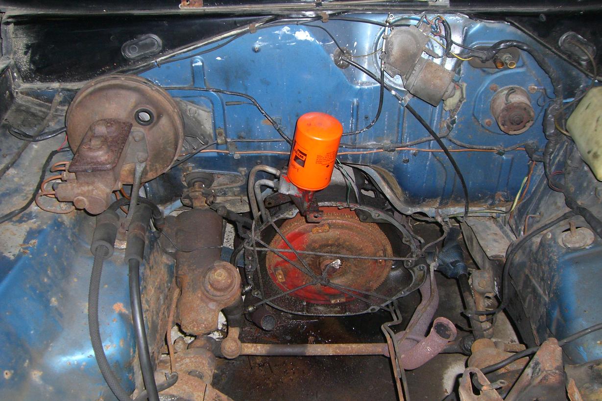

Hopefully we will be able to start stripping the body soon, so could I try a few questions...
Assuming the blue in the engine bay is original any ideas what the colour is? Can I tell a paint code from the VIN?
Engine (originally a 318) - Thinking about a 360 as it's been suggested a 340 will be difficult to find? I gather engine mounts should not be a problem going from 318 to 360? If it is a Magnum 360 is that still OK?
Headers - any UK based options, or do they have to be imported (or fabricated)?
Transmission - can the unit in the car be uprated to cope with what I hope will be at least 400bhp? I have no experience of "manual valve" conversions - any thoughts on those? Am I stuck with a 3 speeder or is there a 4 speed option? How about a manual?
In general are things like suspension bushes and all the general ancillary bits available in the UK, or do I need to start working out how to get stuff here from Australia?

aussie colours were all Berger Paint mixes and its on the vin
the paint colours were aussie interpretations of the US high impact colours
i.e hemi orange is hemi orange
aussie hot mustard is Dodge butterscotch or Plymouth bahama yellow
panther pink nd Aussie magenta are an example that dosn't work very well
the aussie colour was truely brain damaging in the sun
believe any small block will bolt to your small block bellhousing 904
when it comes to 360s i get lost, magnum or not...but i guess as long as you can fuel it and ignite it no probs
your 904 can be uprated with parts from the US to survive a whole lot of abuse just depends how deep your pockets are
number of gents in the club can advise and a smaller number rebuild transmissions for fun, racing or its their buisness.
no UK headers as the US type that are the usual import to the Uk hit the steering box
suggest block huggers or a kit of parts from castleauto headers in Aus
for a cheap option or go the whole hog and spend a lot on PaceMaker headers from Oz
Roger in the club runs Monkfish performance importing stuff for modern holdens
check pedders.co.uk
he has a pedders suspension franchise who supply most things from 1970 onwards
lower balljoints are aussie specific. the angles on the tie rod link are different from US
pitman arms have the master spline in the aussie poistion
the idlers possibly swap
trac rod ends may as well just stick with aussie or you will have to cut back the sleave on one of the track rods to get enough adjustment
all the bushes are same as US up the front provided you can work out which model to get.
steering boxes are saginaw design in a RHD case most all parts swap over US to Aus and vice versa unless thay are handed..ballnut and worm screw parts are only handed in relation to the teeth on the ballnut. if its appropriate the ballnut can be put on backwards to make a LHD ballnut and screw RHD
rear end had two different sizes of spring eye bush
its worth sending dimensions
trans mounts are the same as the late 60s US A body one
motor mounts are the flat buiscuit type, if they fit a first year 360 in the US 1971 ???? then they will fit an ausie one
later round spool type mount weird stuff wasn't used in Aus
your car will have pin slider girlock disk calipers like those on a 66 mustang and VG VH valiants
or it may have had a swap to later VJ design sliders with a clip and half head thicknass bolt holding the caliper sliding head onto the bracket.
both look the same from the under side
take off a wheel and see if there are clips or pins before ordering pads
or swap to landcruiser calipers....do a search and you will find me chuntering on to nobody in particular about the conversion
DBA and PBR make disks and drums and pedders of course can supply stuff but not sure who makes all of it
the rear wheel cylinders are kinda universal you just need one the right size and with the right mount
rear brake design is universal across all Mopars you just need bits the correct size.
rear axle is Aussie Borgwarner (60s/70s) BTR engineering (80s/90s Spice axle australia(2000-> today) M78
if you are lucky it will be a Cone LSD if not it will be an open version
open versions break easy cone versions good to about 300Ftlb in standard form...yes they can be rebuilt..
you can uprate it with the internals from a Mk111 camaro IROC Z or holden commodore VL to first version VS and custom 28 spline axles from moser they last surpsingly well and have much lower parsitic losses than 8 3/4 dana or 9 inch but obvioulsy much less robust
or add quaife tru trac style centre for a morgan aero 8....need to confirm this fits just not gone down to quaife with a standrd centre to check
Morgan used M75 7.5 inch and M78 7.75 inch BTR axles
I can help with axle advice or i will come and take your axle away if you go A body 8 3/4
your car could take a 727 small block box if you wanted to but not a US A-833 manual without floor surgery and hydraulic clutch or mangled combo of US and Aussie bellhousings.
