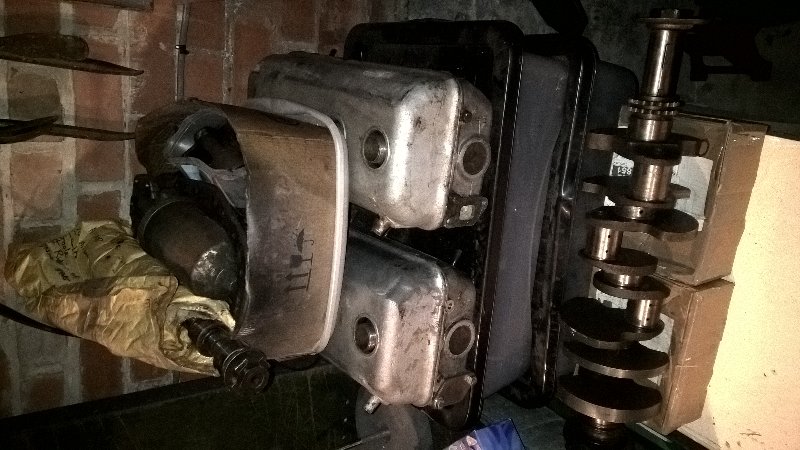

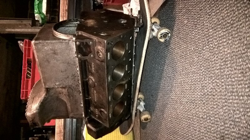

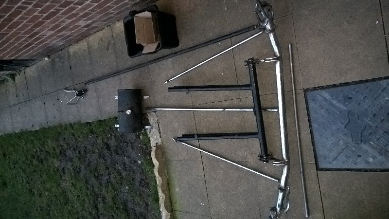

Well things are progressing! I'm gathering a nice little collection of parts already...
Re: Nostalgia blown Daimler Hemi slingshot
Looks like your gonna be busy Paul.
