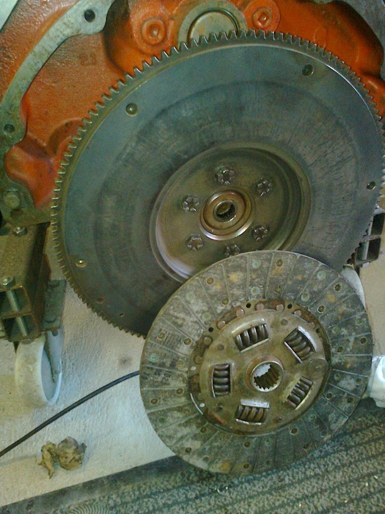

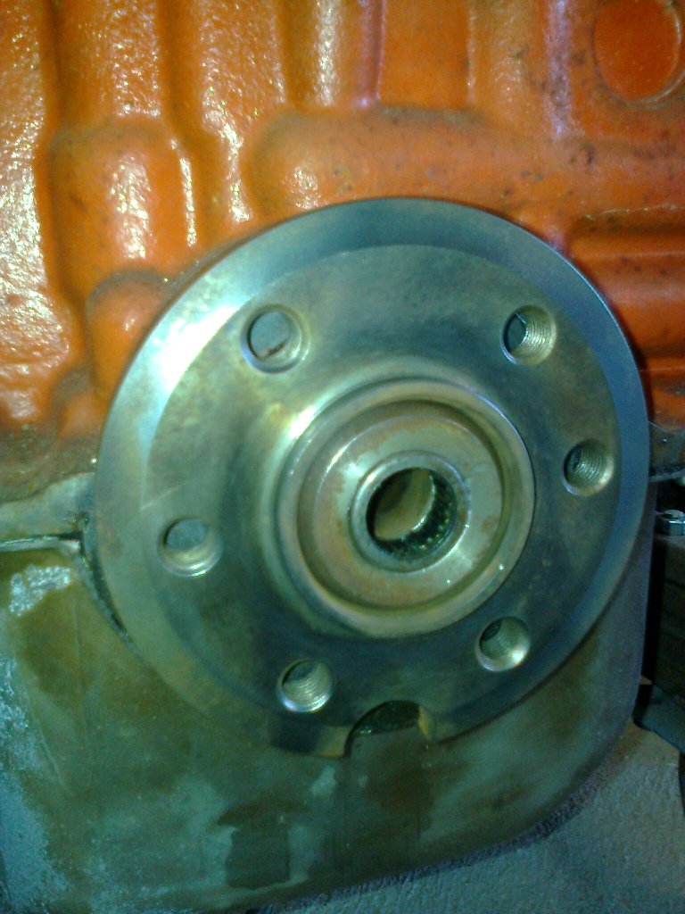

Today i had a good sort through the bits. I re-fitted the spacer and bearing in the crank, cleaned up and fitted the flywheel, clutch & basket. I aligned the clutch plate by measuring from the edge of the friction plate to the edge of the pressure plate at 6 points around their circumference. I might just slot the gearbox into place (without the bellhousing) to check alignment.

- Willow checking clutch bolts.jpg (173.09 KiB) Viewed 1567 times
- Flywheel on.jpg (165.8 KiB) Viewed 1567 times
- Crank spacer and bearing in.jpg (129.04 KiB) Viewed 1567 times

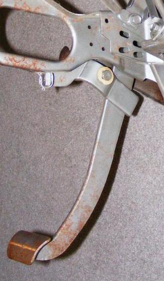

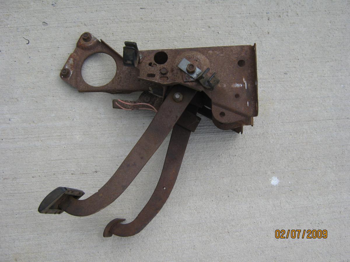

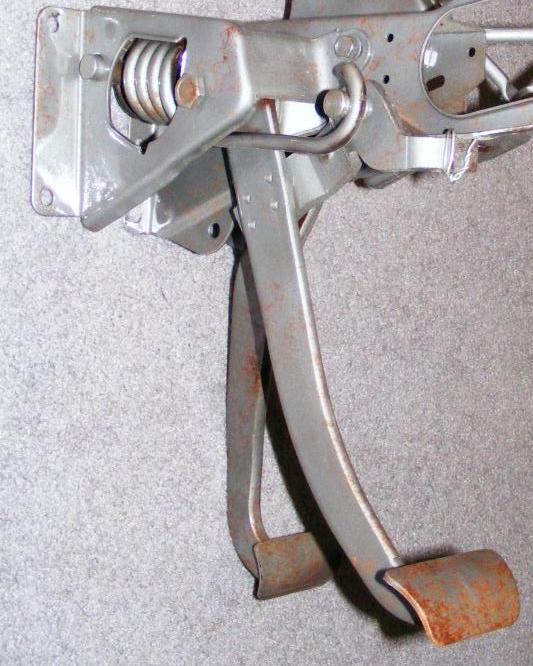

Well after a fruitless search for a clutch pedal i'm making my own
A good root through my box of treasure turned up a 2"x 1/2" i.d. steel tube- perfect size for the pivot
I also found a length of 2"x 3.8" bar, so i have all the ingredients.
The actual pedal is easy- no bends just cut to shape, drill for the tube and weld 'em together reasonably straight.
The lever bit will be trickier- it's a funny shape and bends all over the place. It's also the critical bit as the operating rod and over-centre spring pivot on it. I've a few photos off t'internet as a guide, so i'll do some careful measuring and guess-timating and make a pattern before committing it to steel.
If anyone has better pics or even a pedal i could borrow to copy...?
- 4-speed pedals rhs.jpg (146.22 KiB) Viewed 1317 times
- 4-speed pedal assembly B-body 07.jpg (65.61 KiB) Viewed 1317 times
- 4-speed pedal assembly B-body 06.jpg (34.36 KiB) Viewed 1317 times

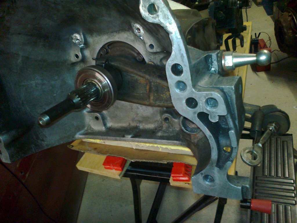

Thanks to Mick i now have the almost-impossible-to-find throwout bearing
AND gears!!! I actually got a real buzz today from banging through the gears for the first time
It's really easy to set up the rods and levers (once you have the right ones...) You just poke a screwy throught the holes in the 3 shifter arms,
Set each gear selector in neutral, adjust the rods til they fit and slam those gears in!
Tomorrow i can bolt the gearbox up to the motor, get the car up on stands and let the engine see the engine bay for the first time
