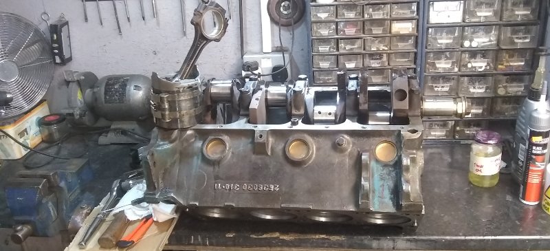

Well after the engine I got from the USA fell a part I decided to rebuild the Leeds bought engine.
With the patient on the table, I stripped and cleaned everything including a trip to the local jetwash with the sack
barrow. Crossing the road with a engine block on a sack barrow got some funny looks. " oh! You can pick up and carry these blocks, as I had to move it from one side of the garage to the other, but yep they are meaty. :roll:
I now know a lot more about these engines and I must say .I do quite like them, simple with a few quirky things. :thumbright:
Tuesday this week I started the engine up after the rebuild including' rings' new cam bearings' mains' and shells' sounded odd with a miss fire. :-k
Then after 10mins a squeak/ rub noise, I thought it had picked up a on a main, very odd noise couldn't put my finger on it ?? :scratch:
So yesterday after thinking about from 4:30am I was back in the garage at 7:55am inlet manifold off again, sump off.after finding nothing, no shiny bits in the sump. I noticed that number 8 exhaust valve cam lobe had a rub, Ide had a problem with this lifter not turning, so changed the lifter again for another no still no turny!!!!!
Cleaned it, polished it, was lovely in the guide, but still no turny!!!! Sat looking at it for 10/15 mins trying figurer it out . 8ollox seen it, when I washed the rockers and the shaft I thought I had put everything back right,
BUT NO! I had put the last two rocker arms the wrong way round. Meaning that the push rod was rubbing on the head, this was the strange sound and stopping the hydrollic tappet from rotating #-o
And once I put number 7 and 5 plug leads the right way round 8-[ sounds sweet now "HAPPY DAY'S
