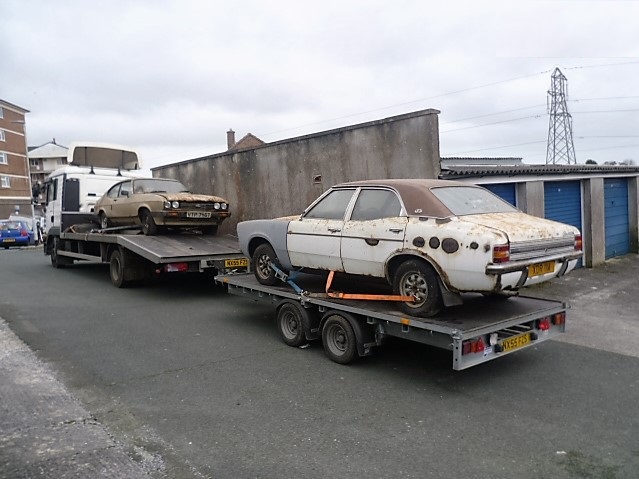

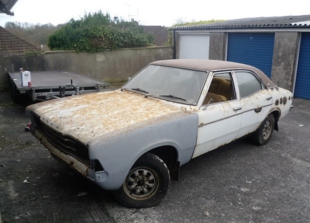

Here is the car as it is 1974 MK3 2000E
The car has been in hiding for 20 years, me and a friend rescued three cars in tolal the MK3 a capri and a sierra

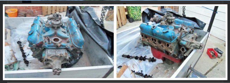

This is the lump I intend to use , 318la I acquired form Ebay as a box of bits. The chap I got it from had started to rebuild it 15 years ago so It came with some new parts oil pump fuel pump ect
