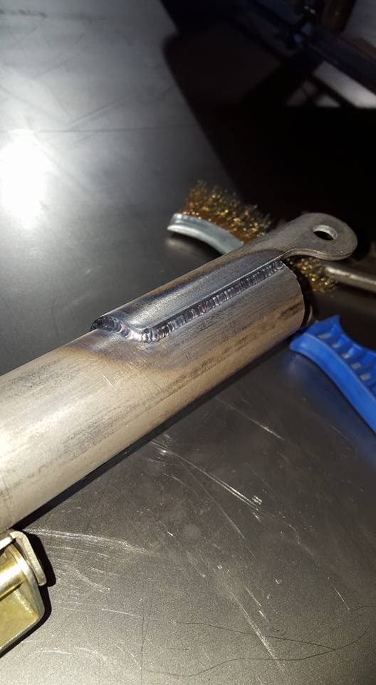

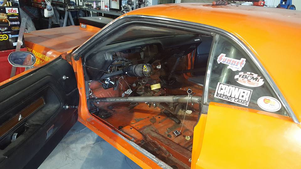

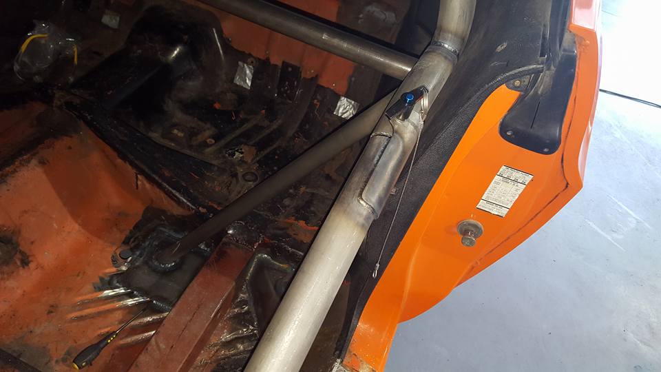

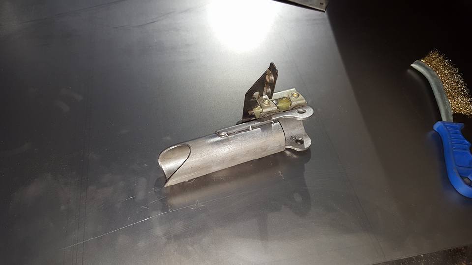

In terms of the cage, the final touches were the Swing-out Door bars.
The Challenger internal "door cards" (They are BIG plastic one-piece mouldings...) do intrude a lot so access to the door release and window winder are always a bit of a "Challenge"....
..Also as Julie may drive this car (she won't go near the Altered) I wanted to make it as user friendly as possible....
Pete worked his magic on the door bars accordingly...
Swing out Doorbar 2.jpg (56.07 KiB) Viewed 1783 times
Swing out Doorbar 1.jpg (78.03 KiB) Viewed 1783 times
Swing Out detail.jpg (52.78 KiB) Viewed 1783 times
Swing out Hinge.jpg (35.22 KiB) Viewed 1783 times

Pete.S
Posts: 415
Location: Cheshire
Post by Pete.S »
Your more than welcome Pete.
Was done in one hit on the front frame rail to cage connectors with no templates :)
But as blue says, once you have factored in bend start and end points/bend offsets/center line radius and bend rotation when you have more than one bend on a single tube its a total brain ache, but does get easier as the years go on....
