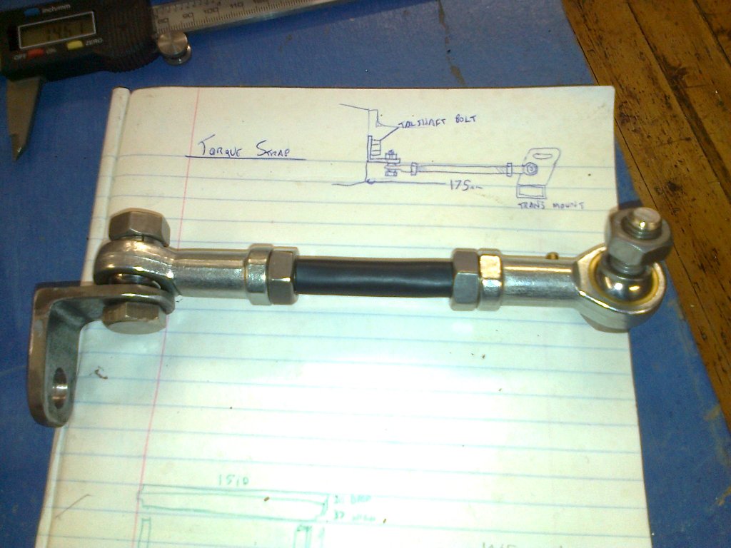

I have 3 Big Strong Boys comin round tomorrow so we'll have the motor out and flywheel off no bother!
I've made the torque strap today, nice easy job! I'll fit it when we've pulled the motor out.
Torque strap 01.jpg (113.74 KiB) Viewed 1074 times

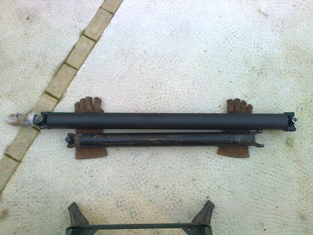

New prop arrived today :D
It's a monster 3.5" 7290 front, 1350 rear :shock:
I'll be impressed if I ever break that!
Propshaft.. New vs old.jpg (182.24 KiB) Viewed 1021 times

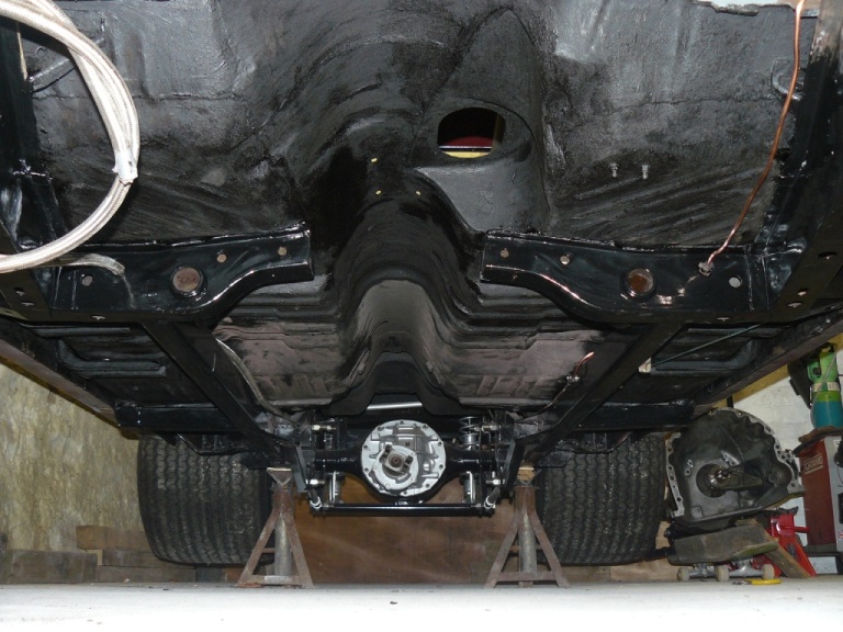

Been lying on my back for a couple of days....
This is the result, curtesy of Tetroseal and Blackfriar chassis paint :D
Chassis painted 2.JPG (182.84 KiB) Viewed 980 times
Chassis painted 1.JPG (214 KiB) Viewed 980 times

See........I told you not to waste that opportunity to do more stuff on yer car, good work mate :thumbright:

Posts: 9578
are you going to put a strap inside the car to connect up that middle cross member....?
used to be a swaged 2 inch wide loop there inside the tunnel....
the gear box rear support bolts on but doesn't provide the same kinda structural integrity thats needed for a car that goes round corners
or so i have been lead to believe
as has been said on here plenty of people don't put anything back once thats been cut out, and with no detriment, however i'm inclined to think as the torsion bars have their foundation within 6 inches of here that chrylser wouldn't have wasted a bit of metal if it wasn't necessary.....although your motor plate will add some anti bend properties to your frame rails you have also lost your K member.......
