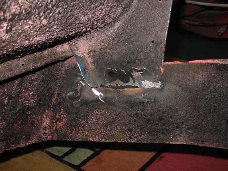

I decided to repair my old MIG welder that has seen better days. When that was done i decided to weld up a few bits on the Challenger that I knew needed doing as soon as I removed the fenders.

I was off work today due to being up all night with a bad stomach so this afternoon I dragged myself into the garage to see if there were any little jobs I could do to the car within running distance to the loo.

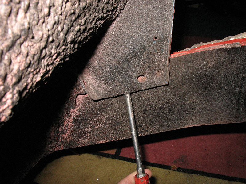

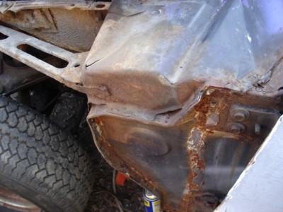

- This bit at the back of it was loose too.
- IMG_0302.jpg (141.16 KiB) Viewed 10972 times

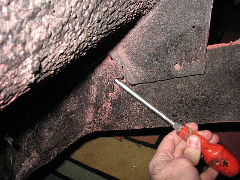

- The bottom of the inner fender was detatched from the chassis.
- IMG_0301.jpg (129.31 KiB) Viewed 10972 times

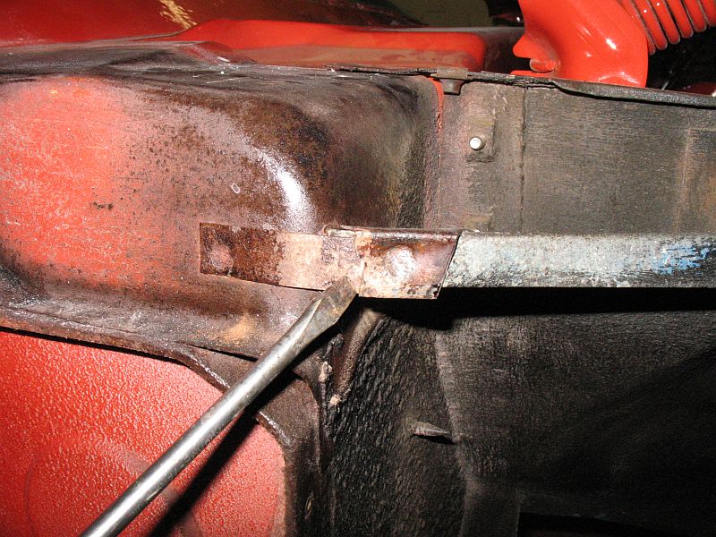

- The fender diagonal stay was detatched from this strip that ties it to the bulkhead
- IMG_0300.jpg (141.57 KiB) Viewed 10972 times

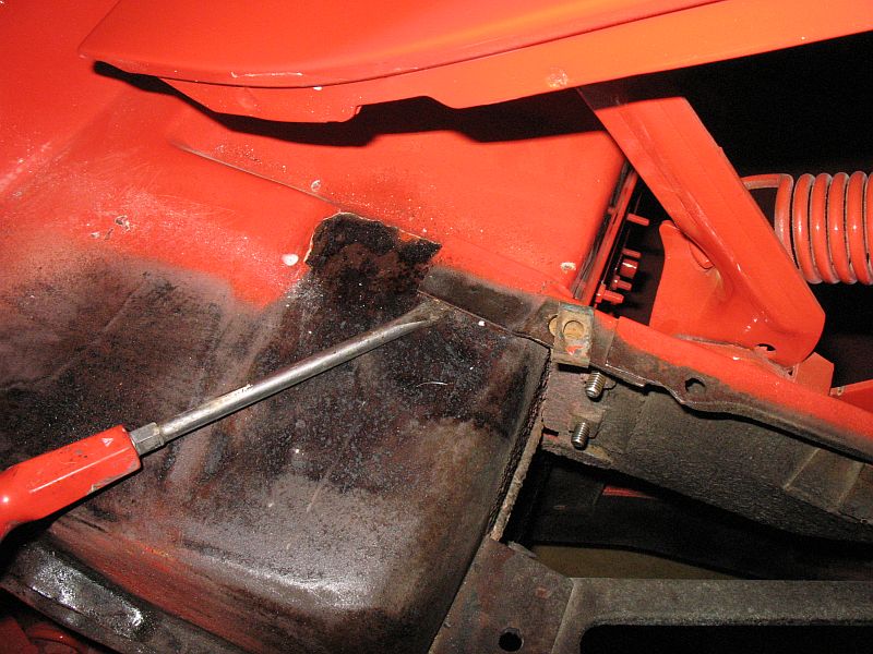

- The back end of the right inner fender was loose on the bulkhead.
- IMG_0299.jpg (111.03 KiB) Viewed 10972 times

well i started welding but I was out of practice so it was a bit rough until i got the settings right. Then it went rough again because the gas ran out!
Never mind. It got a good hold. I just dressed off the snotty bits. I'm not so proud as to hide my welding if it is not perfect. As long as it does the job and can't be seen when the car is complete.
The fender stay on the drivers side is very loose as well. I will weld that when I get more gas.

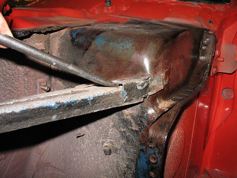

- Still got this bit to weld.
- IMG_0305.jpg (127.42 KiB) Viewed 10966 times

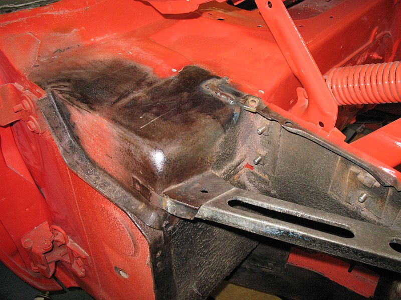

- Bottom of inner fender welded.
- IMG_0318.jpg (143.87 KiB) Viewed 10966 times
- Top of inner fender and stay welded.
- IMG_0311.jpg (121.16 KiB) Viewed 10966 times

I got about 2 litres of loose rust out of the bulkhead before using a lot of rust converter. Once this welding is completed I am painting the cowl inside and out with acid etch primer and satin black paint (most Challenger R/Ts had the top of the cowl painted flat black) and then the inside will get a good coating of waxoil type stuff.

They are supposed to be welded. But before I bought the car that side had been impacted. The wing and bumper were destroyed. The grille and inner wing were damaged and the chassis rail bent.
The chassis and inner fender were straightened out. But the impact or straightening must have pulled the spot welds off. I only noticed when I took the fenders off after Matty painted the car.
I fixed the grille myself when I first got the car. The front bumper was replaced with a plastic copy. The wing was a used one from a metallic green car.
It is important to find any bits like this and repair them. They keep the body/chassis stiff and cut down on the creeks and squeeks.

That's odd because the other side of the car that has not seen damage is factory spot weled. Probably not very well but I tried shifting it and it is solid.MrNorm wrote:Actually my Challenger was not welded at the bottom like yours Dave (inner fender to chassis rail). I welded it up too!
I hear what you are saying about filling that seam inside the bulkhead. have no doubt that it will be completely filled with wax or similar.
I was thinking of adding more strength to the stays but once welded they seem pretty stiff as they are. I didn't have issues while they were loose so I don't think I will bother.

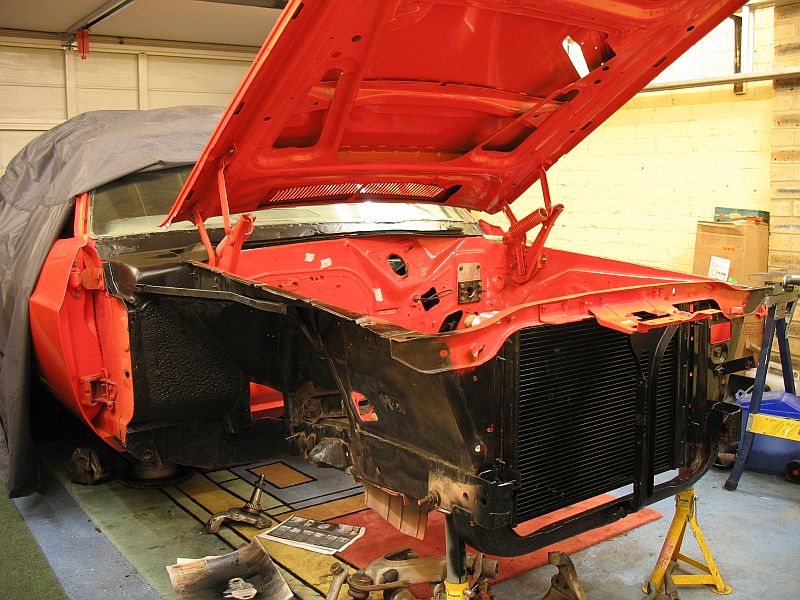

Here is the Chally as of tonight. Just started spraying some black radiator paint (not normal paint) on the radiator to improve the efficiency a bit but also because, as every 1970 Challenger owner knows, if you don't paint everything black behind the grille it looks awful when you look at the front of the car head-on.
But I will still post the odd photo on here from time to time. Not answering any questions though. Probably post in the for sale/wanted ads too. But that will be all. I have a lot on this year.

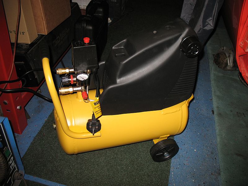

Got my Christmas presents AT LAST!
First of all yesterday I got a cheap 24ltr 8bar compressor. £80 from Screwfix.

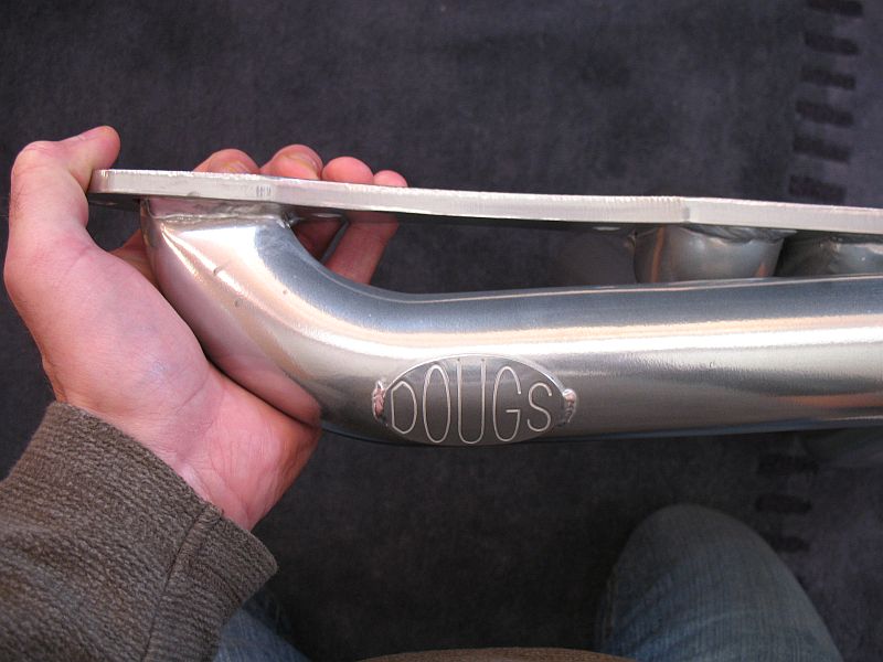

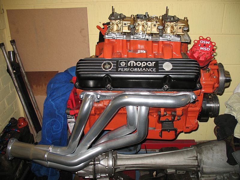

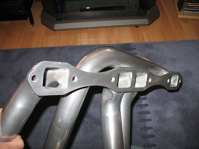

Then today got my ceramic coated Dougs headers. 2-inch primaries and 3.5 inch collectors. Delivered to my door at a total cost (including postage and taxes) of £488.
Stick that up your TTIs.

It is both center tubes on both sides of the engine. Typical for 2-inch primaries. The only thing i don't like about them is the collector reducers. They reduce from 3.5 inches to 2.5 inches. I want to run with 3 inch pipes from the collectors to the mufflers at least. Although I might reduce down to 2.5 inches for over the axle and back. But I have not decided yet.RobTwin wrote:surprised to see that good quality headers these days still need no.5 tube flattening for the spark plug![]()
So if anyone has any 3.5-3.0 reducers for sale please let me know. Otherwise I can cut and weld these ones to some 3 inch pipe I have.
Dougs claim their headers are the best fit on the market.
But we will see.
The original "Headers by Doug" seems to have split up into two companies taking advantage of the name. Unless I am just confused? Not unusual for me.
These ones are called "The Original Dougs Headers" and the parent company is Pertronix.
Headers by Doug was the original drag racing header manufacturer. His products were always the best. So if the new owners have anything to do with Doug they will have to maintain a high standard.

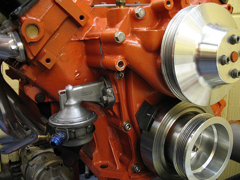

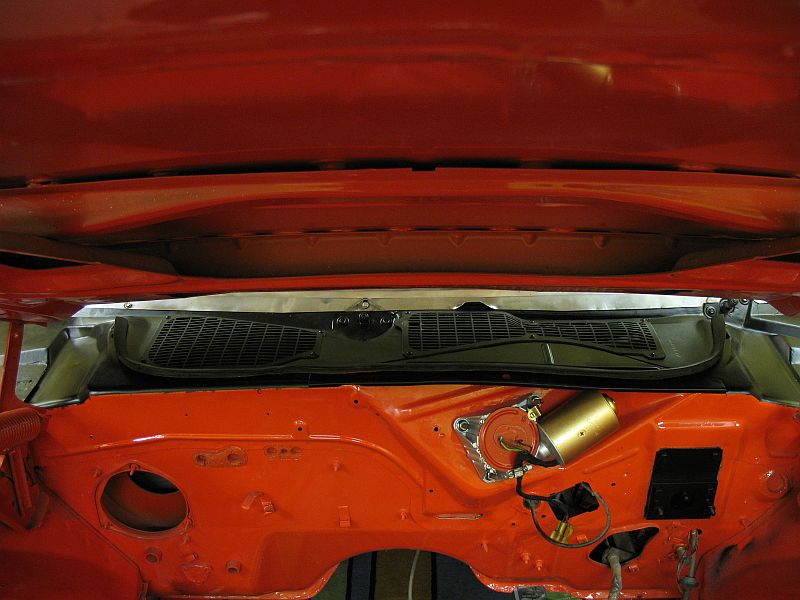

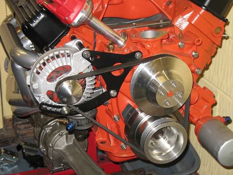

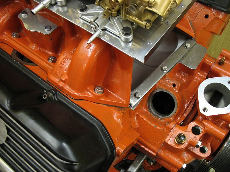

Well the bulkhead is now finished apart from cleaning the rubber seal and pollishing off the rough edges where paint has ran under the masking tape as well as the overspray I seem to have all over the place!
Other jobs I have finished off is sorting out all the stainless bolts for the engine.
I got quite a few from Wil that have hex socket heads but then decided I wanted some of the bolts to match the stainless bolts I am using all around the engine bay such as the fender bolts so I bought some of them locally.
I used the hex head screws for the pulleys and timing cover. Also the alternator adjuster. I couldn't get a stainless bolt long enough for the top of the alternator to the head. So I just cleaned the original one up and sprayed a clear coat over the head so it looks like stainless.
Some of the bolts had to be cut shorter and more threads cut onto them.
