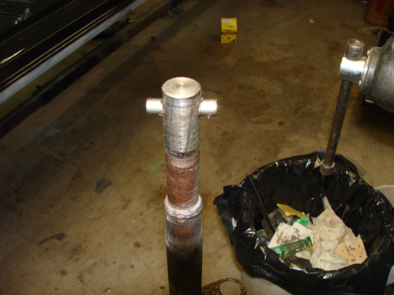

Ain't gone exactly as planned :roll:
Took the column out easy enuf, whipped off the steering coupler.....
To find an all round shaft with a big pin thru it instead of a dd shaft that I could just slip on the new coupler and pin it down :cry:
I think this is the wrong part but I may be able to get the shaft machined down to match the new par, only needs a couple of flats puttin on itt, may be able to grind it myself if I'm careful!

Humm you have the wrong part,I went through this with them , send it back they have the correct unit dont grind it down.
tomorrow i will look at my column :thumbright:
Yeah you got the wrong application mate.
On mine, with the shorter PS steering column, I had to knock the pin out and the new part came with a sleeve that slided over it. I then had to drill through the hole in the sleeve and insert a new pin (supplied).
This sleeve had the flat sided shaft already welded to it. I just had to cut it to length to fit into the UJ.

Judging by Steves original post he ground flats into the original shaft and then countersunk em for the joint grubscrews.
I went on the part number FR1755 from Drews pic and ordered that, I have a power steering car so the spline size is perfect, its the rest of the part thats wrong, having looked at the website and understanding it a bit more I can see a joint with a smooth 3/4" end for the steering shaft, pt no FR1757.
should have done a bit more research I think :roll:

It's a 72 Drew with factory power steering, original column (floor shift), I was a bit surprised to not see a lower column bearing too.
The joint I have looks just like the ones they use in the kit that does power to manual, the DD socket looks just the same.
I'm in half a mind to give the column and joint to my machinist mate and get him to mill it for me, it'll only take him a half hour, then I can just cut the length to suit.

Does yours look like this?
Looks like I am having to give flaming river a call :x
Sorry Ade for assuming my part would be the same and now I am sitting here with the wrong one too :shock: ........gulp!
DSC0786770 cuda column.jpg (67.15 KiB) Viewed 363 times

Identical Drew! That's exactly what I've got
Hey don't blame yourself for this ffs, it's up to me to make sure it's what I need, I should do the legwork not you ;)

Yea at least I know I have the wrong part and I learned from you ..............sorry you are the quinea pig for this one :dontknow: :scratch: :banghead:

That's the same as mine but as mine was already modded and longer I just had to grind flats to for the DD coupler on to it...basically just ground the pins off and ground flats into the shaft.
The dd supplied shaft is lon mig, so you ll have plenty to play with
