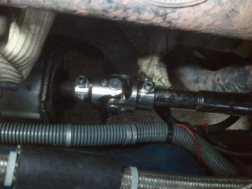

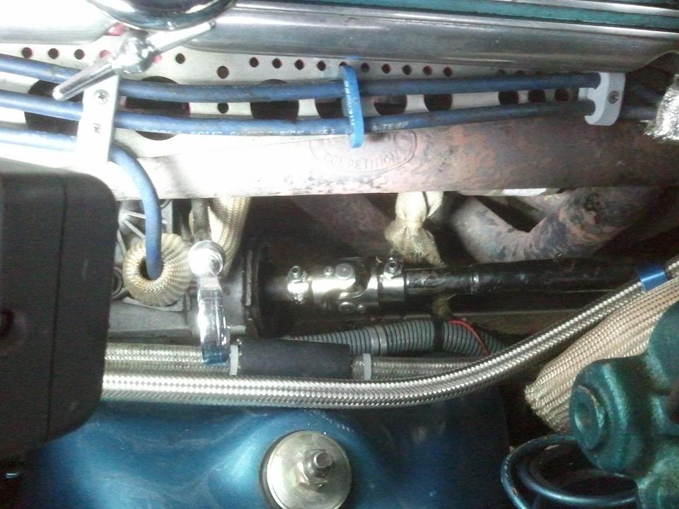

Heres a few pics taken when it eventually stop raining yesterday
If Dave puts up a picture of his install, you will see that i did not have to use the extension shaft as mine had been modified before by me many years ago, and the shaft was so close, we only had to put 2 flats on the shaft so it could slip over the New coupling, and then cut off about an inch so that the shaft would not obstruct the UJs operation in anyway, not that it would, as the shaft is so straight on to the steering box it will never be at any acute angle to bind it.
Hope the pics help
2012-04-21 17.31.20.jpg (108.41 KiB) Viewed 1163 times
2012-04-21 17.31.01.jpg (96 KiB) Viewed 1163 times

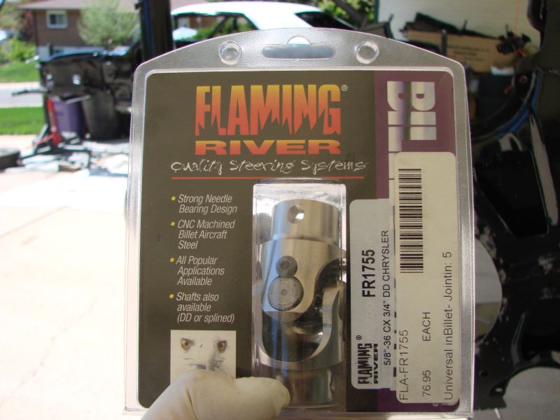

I found mine .,,,,in a drawer
DSC07815found it.jpg (80.3 KiB) Viewed 1120 times

Drew, Is that the DD shaft end coupler
Ade what more do you need to know ?
ALL KILLER NO FILLER
AllKiller wrote:Drew, Is that the DD shaft end coupler
It looks the part
