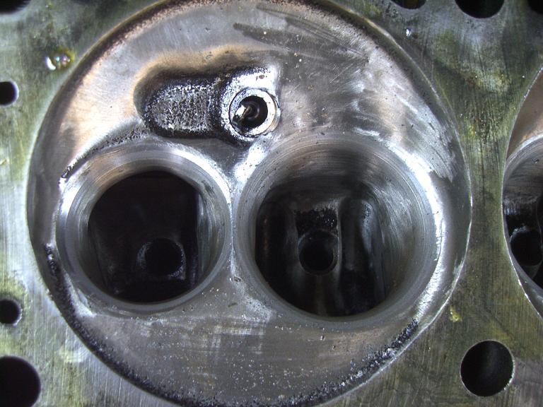

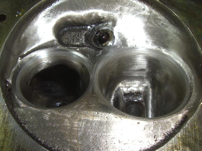

Here you go Dave. What do you think??
Pretty good! :thumbright:
Have you managed to work out how much you need to machine off?

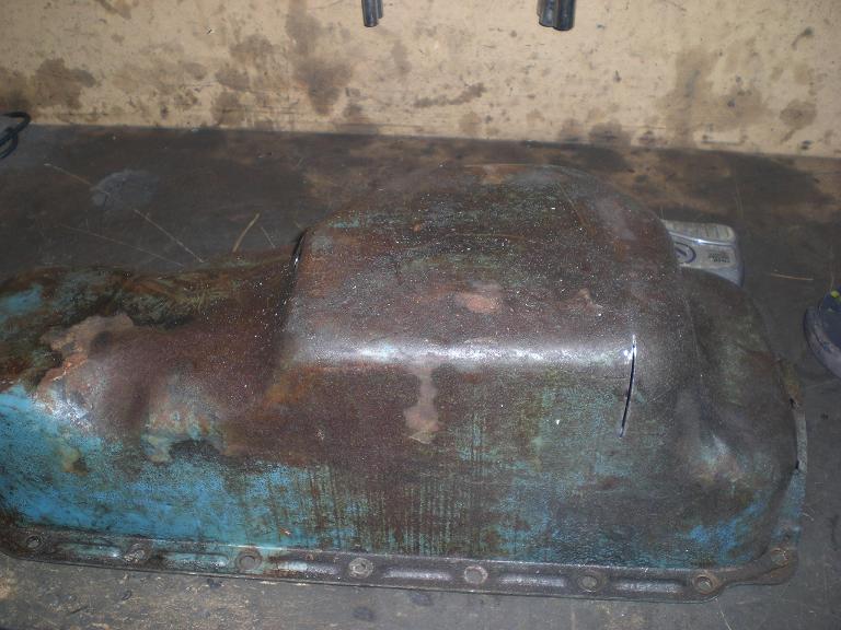

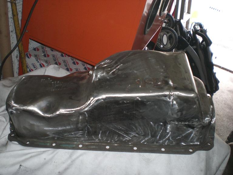

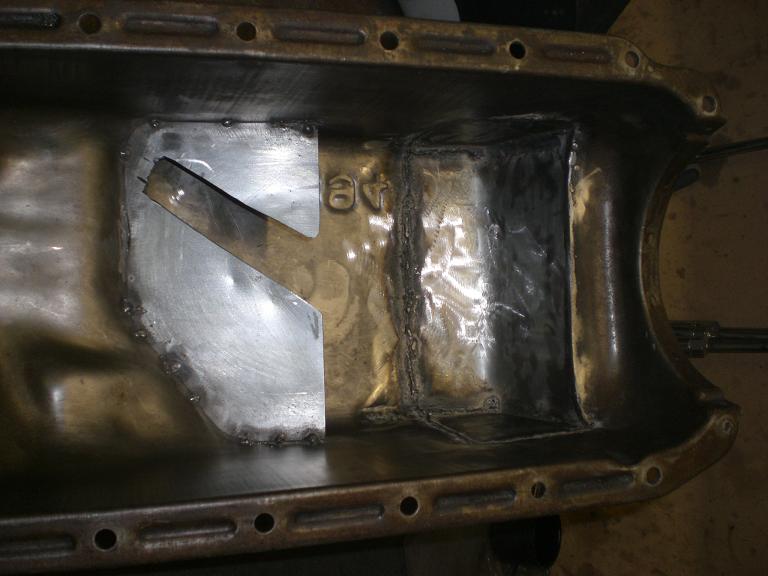

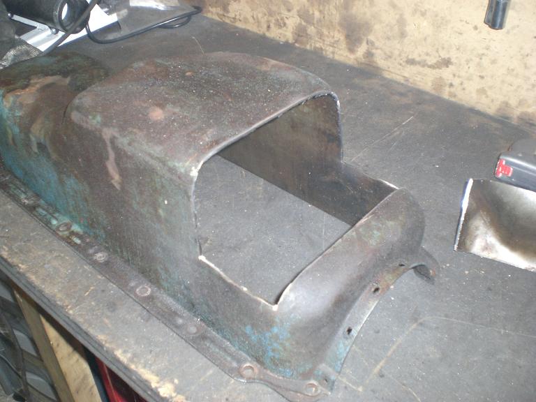

Spent a bit of time in the garage today modifying my sump to take a bit more oil and this was the result of the work.
Baffle added to stop oil moving to the back of the sump under hard acceleration
add a new section in lenghtening the base of the sump to hold more oil
cut front section out
Start with basic 318 sump

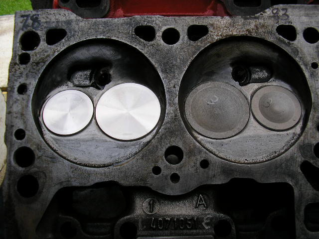

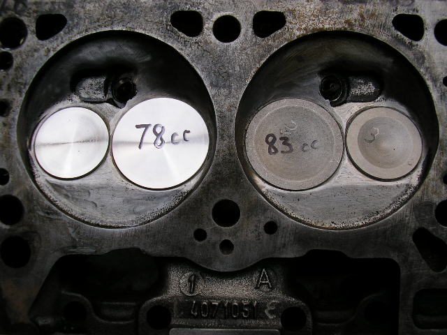

Nice work there Anton!

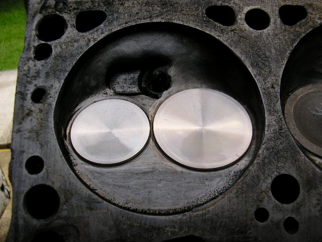

Had a bit of a shock when I cc'ed the Head chambers!
They were a whopping 83cc's in volume almost 11cc's bigger than a stock 360 head!
So what has happened here?
I have checked and double checked these heads and went to great lengths to find out why???
Searching on the Net did not come up with a good answer, the 360 head chamber in all the literature I read should not be larger than 75cc's.
All I can summise is that the machine shop had to cut the seats quite hard to get them to clean up?
Seconly the Inlet valve appears to be 15thou shorter than the exhaust so they have been cut into the head 'much more' to get the stem height correct.
Now here's the shocker, just fitting the Ferrea Nailheads reduces the Chamber volume by a huge 5cc's.
Bacca.

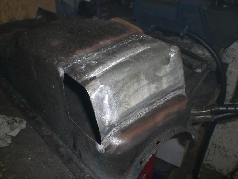

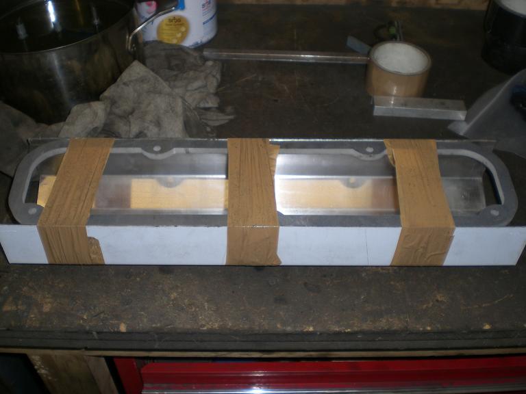

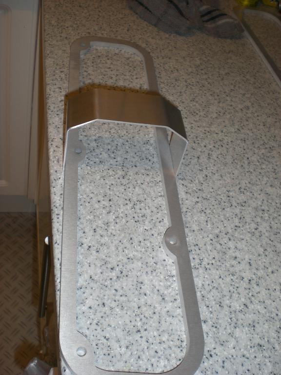

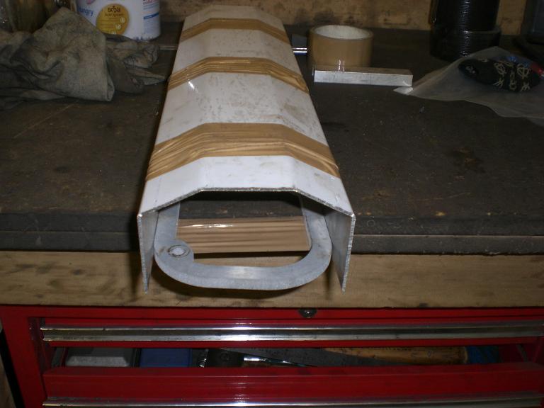

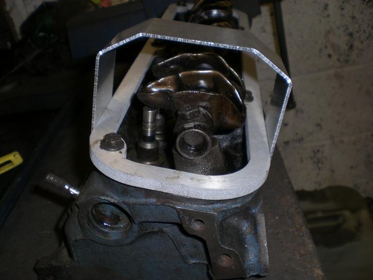

Over the past week I have been working on my rocker cover while I wait for my heads to get back and this is where I am at.
Now I need to shape the end and fabricate the ends and then get them welded
Full cover bent
Full cover bent
Checking clearance on the heads.
9mm ali base plate and small sample of the cover shape
