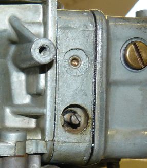

I take it this is my vac port? It appears blanked off...
vac port.JPG (27.2 KiB) Viewed 770 times
db wrote:I take it this is my vac port? It appears blanked off...
Yep it has been blanked off. Shame that.
