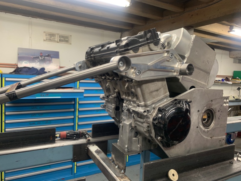

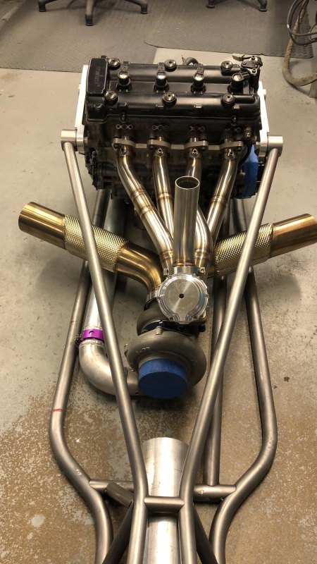

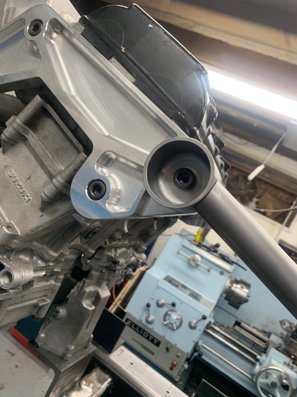

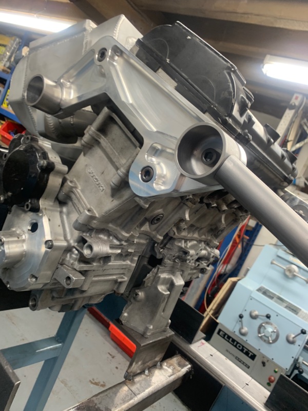

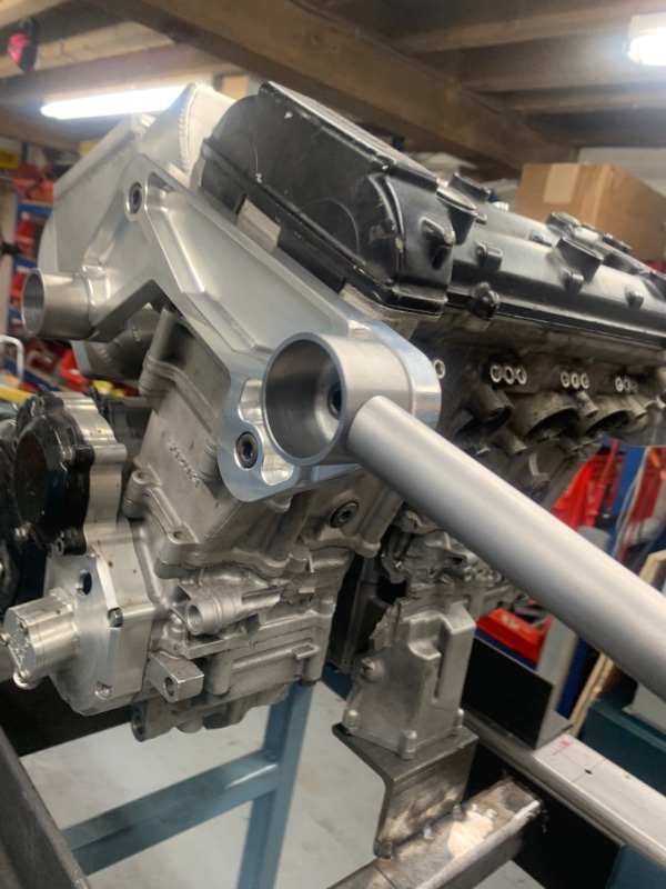

Loving the engine mounts :rr:
Fantastic work as always :thumbright:

Correct Gavin Very sad indeed I’m still in touch with his family and I’m keeping them updated on our progress :thumbright:

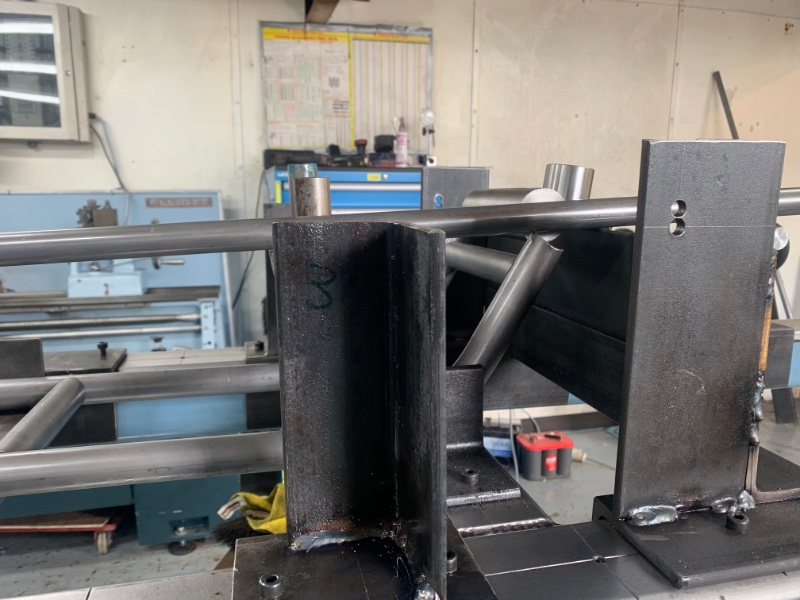

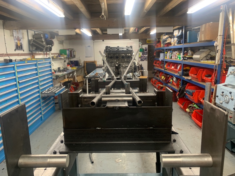

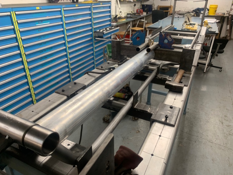

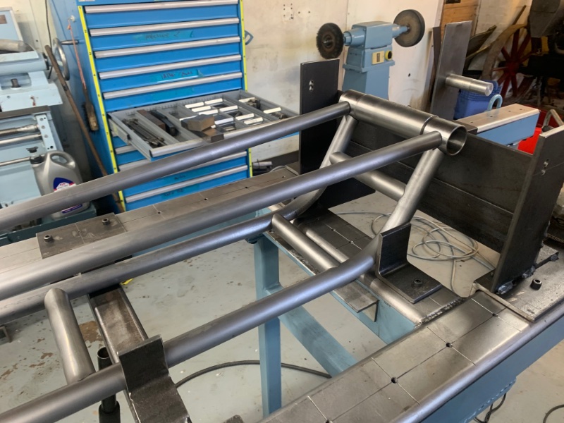

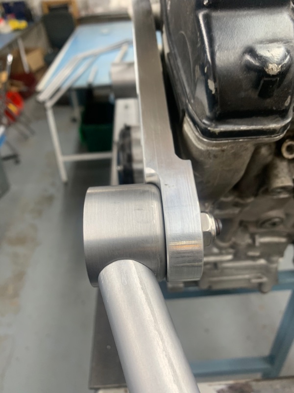

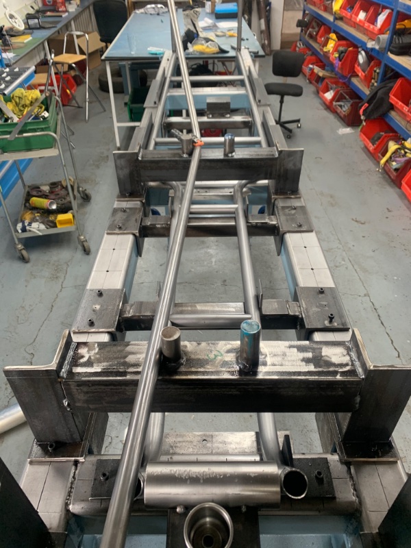

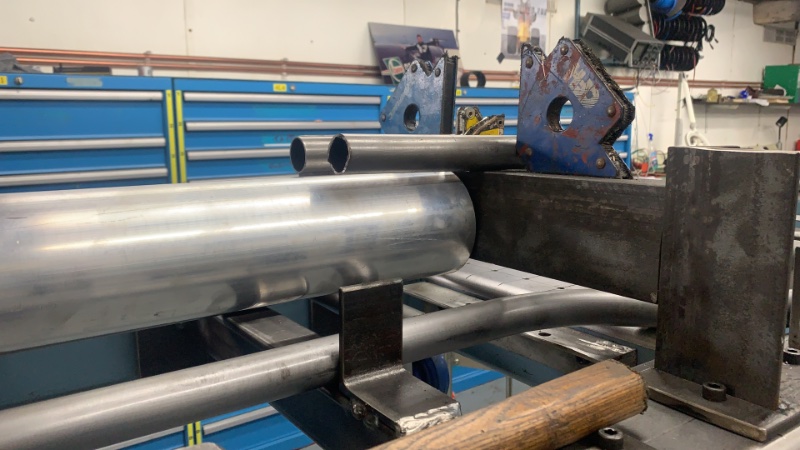

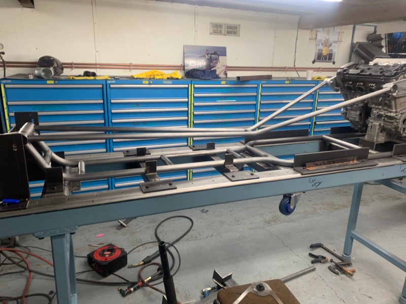

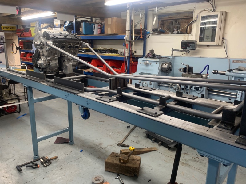

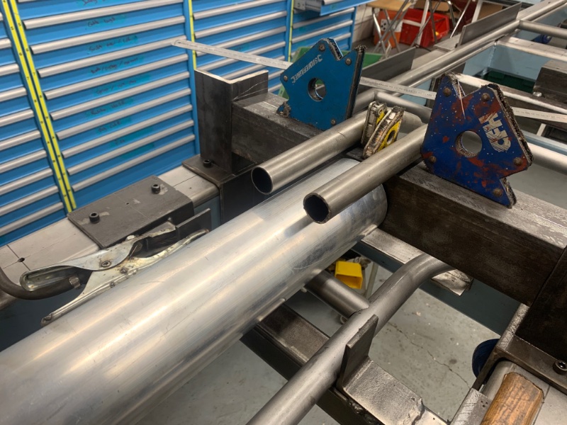

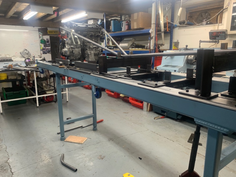

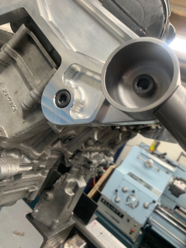

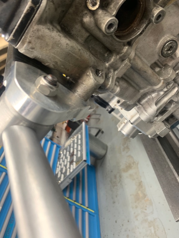

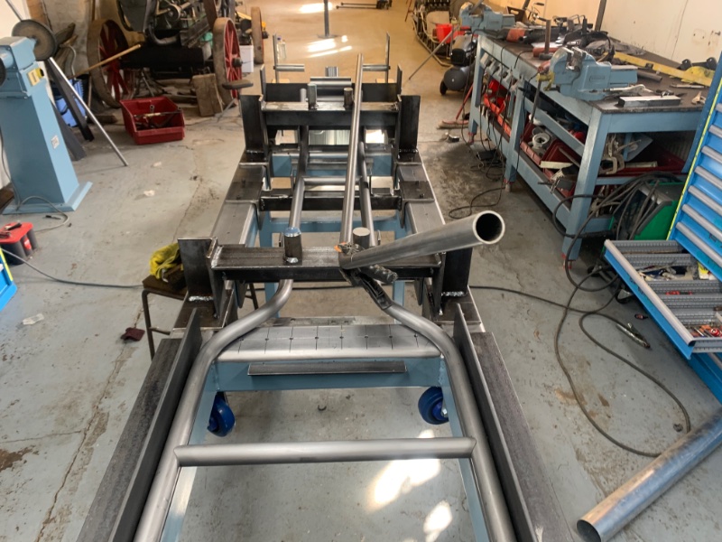

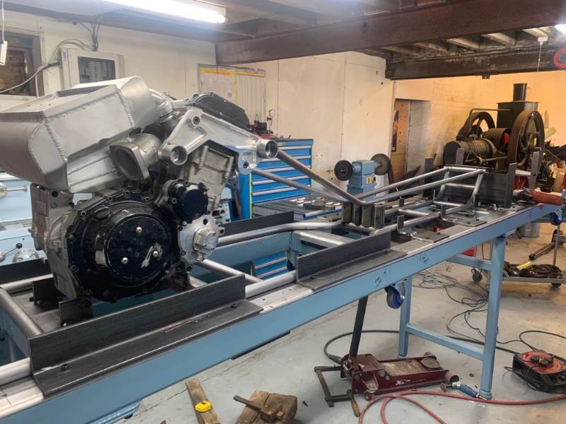

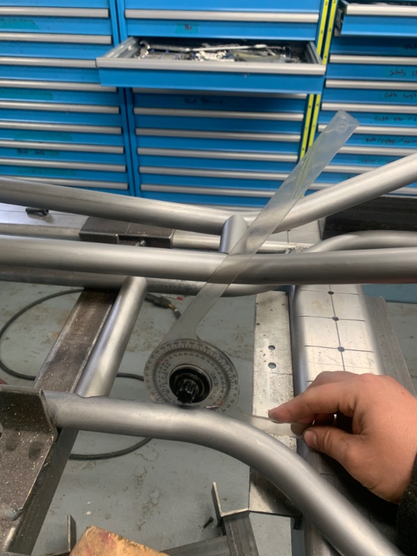

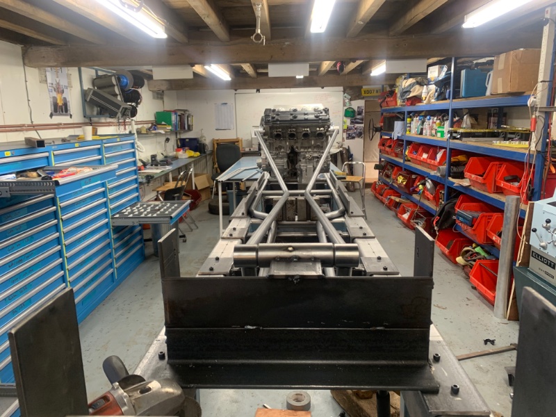

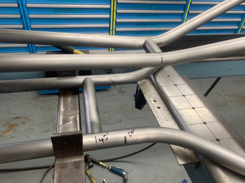

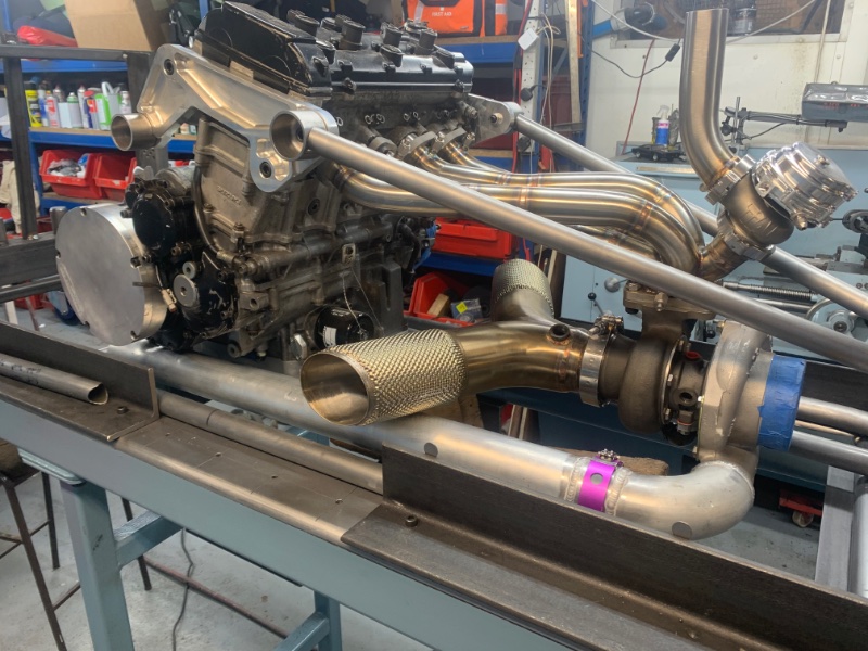

Next up i decide we would build the chassis around a 4” tube.
The interior of the chassis will be hollow and used as some sort of giant ram air intake plenum turbo feed system thing later.

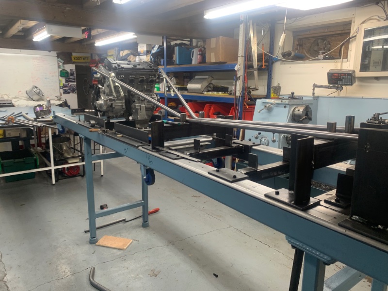

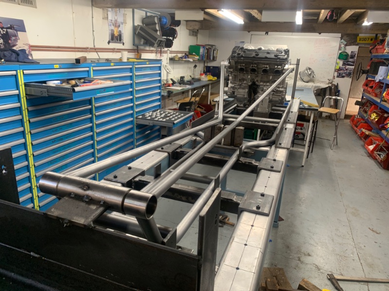

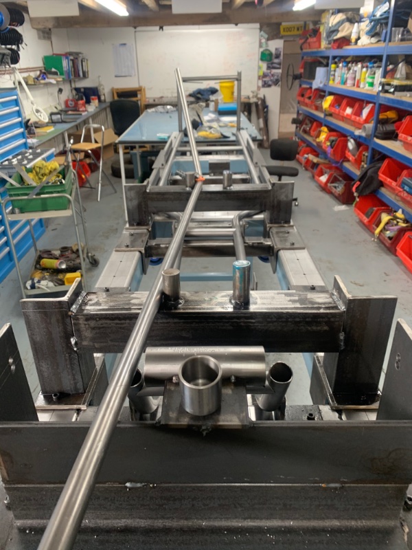

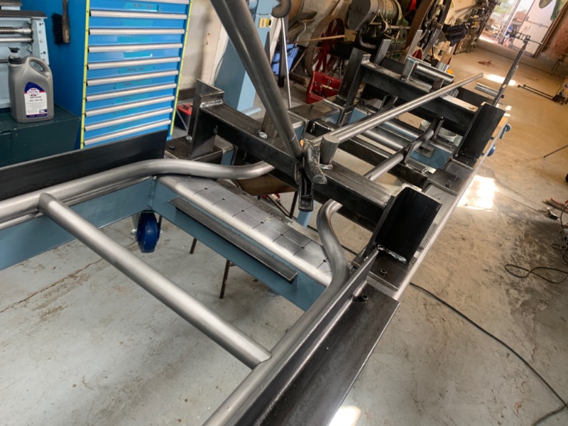

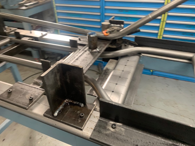

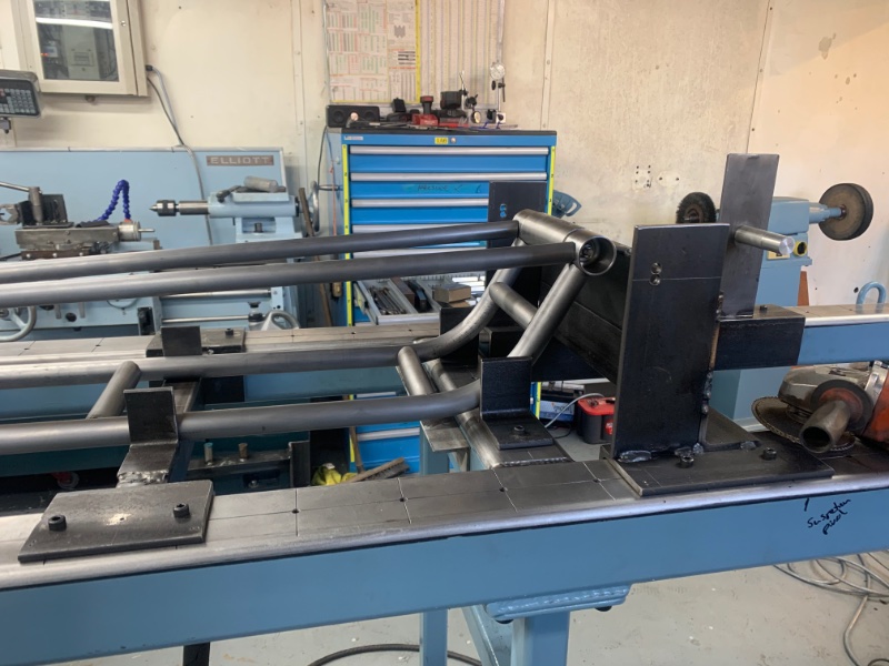

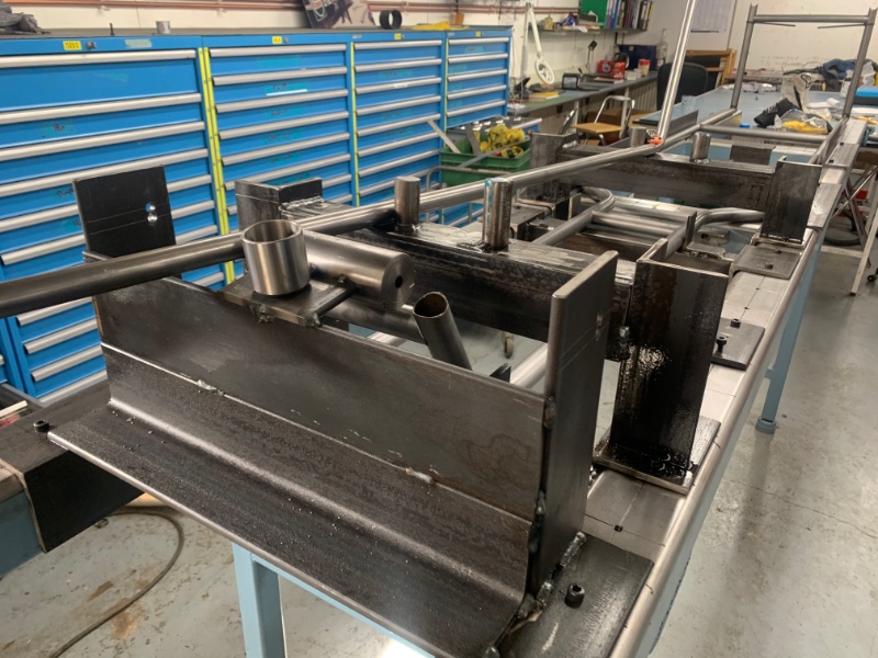

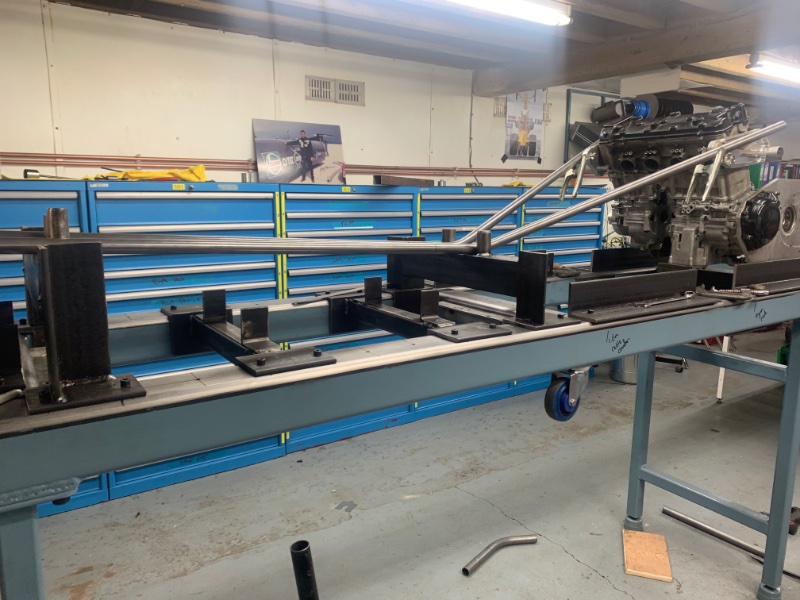

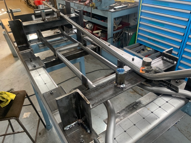

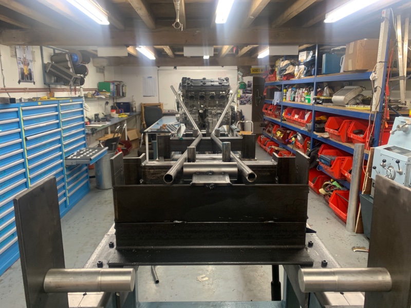

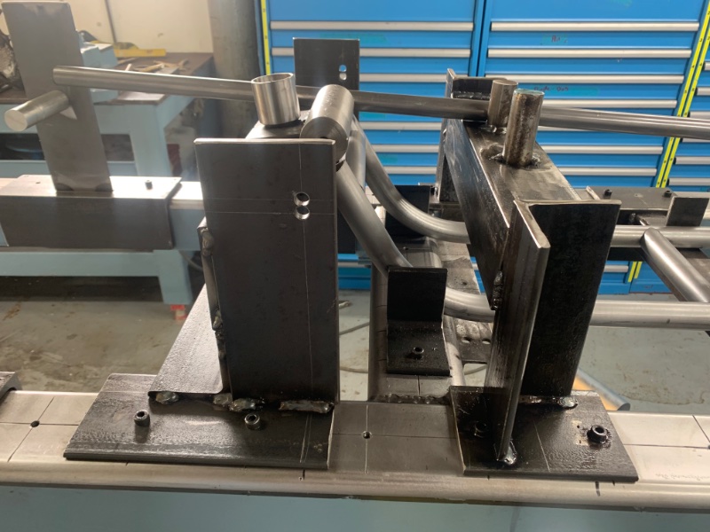

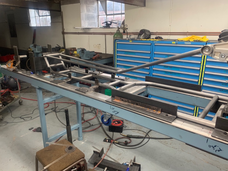

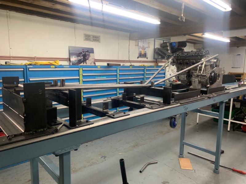

Built more fixtures to help get the top rails in place. :roll:

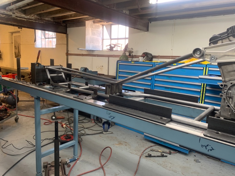

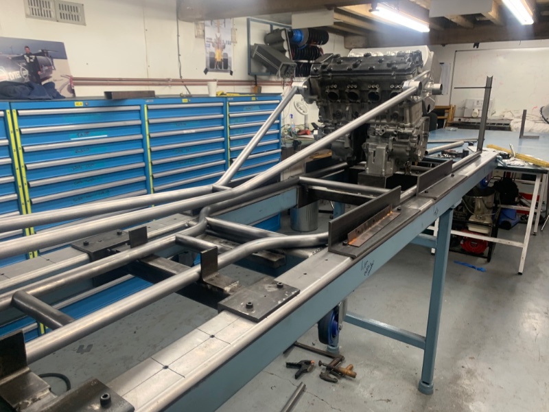

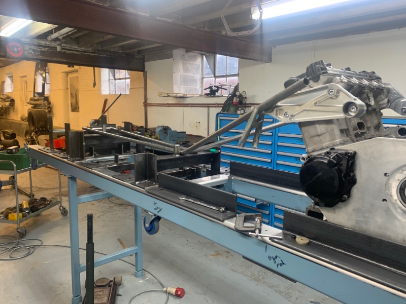

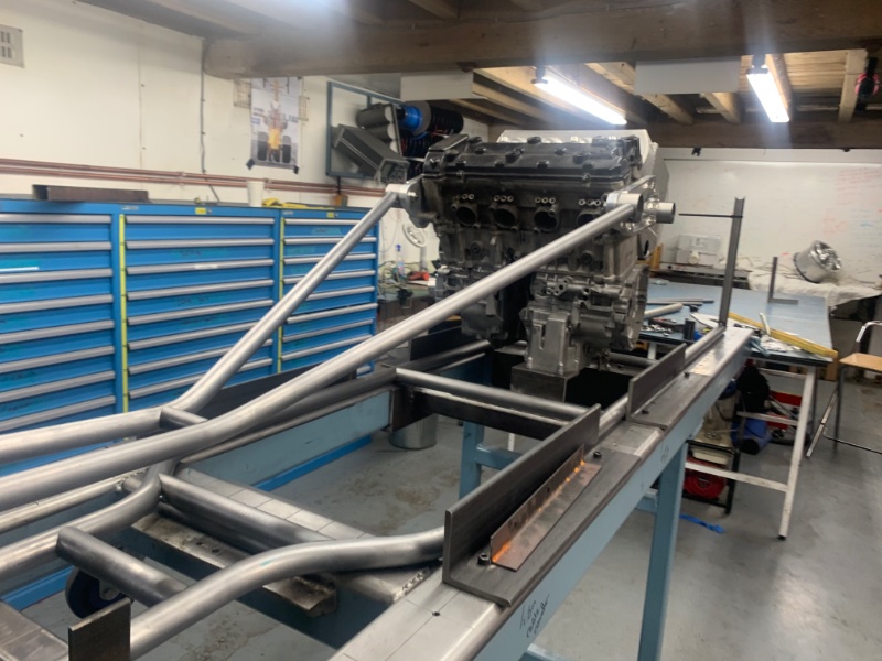

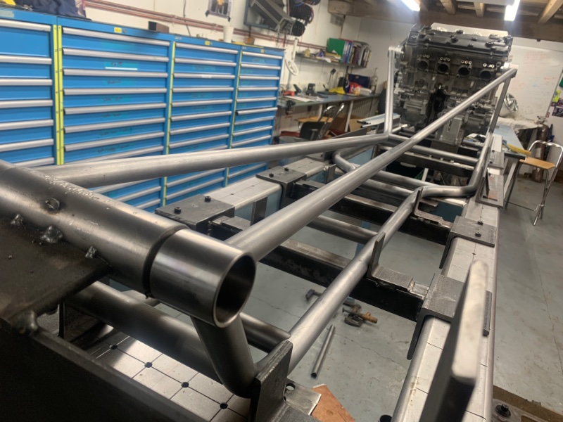

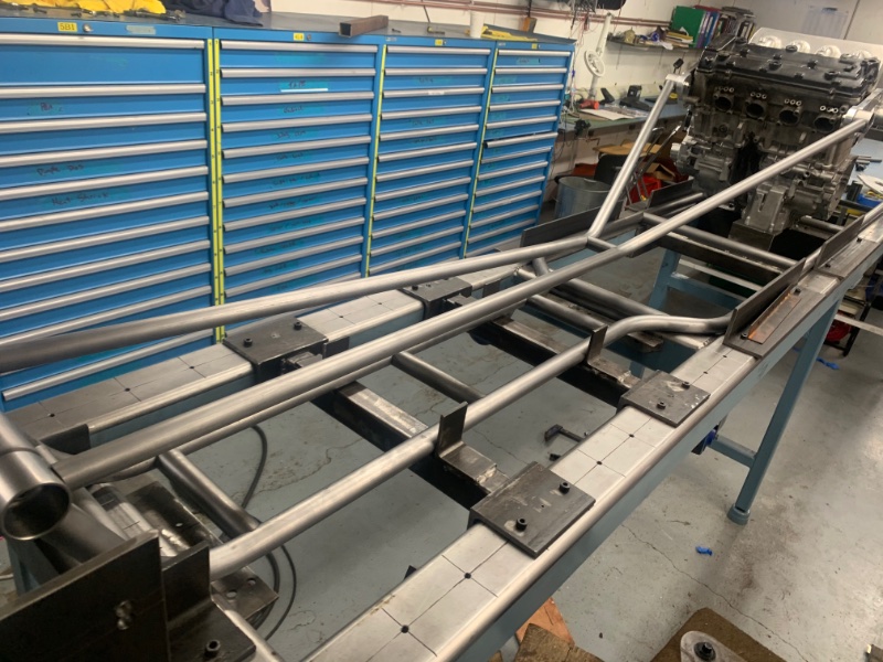

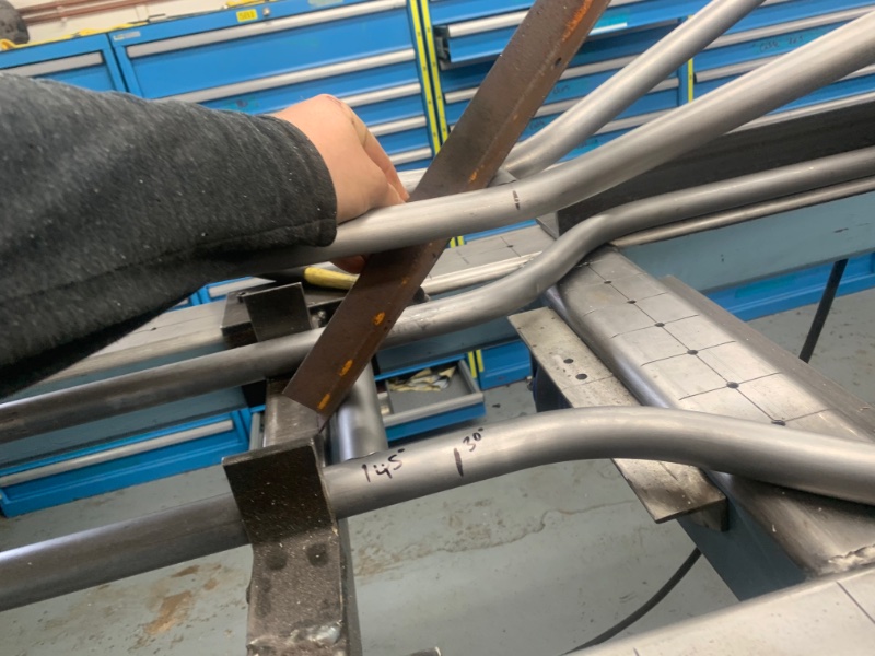

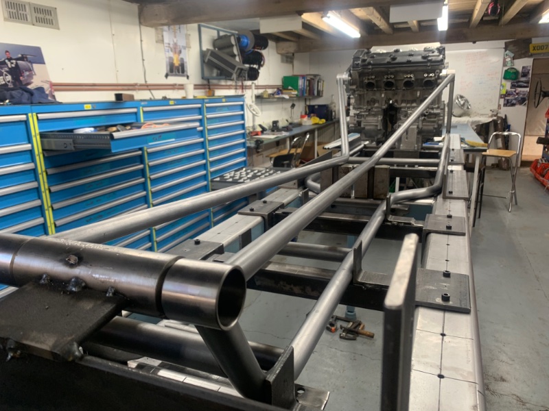

The rider, when in racing position, must remain completely visible from either side of the motorcycle, without having to look through any material. Only hands and forearms may be hidden when viewed from above. The rider must have unrestricted (fore/aft) movement of the arms when seated in racing position.
Due to this rule the chassis needs to be very narrow around the bullock point. So a lot of support will be need around this area

Blue wrote: Sat Jul 25, 20 12:16 am Beyond spectacular!

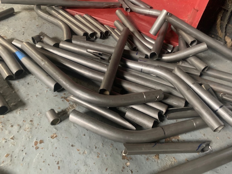

Don’t be fooled by the pretty tube work.

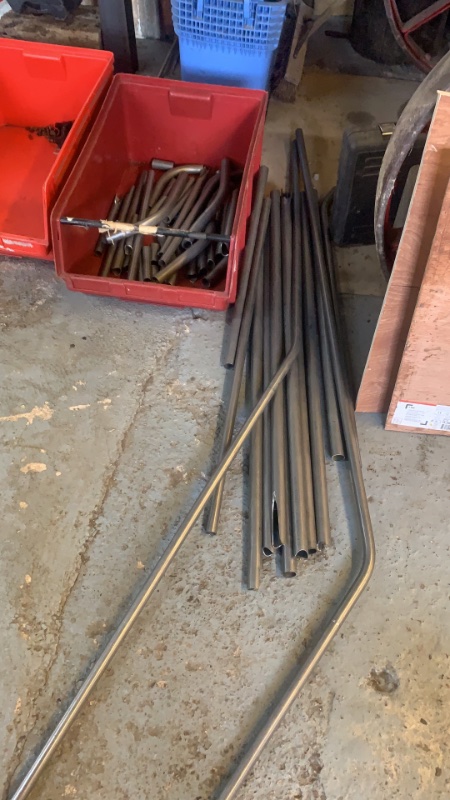

The struggle is real and a lot of tube was harmed in the making of this bike :-#
For ever tube you see on average it took 3 attempts :(

:lol: :lol: Still dead impressive. To create that fixturing so you can build it to his level without having to lay even one tack weld on the actual frame is brilliant :salute:

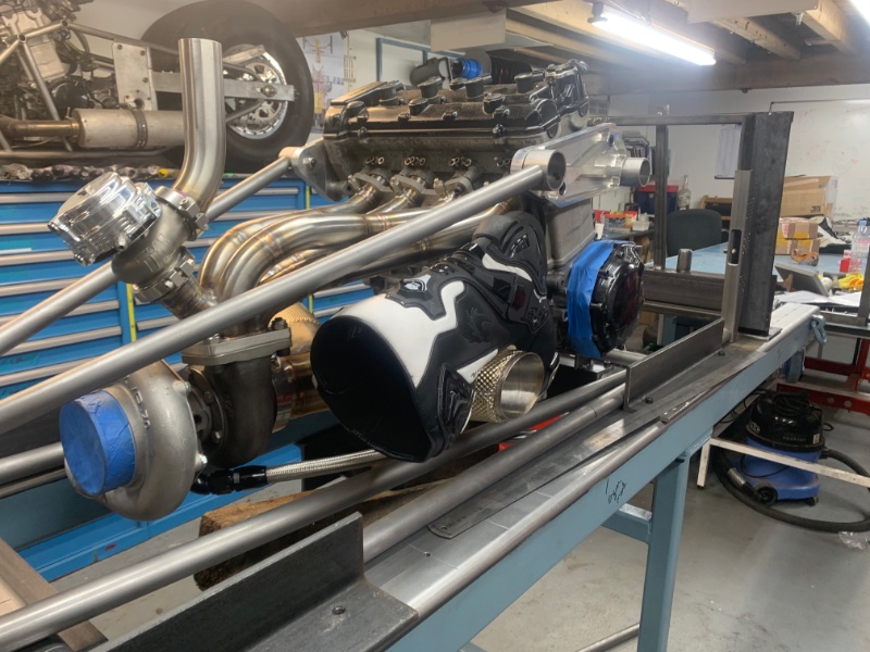

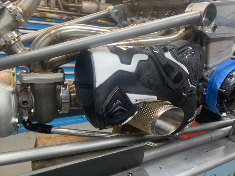

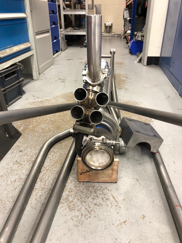

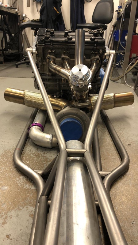

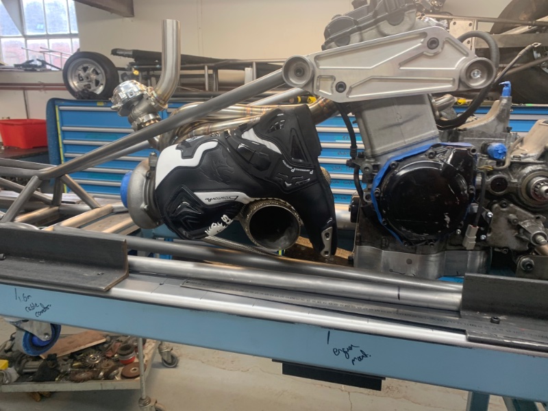

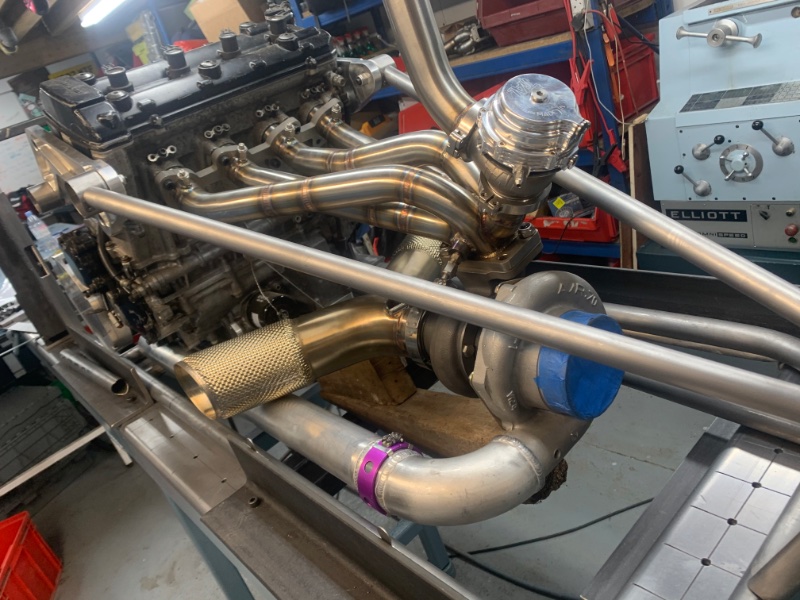

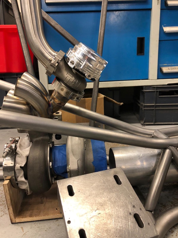

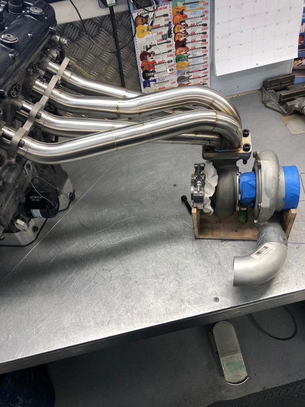

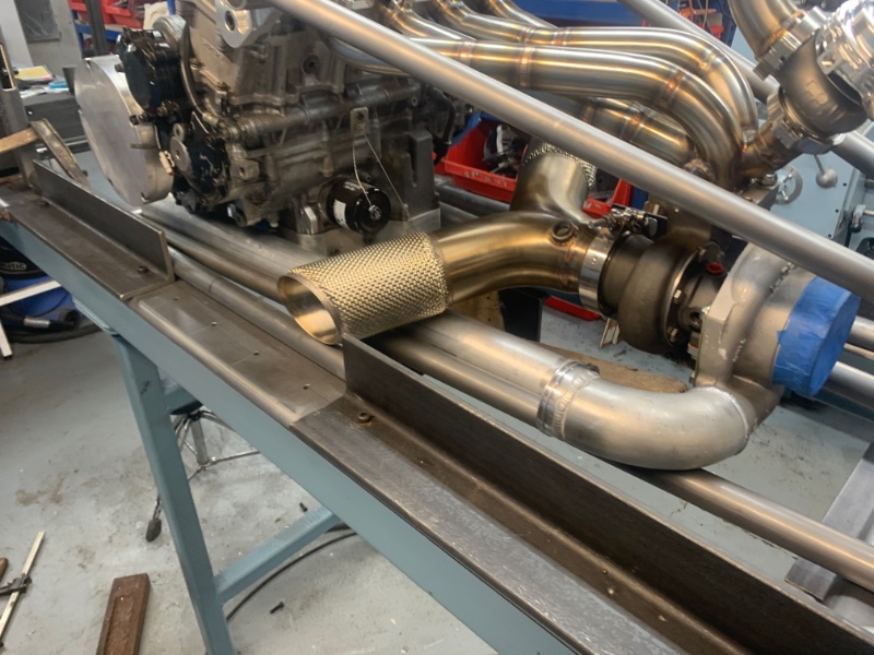

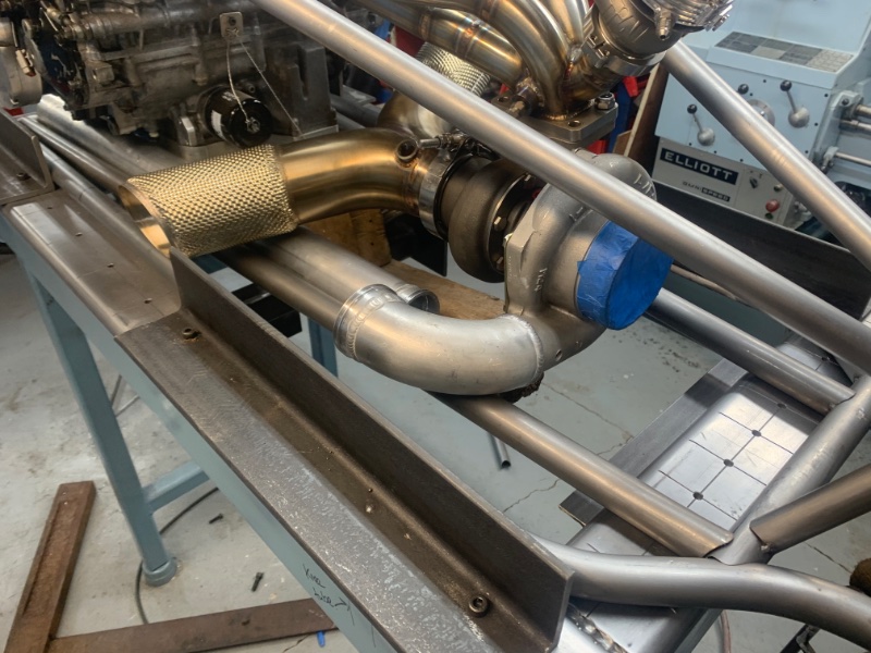

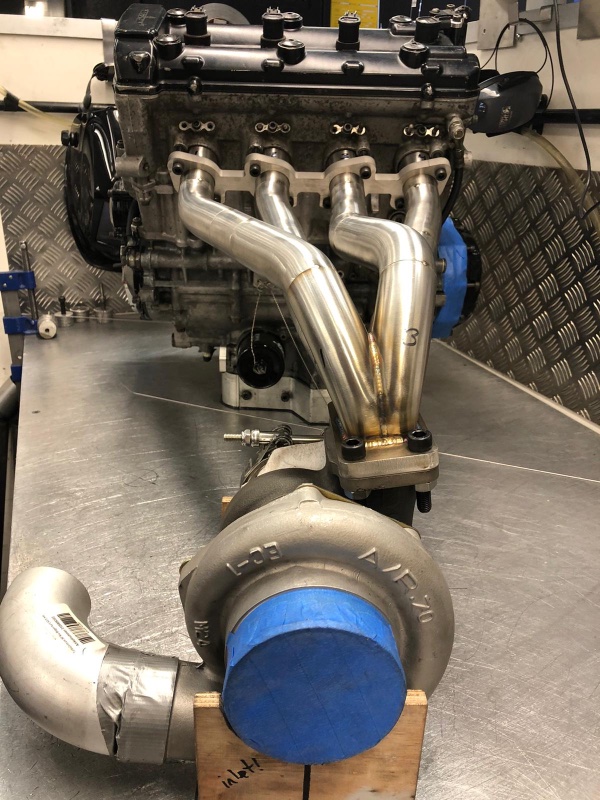

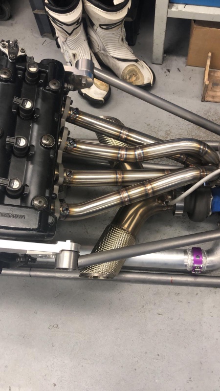

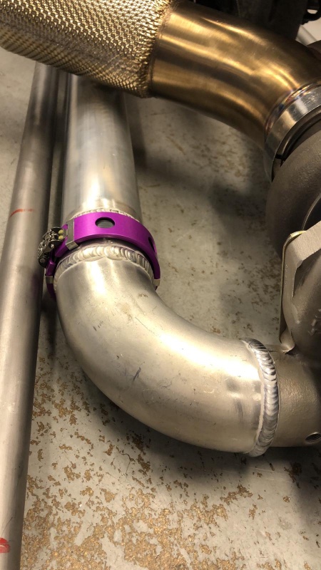

Re: Fifty shades of Jade

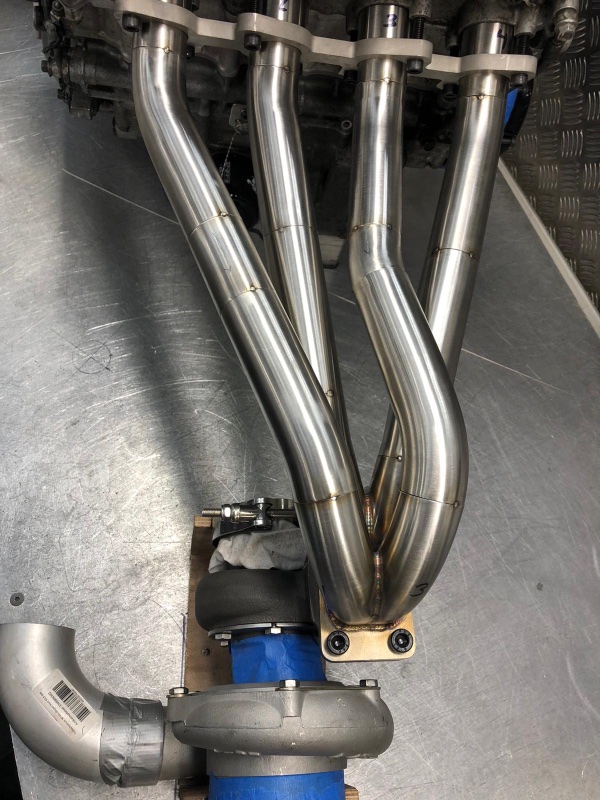

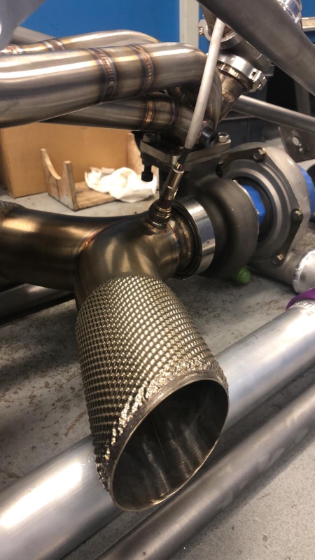

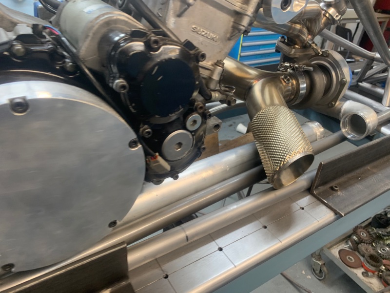

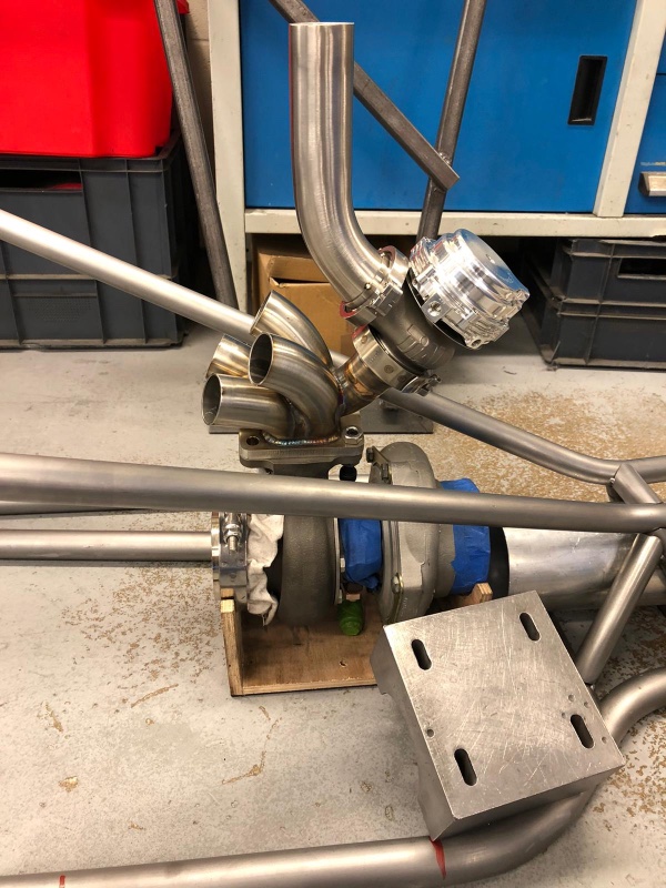

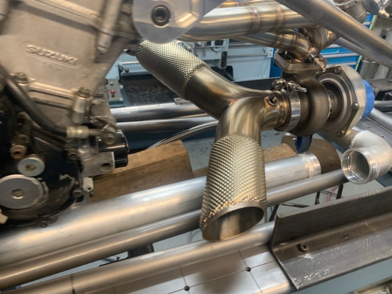

Raise the bar
Push the envelope
To smash the competition Into the weeds something very different needs to be presented

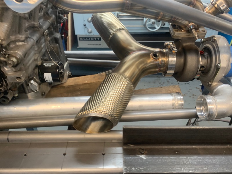

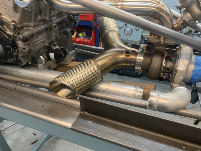

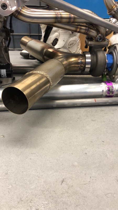

A new design turbo Mainfold was created :-$
Morgan you will need to update the sheet again :reindeer:
Posts: 1684
:shock: I think your feet might be getting a tad warm with that.
