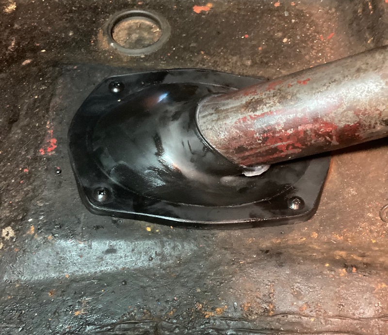

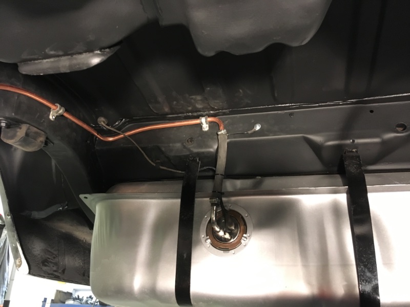

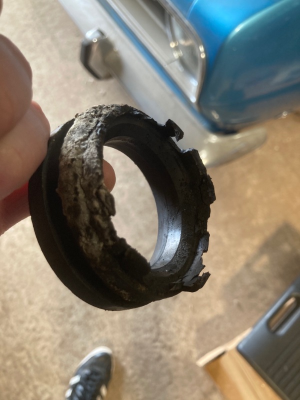

A good friend came over with a spare pair of hands and can-do attitude and we got the new tank seal and boot floor seal done finally. The old seal was in a right old state…
Floyd Brothers 70 Challenger
- Stu
- Posts: 7205
In other news, an actual productive day when nothing went wrong!
- 7F0DE09A-B224-41D0-88F0-80B5D81E5C29.jpeg (117.9 KiB) Viewed 2677 times
- 21DBC8E5-4529-4F74-9C75-782B95250C37.jpeg (276.64 KiB) Viewed 2677 times

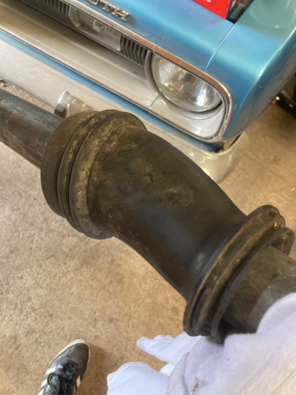

And as for the mystery boot to floor “seal” that was dangling from the pipe up to now???
It’s no wonder no one recognised it. It’s BMW.
Lord knows what was going on there…
- 9521DA5E-8B2D-4E79-9666-B01A29424455.jpeg (147.55 KiB) Viewed 2674 times

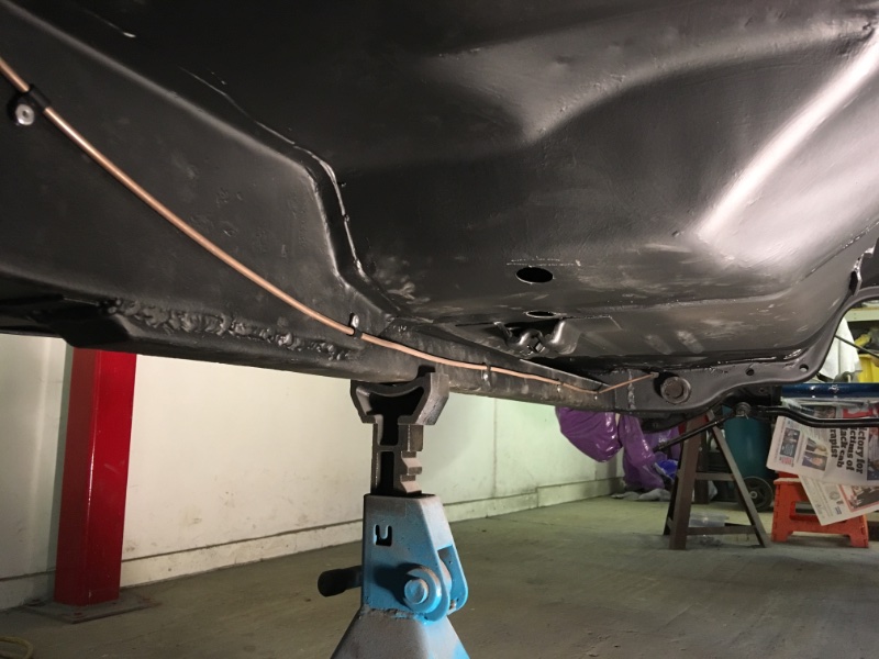

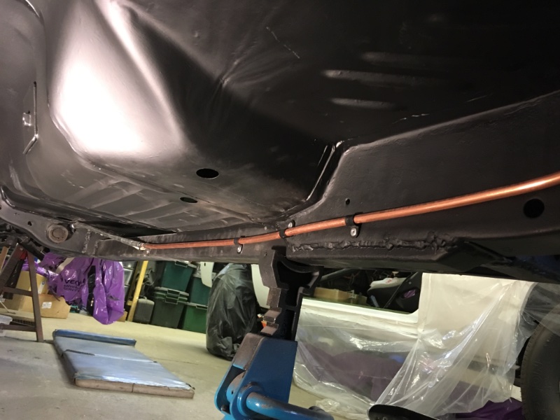

Fuel line, straight along the chassis tie to the front, bit of rubber tube around for protection where it passes through the chassis and the front section sleeved in heat sleeving where it passes the headers. Brake line runs down the other side in much the same manner.
- IMG_0128.JPG (115.15 KiB) Viewed 2672 times
- IMG_0129.JPG (139.92 KiB) Viewed 2672 times
- IMG_0130.JPG (137.13 KiB) Viewed 2672 times
- Stu
- Posts: 7205
I can’t believe how clean the underside of your car is!
That does look very much like a simpler set up.

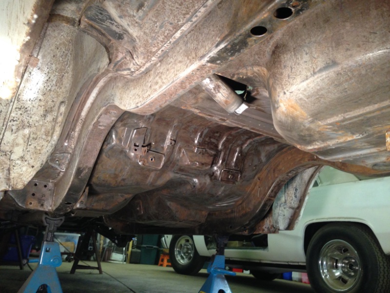

Ha, a couple of weeks of dry scraping the factory undercoating off gives you this, that's California cars for you, yours will be the same. As you can imagine its the filthiest job ever...
- IMG_3850.JPG (184.76 KiB) Viewed 2655 times
- ScottyDave
- Posts: 1687
Aye its not the most enjoyable of jobs but worth it.

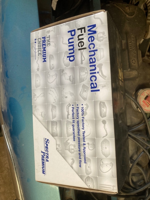

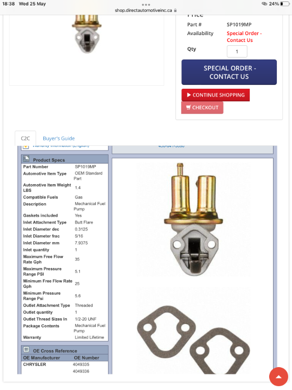

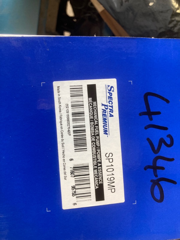

This is the pump I found, still in the box and wrapping.
To fit or not to fit, that is the question!
Just realised I didn’t check the sizes of the hose fittings, though.
- 1276CEFA-799E-4E8E-9A6E-43A6444D5E00.jpeg (141.85 KiB) Viewed 2617 times
- 2B79B591-39F8-4ADD-8C04-6970DF52DD0A.jpeg (158.68 KiB) Viewed 2617 times
2001 Dodge Ram Van
2001 Dodge Ram Van
Need to see the actual pump to advise but I suspect it will be a stock replacement with 5/16” connections.
- Stu
- Posts: 7205
Yes, pretty sure it is, but will measure up when I can get to it. Found the part number online, but doesn’t seem to say.
Suspect I just need to pick up the correct pump I need.

- Stu
- Posts: 7205
Yep!
- E513FE18-45B8-435F-B556-1D570F782302.png (230.48 KiB) Viewed 2596 times

There you go
one branded but ultimatly unbranded pump....
they probably all come out of the same mexican or chinese factory....
[or indeed south korean as the case is here, by the look of things]
you just pay more for a longer defect warranty and a nicer box when you recognise the maker...
