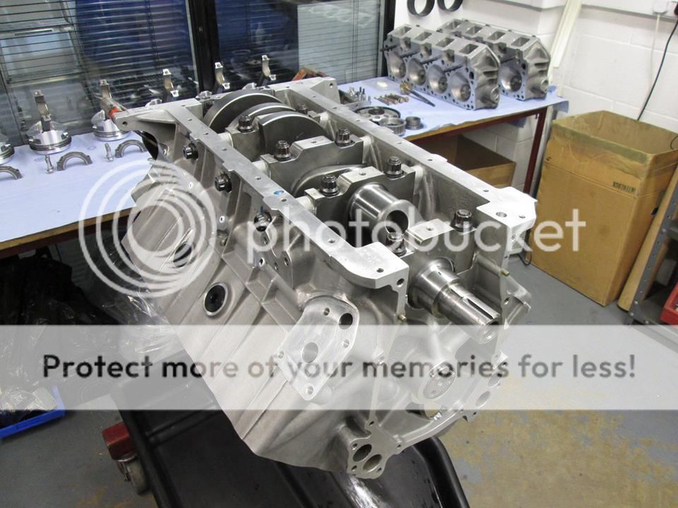

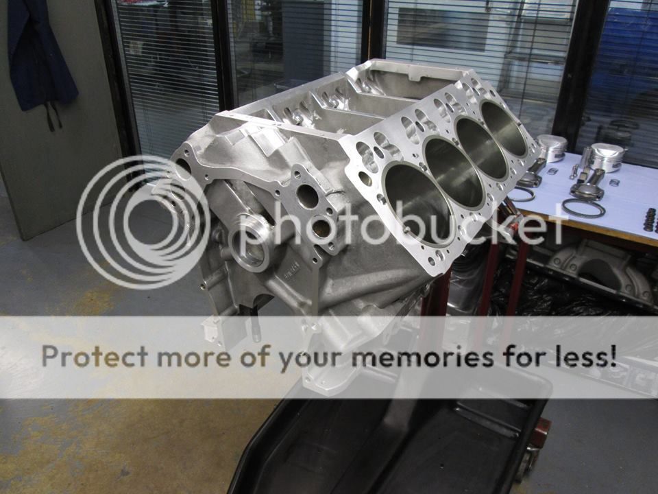

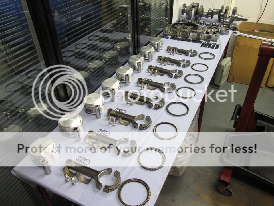

Struggled with blowing of Oil last & chasing a few red herrings... Decided to pull the motor & give it to someone who might know what the hell was going on (ICE Automotive) I cant thank Rob enough, great bloke, exceptionally knowledgeable & a big pi55 taker, so we get on well :D
Motor is getting ready for assembly after a fresh up (Hone, new pistons (higher Compression) Rings, bearings & fresh set of lifters.

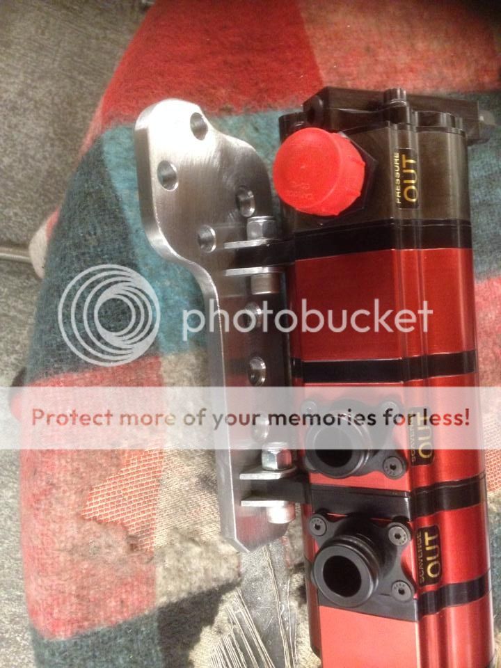

I have also switched to a dry sump system. Hope to have the motor back & in towards the end of the month.
A few other jobs completed, new front brake lines after chassis mods for the dry sump oil pump, Oil tank mounted, Pump mounted, axle stripped, checked, cleaned & painted & all back in. Also changed fuel pump...
