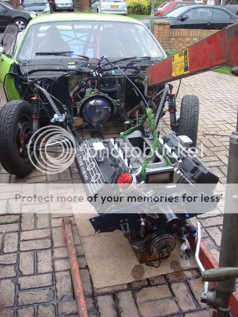

I have decided to abandon the previous Supercharged combo & switch to Twin Turbos.
Still collecting parts at the moment, some I will be hopefully collecting in the next couple of weeks, some have been delivered to home, but as usual, I'm away, so yet too see them myself.

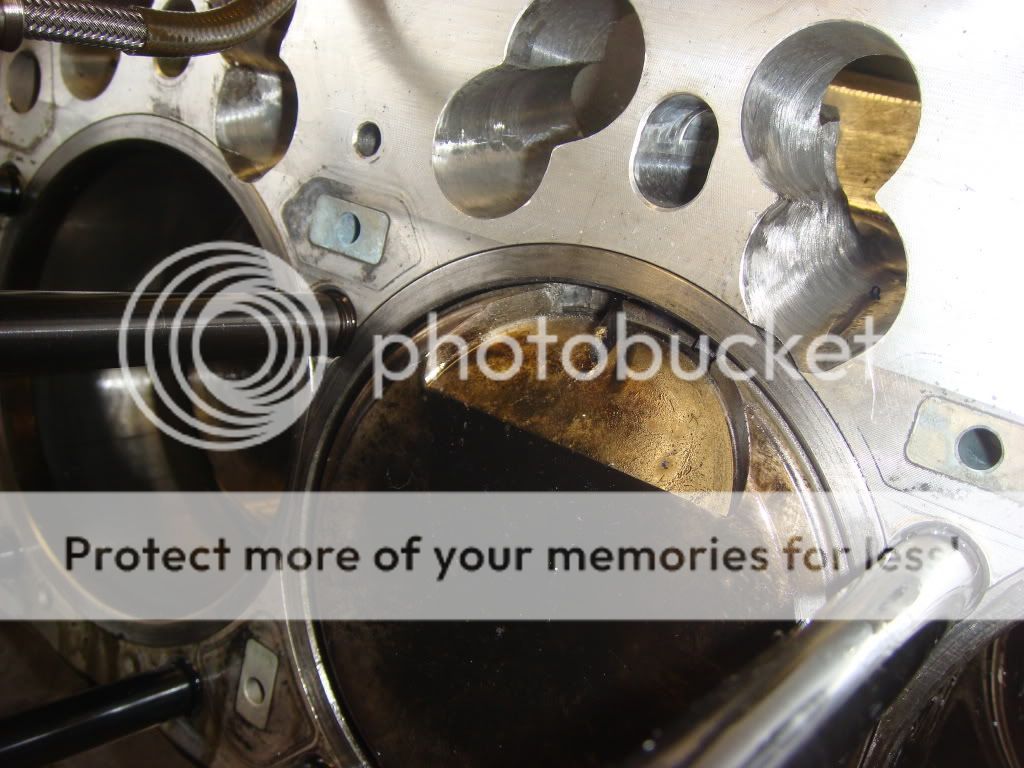

I will post a few pictures as the rebuild progresses, motor is in pieces at the moment, as waiting on new Pistons n Rings. Needed to change as I melted a few, from when I screwed up running the motor too lean :oops: Pretty luck really, could of been a lot worse.
New pistons will have the skirt area beefed upped to cope with the planned higher HP, also different ring material.(Will still need to get the A/F right though)
Still staying with EFI (Bigstuff3) although trying different injectors this time (Atomizers) & increased size to 225cc-Min/21.5Lb's/hour. Along with new inlet manifold, throttle body, cam & valve Spring change. To help keep the temps down, will also be installing Air to Water Inter cooler . . .
For what was meant to be a quick swap from Blown to Turbos, things soon escalate.
I thought the blower was a big lump, but never realised how heavy Turbos are !! my 88’s are not massive, even modified they weigh 57Lb’s each, previously 65Lb’s each.
Thats about it for now, will post a few updates as things progress

All I can remember is that the rings I was advised & specified are Nitrided tool steel.
On the basis, Turbo motors make loads of heat & therefore the need for a piston rings that can transmit heat effectively to the cylinder wall, reducing the risk overheating the piston. Stainless was not considered as it conducts considerably less heat,tendency to shrink when hot & loose tension

Are you putting oil sprays on the bottom of the pistons ? it will help cool them down a bit .
