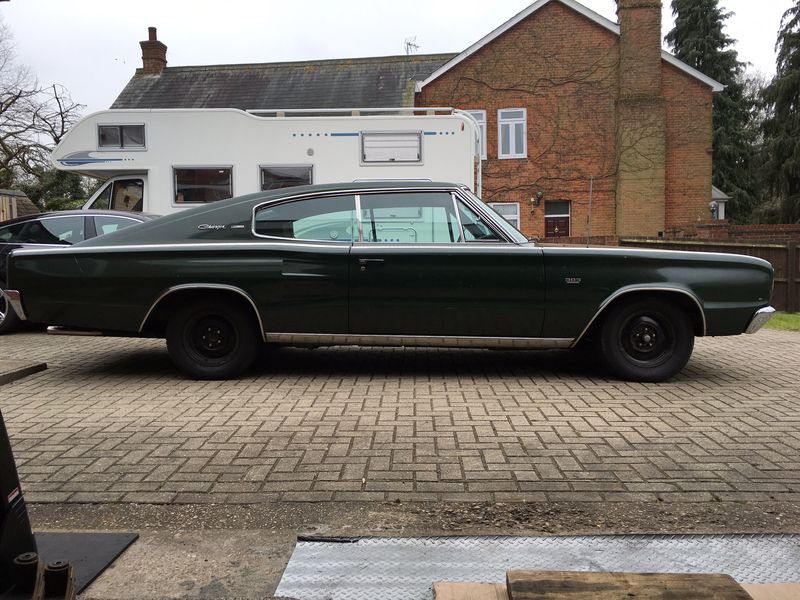

The Spring on the drivers side came off easy too, didn't have to cut a U bolt on this side!
Not really the best shot, but both are fitted. Got it on the ground and torqued everything up. Feels much stiffer when pushing down by hand.
Took it for a test run, it's about 35mm higher at the wheel arch. I can see a lot more out of the rear window other than road and it doesn't flop around going round corners. Handles great, have to say I'm very happy with them and myself for getting them fitted. I am a novice at car fixing.
Posts: 7149
Great stuff!!!! :thumbright:
Just needs some wider rubber and it'd be perfect!!!! 8-)
Posts: 9615
smashing news
it will settle a bit after couple of 100 miles
Posts: 22241
Looks a lot better, I do not really like Taildraggers.
Well done for sorting it and learning.
