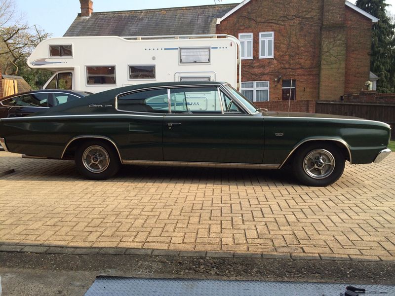

This is how the car sits, one thing I noticed when I changed the shocks is that the tyres are catching the wheel arch on the inner sides. The wheels I think have a 4 1/2" back space, so I'm thinking the weak springs are letting the wheel come too high?

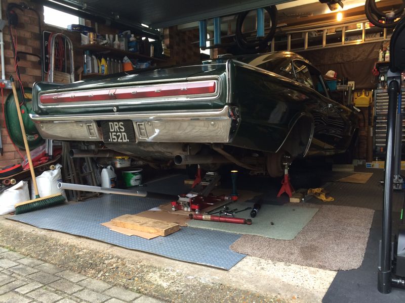

This is me doing shocks
Getting to the rear of those top bolts round the fuel tank is definitely fun!
