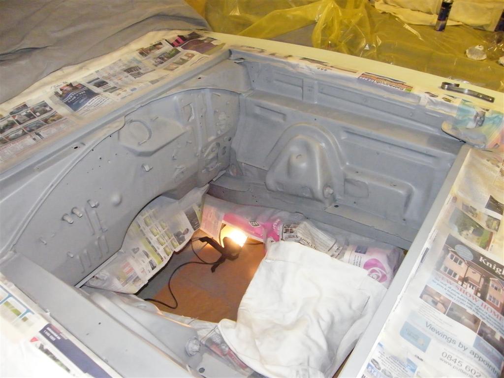

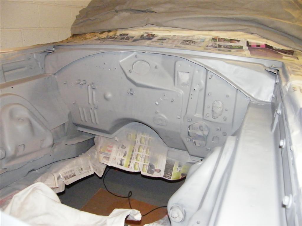

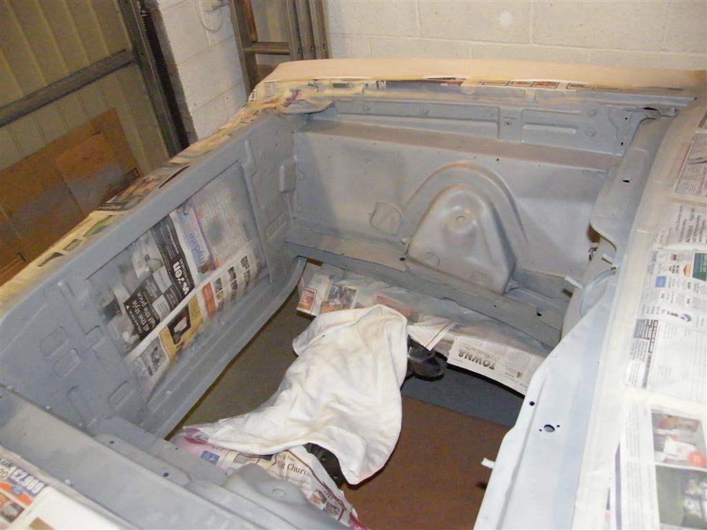

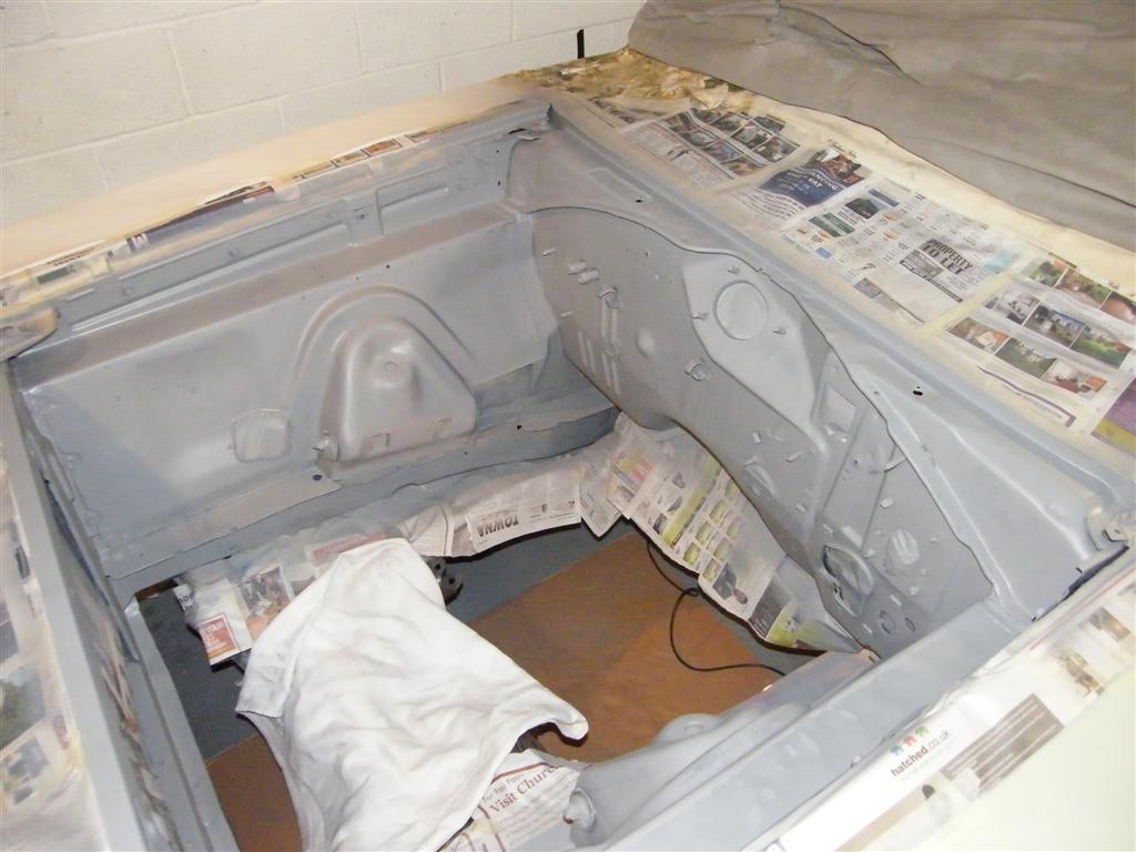

Over at Stu's again today for a couple of hours, just in time to help with final masking then a lot of can-rattling, ready for some primer!! \:D/
Yeah it's a bit amateurish, but the colour's being done by a pro so should end up ok. And it'll certainly be better than it was before :)
Pics are after the 1st coat....

Good work chaps. And no obvious crunchy/bubbly bits. That will look great when painted up - although setting the bar that high you are gonna need all new engine ancills too... :)

morgan wrote:Good work chaps. And no obvious crunchy/bubbly bits
No, nothing too crunchy or bubbly, just a bit at the bottom of the rad support. Worst bit was getting thru the 30yr old Hammerite :roll:

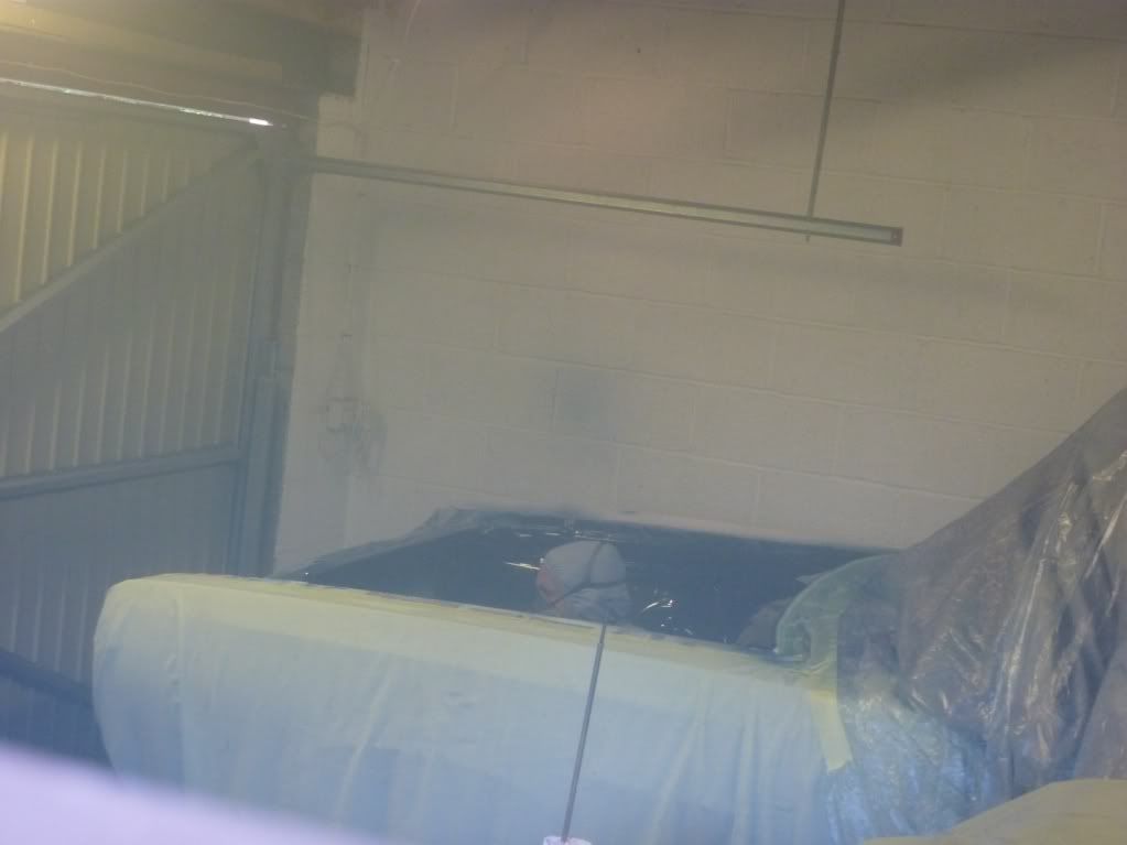

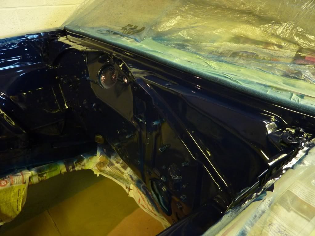

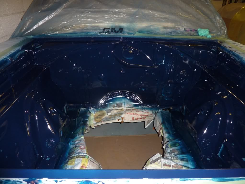

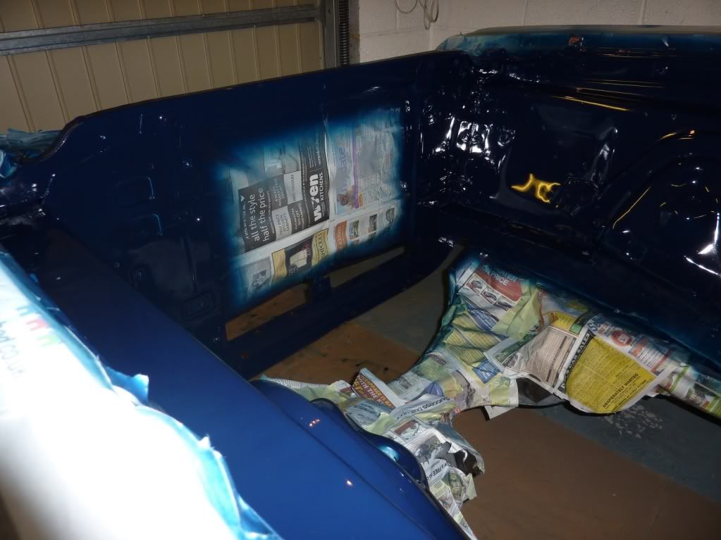

Engine bay was painted last Saturday. Cos we've still got the steering and some of the front suspension removed, we didnt want to have to trailer it somewhere, so Stu found a guy who has his own mobile dent/accident repair business, who was happy to come round and do the top coats with the car as it is, in the garage.
Cos there was no extraction, there's a few bits of fluff'n'stuff settled in the top surfaces, but they'll clean up ok with a bit of compound & elbow grease.
He will have to come back tho, as in the daylight on Sunday we saw a few thin patches, mainly on the bulkhead, so he said he'll come back and redo those.

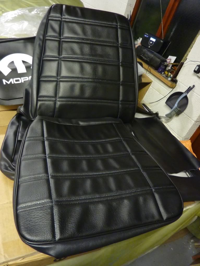

Interior bits from Legendary...
Seat covers (front & rear)
Door panels (front & rear)

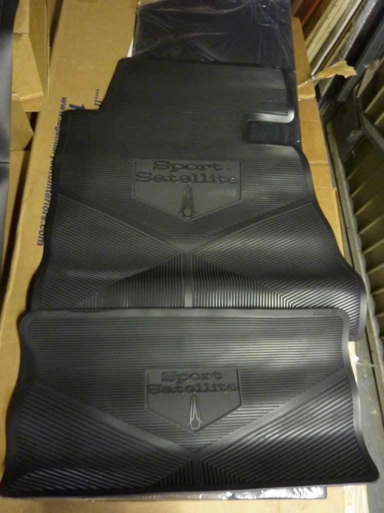

Rubber floor mats. These are the only ones we could find with the correct 69 (and not the prettier 68) logo...

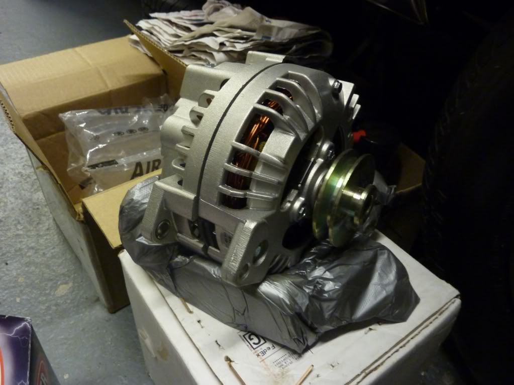

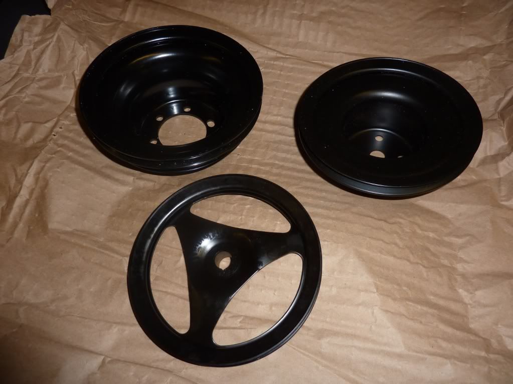

Alternator from Bouchillon...
Misc bits from Mancini & 440source....
and a few other odds'n'ends.

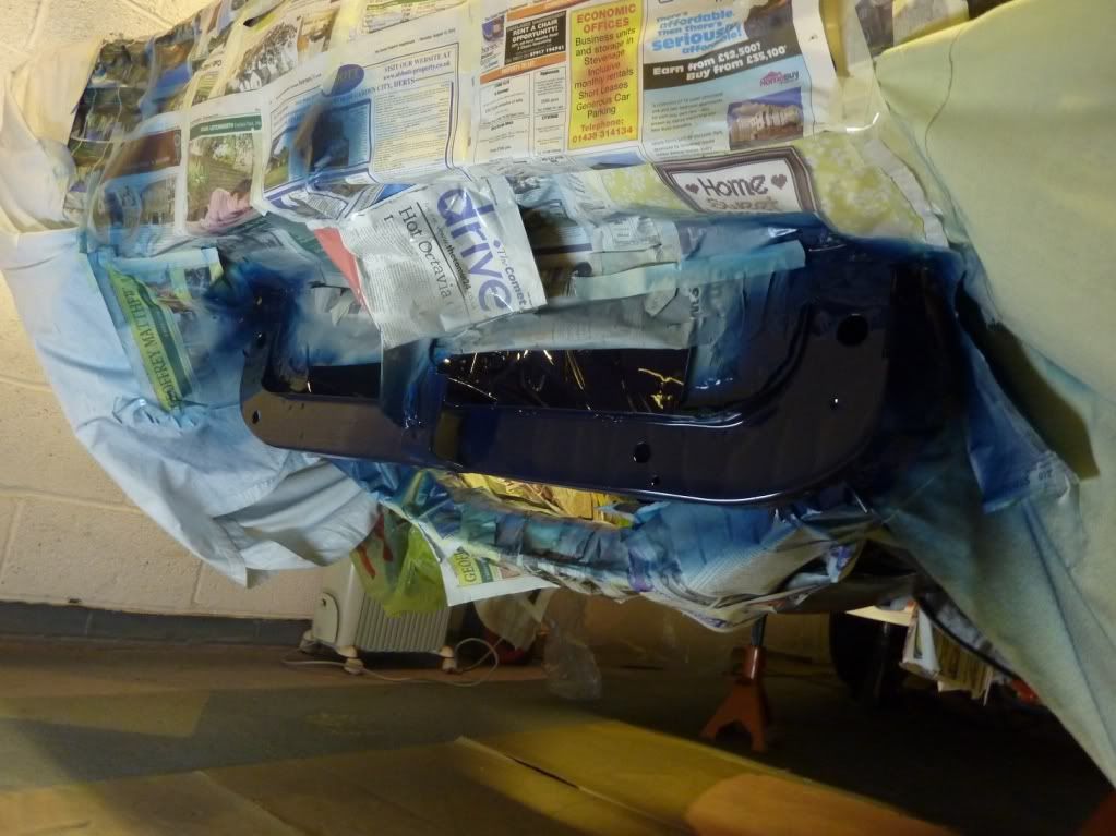

Cheap & convenient it may have been, but the engine bay paint did need a bit of a touch up once the dust had settled (literally :lol: ) and once viewed in daylight.
Trouble is, as the painter-man agreed to do the job in 2-pack, with mask etc but without extraction (his decision), he ended up a bit icky for some time after doing this job, so declined our request for him to come back to fill in the gaps :roll:
Plus, there was a fair bit of dust & overspray that had settled in the paint, but he did warn us of that. This was rectified with a bit of compound (not too much tho, as he'd left some areas a bit thin) and some additional paint from the aerosols we had made up.
He also took the hinges, battery tray and supports away to spray at his place, but these also need a bit more paint.

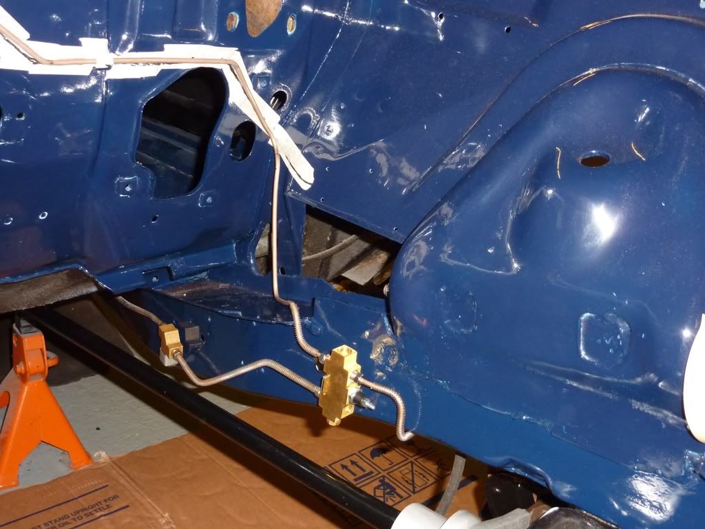

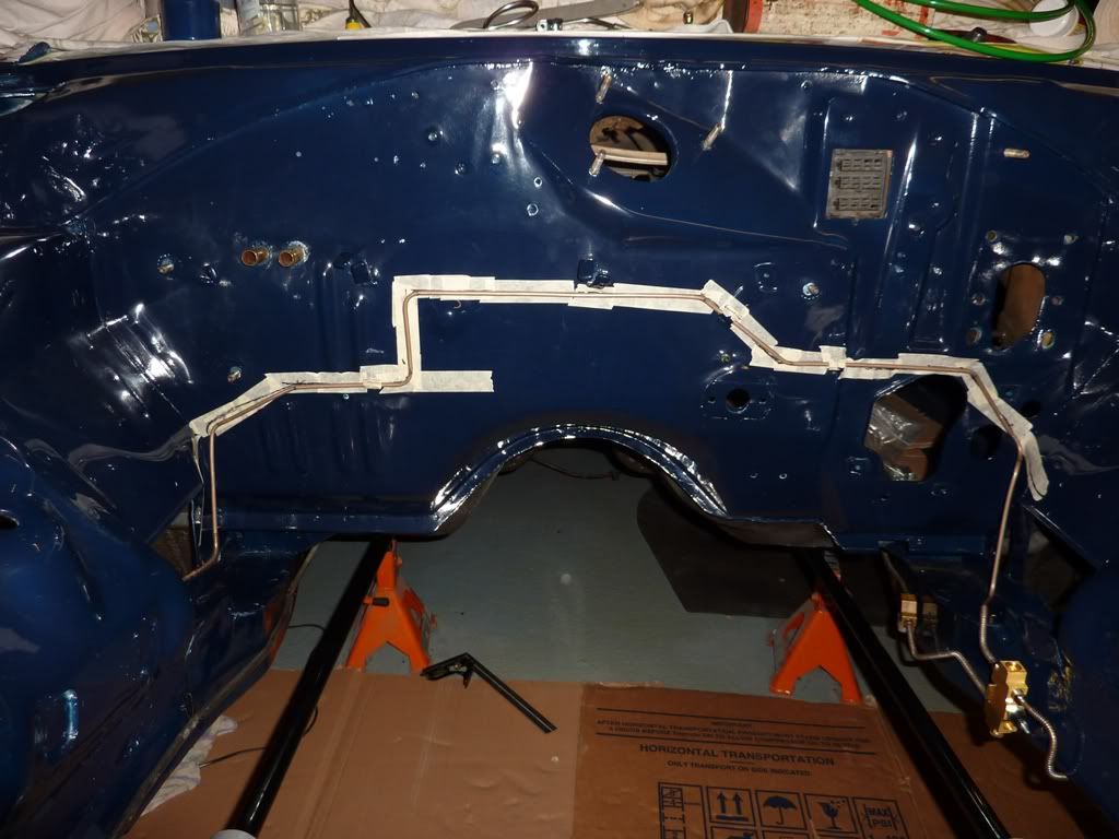

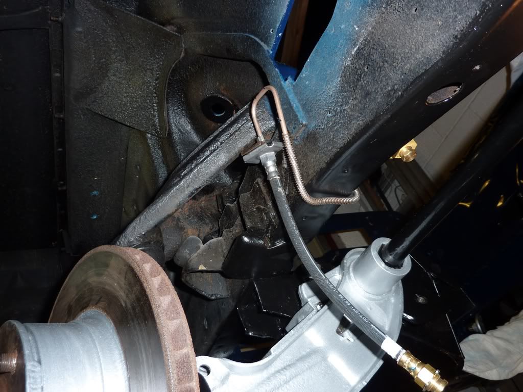

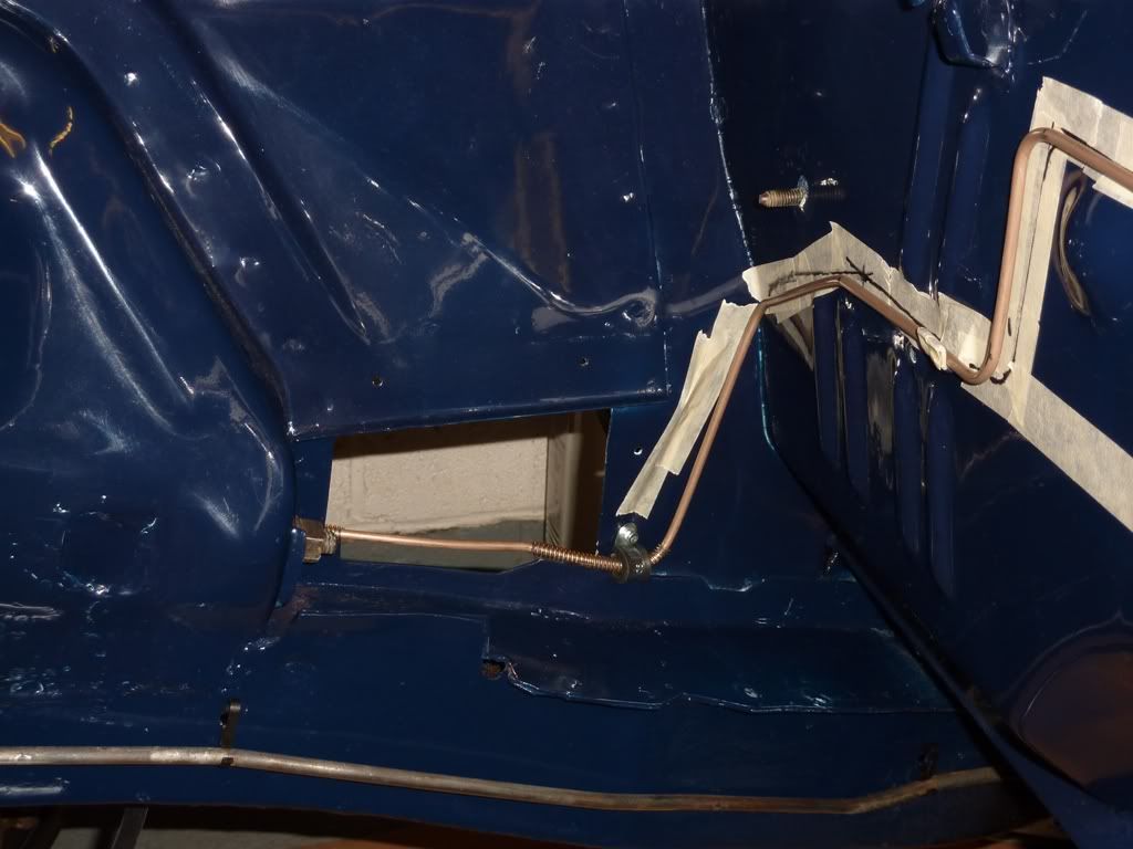

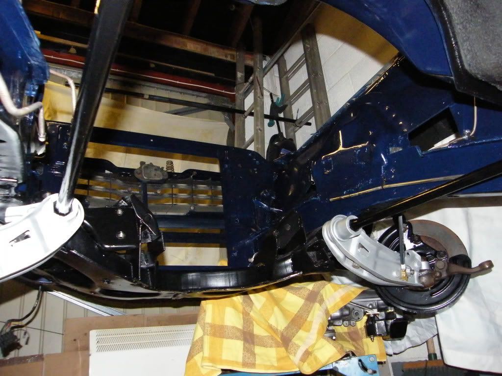

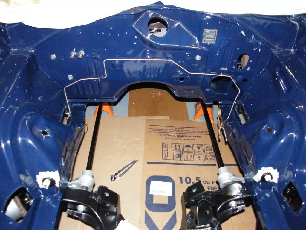

Now the engine bay has been titivated, the next job was to get the brake lines in. We bought some new bits but decided to have a go at making the long one that goes across the bulkhead ourselves (note - most references to 'we', 'our' and 'us' mean Stu :) ).
Bought a cheap(ish) flaring & bending tool at the NEC last Nov just for this, and after a few failed attempts at getting the flares straight, ended up borrowing Blue's proper kit. Thanks Blue :thumbright:
Not bad for a first attempt - well done that man :thumbright: (the masking tape was used as a guide to get the shape)
and hey presto, with tape removed....
'We' used various pics of original, or near original spec restos to get the route and bends correct, so followed them where poss, but found that the original pipe was routed diagonally across the 2x access holes in the inner wings, so re-routed it around those holes. Still got to finish painting the brake booster, so will get the other lines finished when that and the master cylinder are back on.

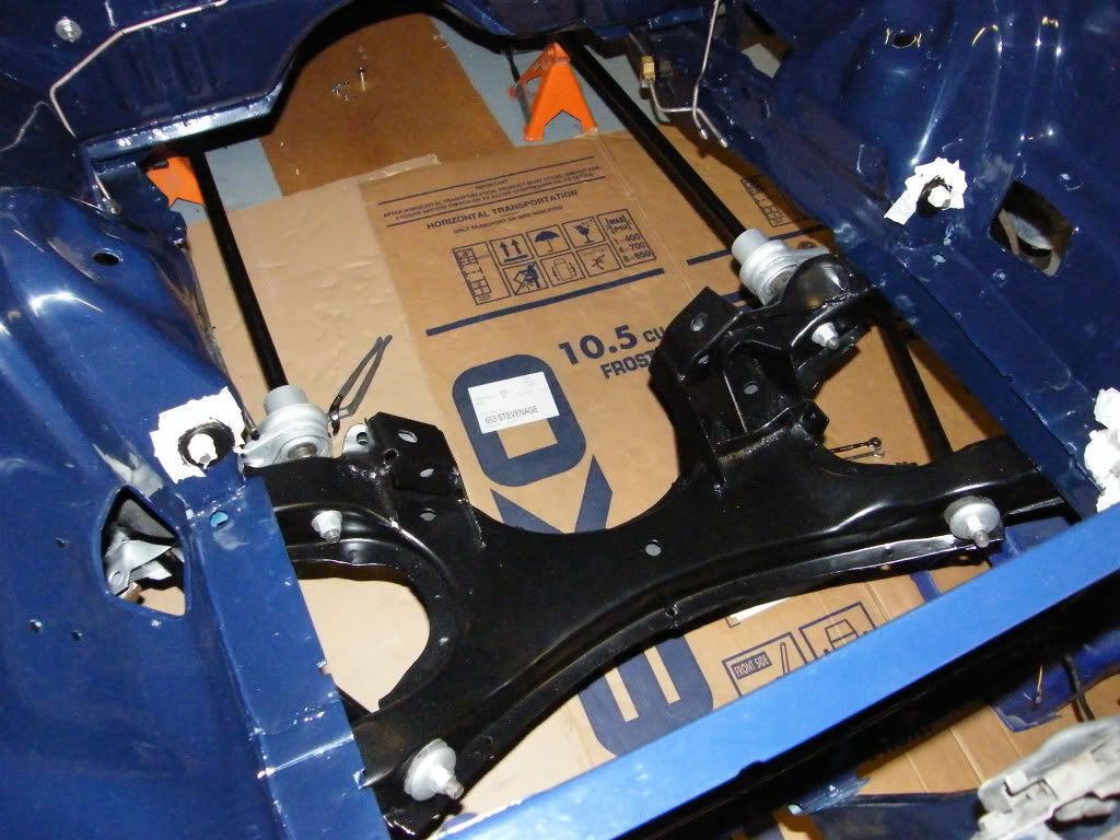

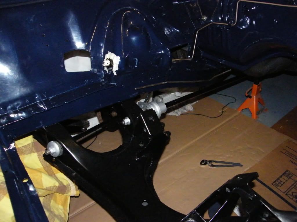

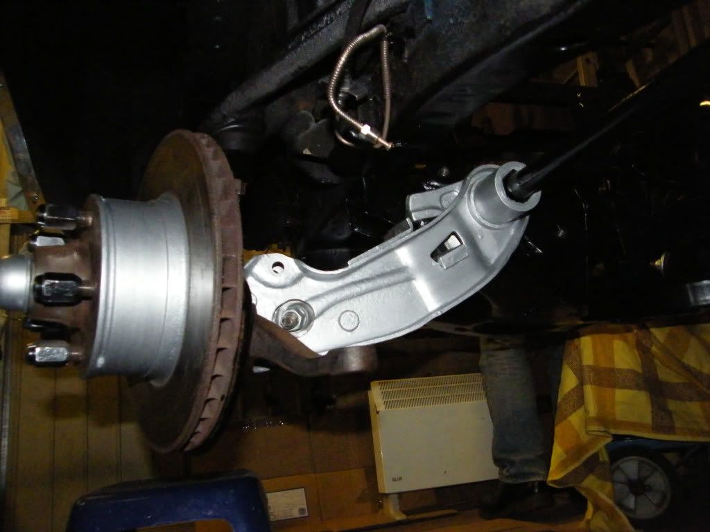

We've also given the front suspension a fresh lick of paint. Could have gone the replating route, but didnt completely disassemble the front end, so decided just to go with paint. Some parts are still to be replaced with new, so havent painted them (hence the rusty bits still fitted ;) ).

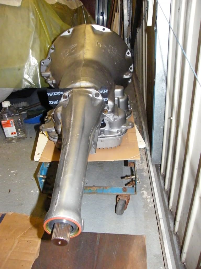

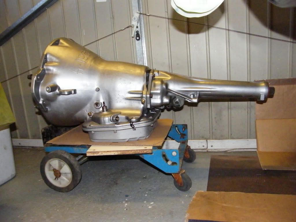

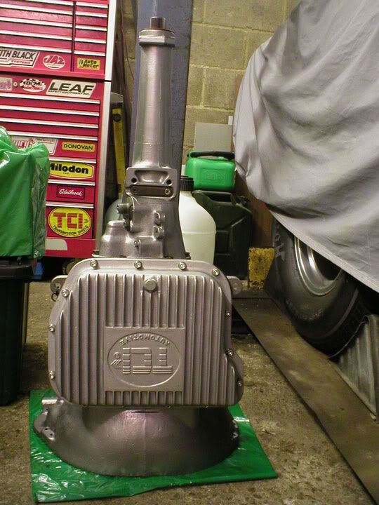

Rebuilt spic'n'span trans, courtesy of that man Blue again :salute:
