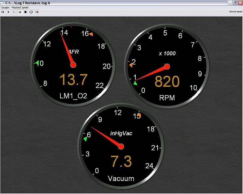

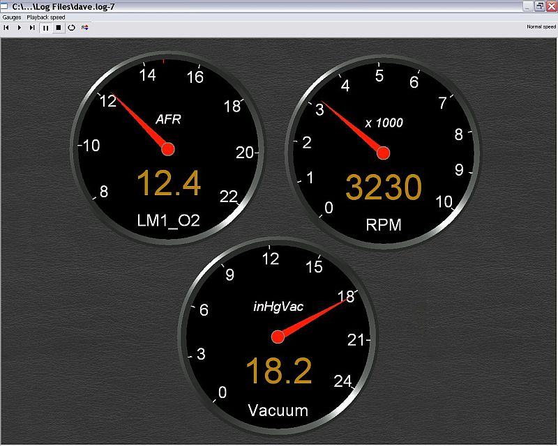

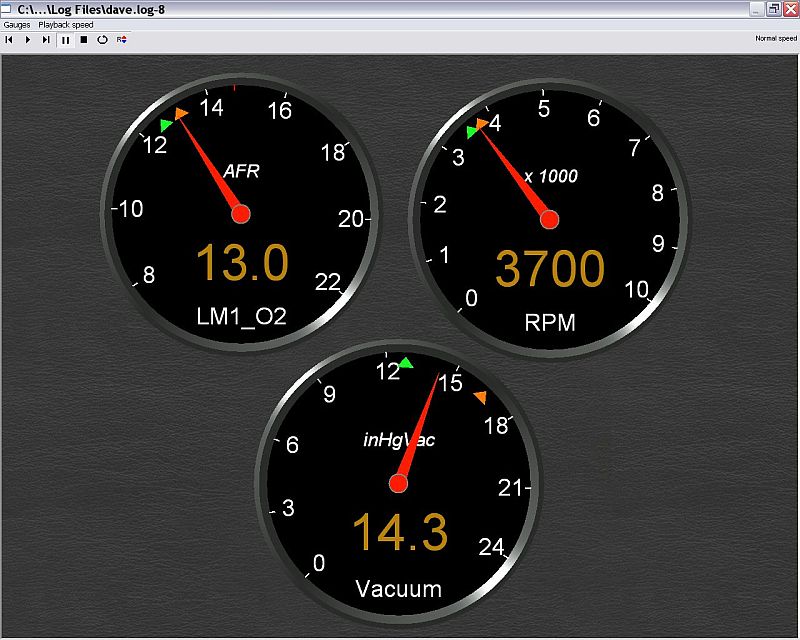

I also fitted a 6.5 inch power valve, went up one jet size on the center carb to #65s, and increased the idle mixture a bit.
The car now idles stronger but is a bit too rich (12.4:1) until 3500rpm. So I think I need to go down one jet size again and open up the outer carb jets a touch more.

Idle in gear (and out in traffic) vacuum sometimes goes down from 8" to 7" too. That 6.5 inch power valve might be too close a rating?
