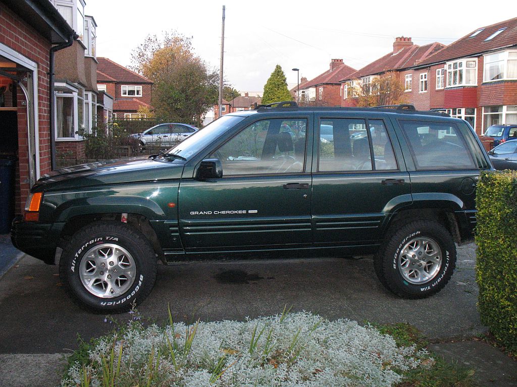

I did actually try them but they don't do the BFGs.
The size I wanted was 245/70/16 but they have been impossible to find anywhere. So I have had to settle for some 255/70/16s my local ATS garage has managed to locate as two pairs in two different parts of the country.
I hope they fit without rubbing on anything.
The size on there now are 225/70/16 but the speedo reads really fast and these bigger tyres should sort that out as well as giving me about 6% better milage.

I know I ask alot of dumb questions but I dont understand how Tyres that have the same hight will affect the speedo? Also, how does wider Tyres give better milage than skinnier ones? Surely with the bigger contact area you will get more friction?
Yes you doTrigger_Andy wrote:I know I ask alot of dumb questions but I dont understand how Tyres that have the same hight will affect the speedo? Also, how does wider Tyres give better milage than skinnier ones? Surely with the bigger contact area you will get more friction?
Tyres the same height wont effect you economy, but a 255/70/16 aint the same height as 245/70/16 , the '70' is the aspect ratio width to height, not the height itself

The current 225s are 28 inches diameter. Less than that because they are so worn. The 255s are 30 inches diameter.
6% difference in speed per rpm.
Yes wider = more rolling resistance. But with full time 4 wheel drive it don't add up to much. Also 6% better mileage is only 1mpg around town. Maybe 1.5mpg on a run.
I may be a bit dim these days but i can still do sums.

Andyrob is correct (of course). The aspect ratio is the sidewall height as a percentage of width. On a 70 series tyre the sidewall height is 70% of the tyre width.Trigger_Andy wrote:I know I ask alot of dumb questions but I dont understand how Tyres that have the same hight will affect the speedo?
My Challenger tyres are a good example of how to play around with that. i wanted the tyres on the front to be the same diameter as the tyres on the rear.
So I fitted 245/60/15s to the front and 295/50/15s to the rear. So they are near as dammit the same diameter.
