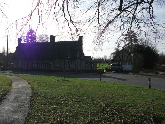

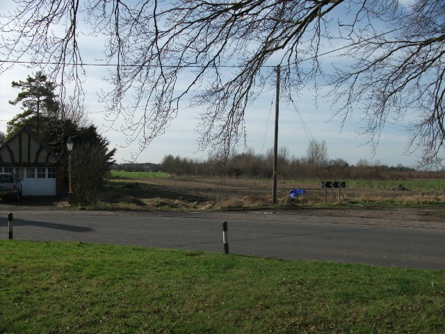

The House sits on the roadside in a small village. The front is north facing to the road, and the land to the right is where they are now going to build 8 affordable homes.....
...and this is where they are building to enhance the community....
Cottage 4.jpg (149.53 KiB) Viewed 2040 times
Shows the drive and garage, there is another access to the other side of the cottage
Cottage 3.jpg (144.19 KiB) Viewed 2040 times

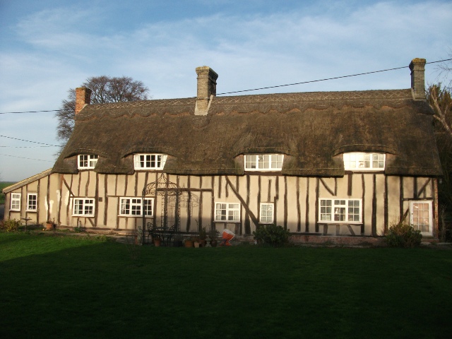

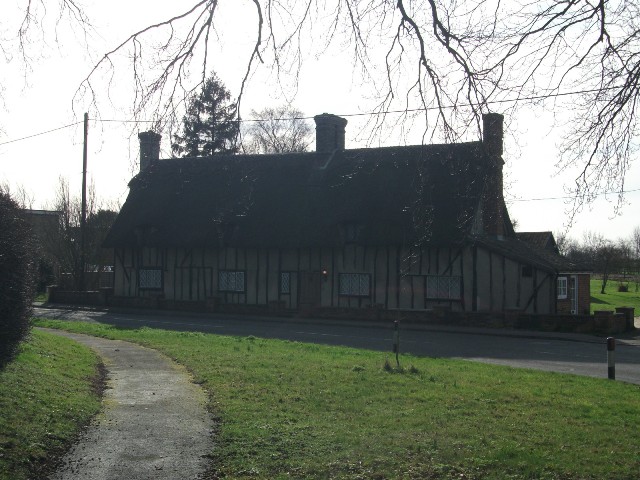

Clearly the front of the cottage....
Cleaning up the Beams 02-2011 009.JPG (125.31 KiB) Viewed 2040 times

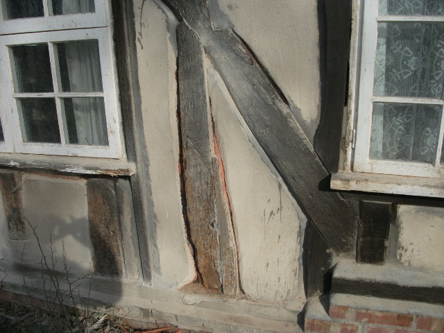

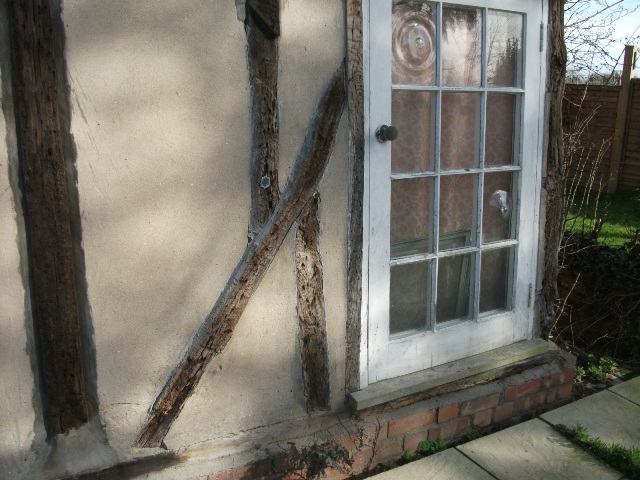

The back of the cottage clearly lays due south, which is nice from a sun-bathing perspective, but the bleaching sun has taken a heavy toll on the wooden beams.
The previous owner partially rendered over the beams and this has created problems, as the water has got trapped and consequently made the beams rot. This situation is the case across all the rear of the cottage.
This is where I got some advice from that Mopar-loving Dave Dick, who is a master carpenter and is used to working on old buildings.
He explained that I needed to undercut all the rendering, scrape all the beams by hand with a chisel to remove the oxidised wood (and in this case bark!!!), then stain and treat the wood, before re-pointing; and at some point paint the house......smashing :roll:

Some beams are clearly worse than others.....

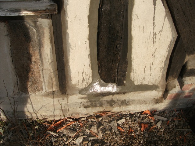

An example of the beams cut back to reveal the orange "period" Royston Fertilizer Company plasic bags used for insulation....
Cottage 5.jpg (142.27 KiB) Viewed 2023 times

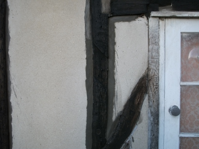

Here the re-pointing has been completed......
cottage 9.jpg (146.28 KiB) Viewed 2013 times

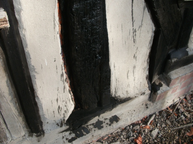

Here the wood is now staine and treated, some sort of progress...........
cottage 8.jpg (162.16 KiB) Viewed 2013 times

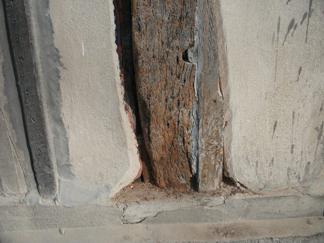

You can see how the render has been cut back and the wood taken back to solid material ready for back-filling
cottage 7.jpg (134.02 KiB) Viewed 2013 times

This has been a bit of a Chinese puzzle in that you have to work out the sequence for cutting back the rendering so that whole slabs of render does not detach itself.

Area near one of the doors, which typically needs replacing.............
cottage 10.jpg (158.61 KiB) Viewed 2011 times

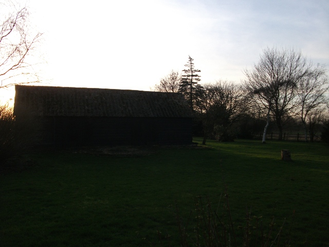

Lastly, I include a shot of the barn...it's about 36 feet long with 4 toilets (one for each family) and again I can't touch it without permission. Roydon has helped me restore this, he has been a great help...
Quaint Barn - feather edged boarded
Cottage 11.jpg (127.87 KiB) Viewed 2007 times
