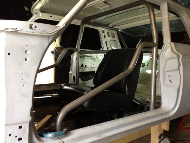

Hey contact me @ chassis Tec race cars on fb or message me on here can supplie you all the tube in correct sizes ect if you looking to tag you can either go for 9.99or 8.50.
As mark says follow the rules for each spec and you know it will be safe.
Also 1.5mm wall is not legal or safe especially when increasing o/Dover 1.50 inch.
Ignor the msa blue book for drag racing specs it's different.
Please contact me for any help info specs sizes ect, here to help.
