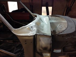

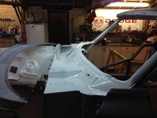

Here are a couple of photos of when I cut my scuttle panel out which you've done & mines a '69 B Body but this may help.
Shaun 'Moparless' Senior
MMA Club Chairman
LesClark65

Cheers for those pics. I'm hoping to tackle this in the next couple of weeks and I think the hood, fenders and upper cowl are coming off.
