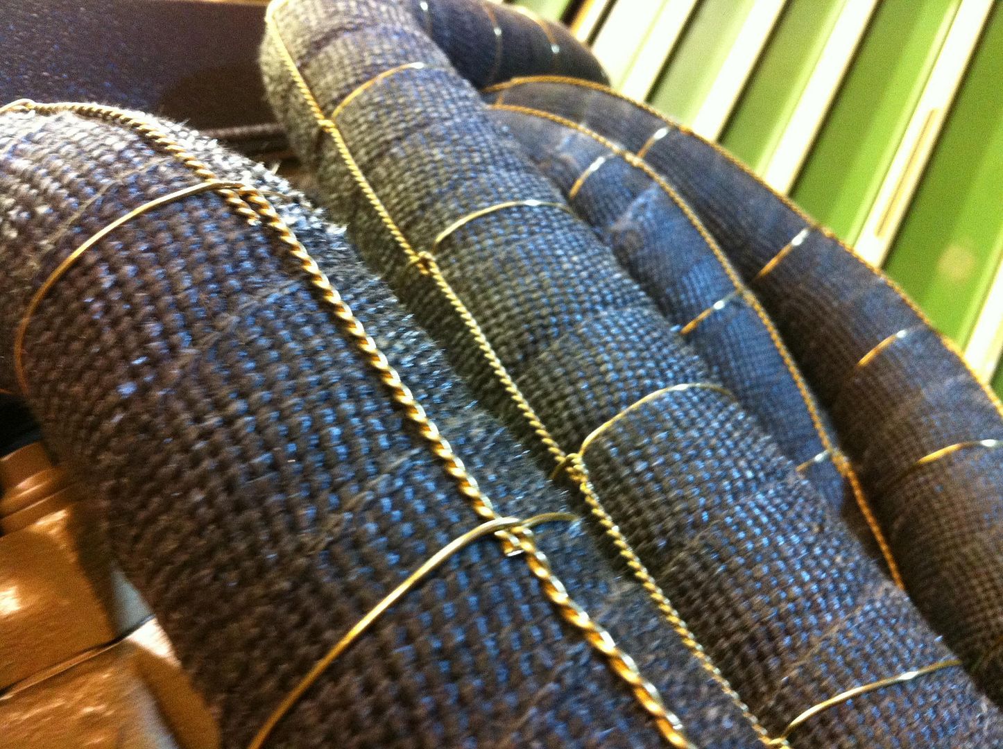

- autofetish
- Posts: 5599

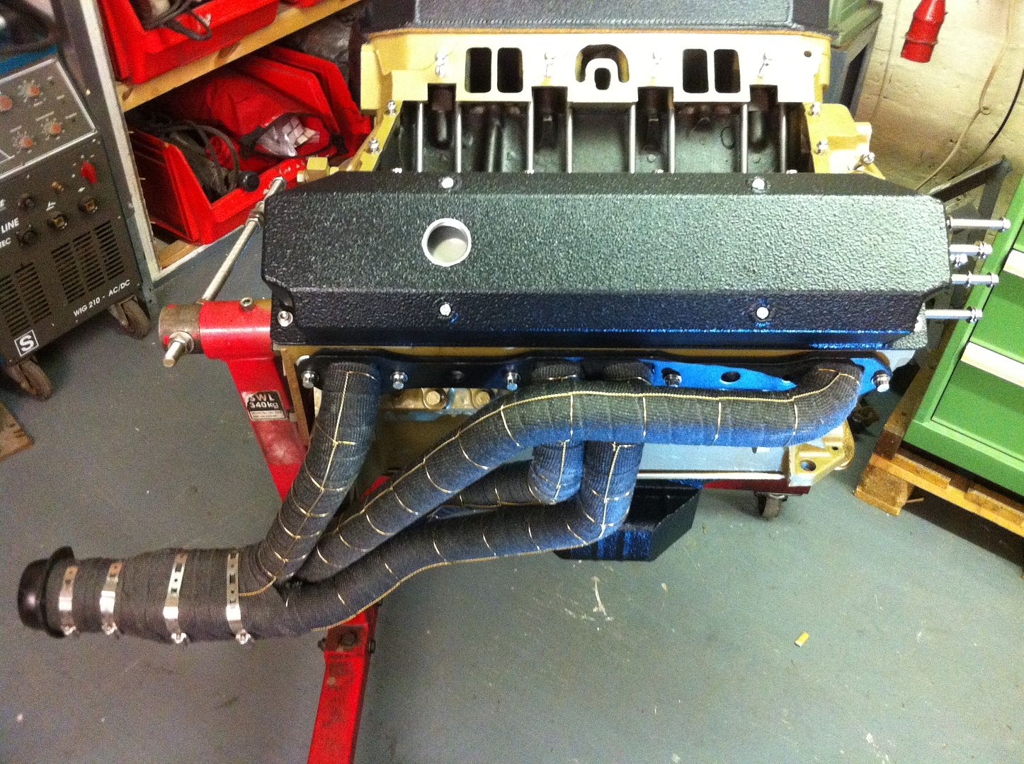

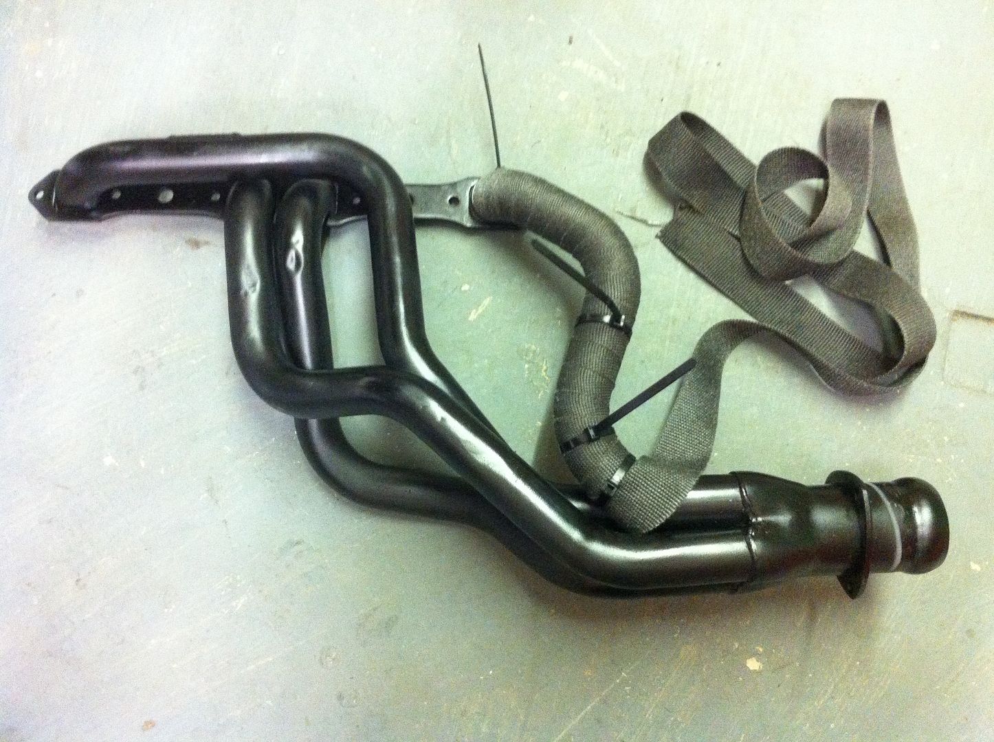

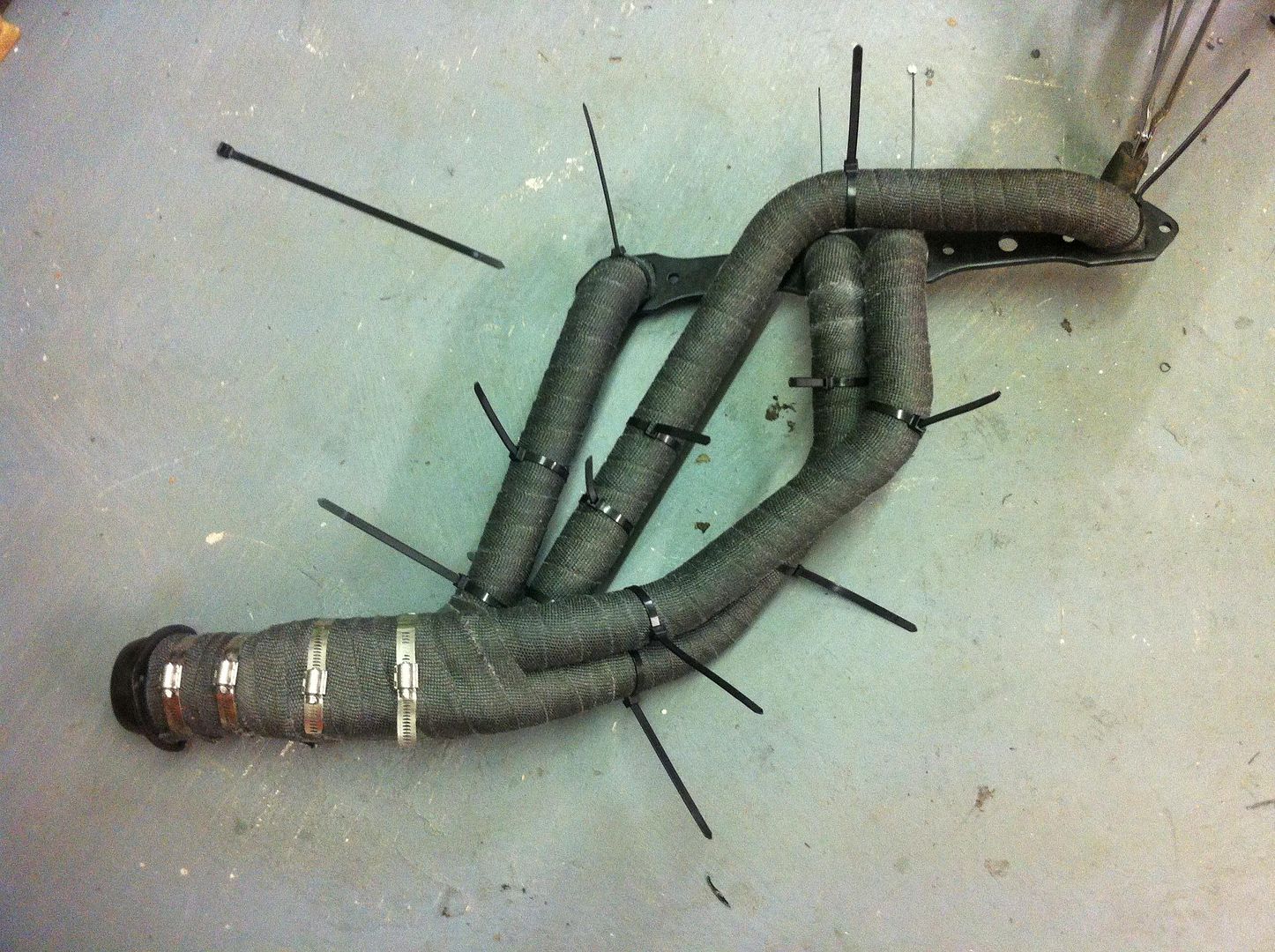

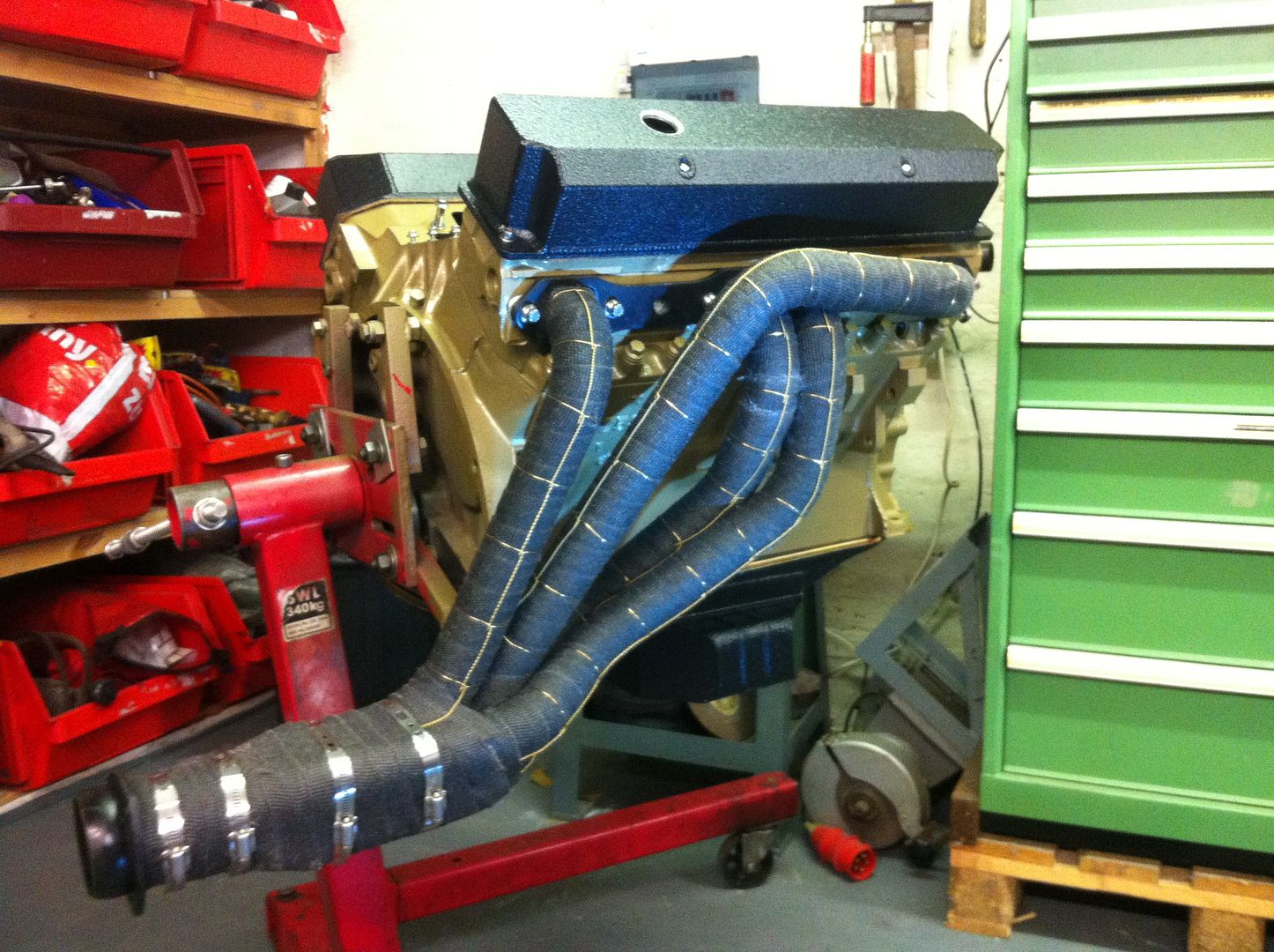

I would listen to the above about timing etc
These cars ran in California!!!!
Wrapping steel headers there are going to rust Fact
Also if you had a fuel leak there a massive sponge and Fire hazard waiting to happen
If you don't do them tight they will tea bag and look crap
The trick is to do then wet buy soaking the wrap for a few hours in bucket of water. Then wrap them wet.
When dry they will shrink.
Also wire then at close intervals
They will use double the wrap you thought you needed and take 4x as long
Also if new build trial fit first as I had to drink a few Stella and knock my about abit starter motor / Power steering
<a href="http://photobucket.com/" target="_blank"><img src="http://i73.photobucket.com/albums/i205/ ... 567b84.jpg" border="0" alt=" photo IMG_1148_zps77567b84.jpg"></a>
<a href="http://photobucket.com/" target="_blank"><img src="http://i73.photobucket.com/albums/i205/ ... f9d16c.jpg" border="0" alt=" photo IMG_1150_zps08f9d16c.jpg"></a>
<a href="http://photobucket.com/" target="_blank"><img src="http://i73.photobucket.com/albums/i205/ ... ecb85e.jpg" border="0" alt=" photo IMG_1181_zpsb7ecb85e.jpg"></a>
<a href="http://photobucket.com/" target="_blank"><img src="http://i73.photobucket.com/albums/i205/ ... c829b8.jpg" border="0" alt=" photo IMG_1178_zps44c829b8.jpg"></a>
<a href="http://photobucket.com/" target="_blank"><img src="http://i73.photobucket.com/albums/i205/ ... 0ad660.jpg" border="0" alt=" photo IMG_1251_zps290ad660.jpg"></a>
<a href="http://photobucket.com/" target="_blank"><img src="http://i73.photobucket.com/albums/i205/ ... d8a63b.jpg" border="0" alt=" photo IMG_1255_zps64d8a63b.jpg"></a>
<a href="http://photobucket.com/" target="_blank"><img src="http://i73.photobucket.com/albums/i205/ ... 82884f.jpg" border="0" alt=" photo IMG_1258_zps1f82884f.jpg"></a>

- Rogue Trooper
- Posts: 1792
- Joined: Wed Feb 01, 06 8:19 pm
Fantastic wire job on those headers Autofetish wow!!!
As for headers cracking early on after wrapping, not all headers are built equal!!
Cheap headers are made with thin walled tubes to start with so you get what you pay for and wrapping them will end there life early!!!
