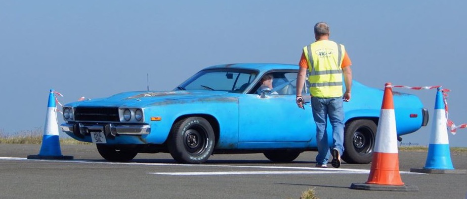

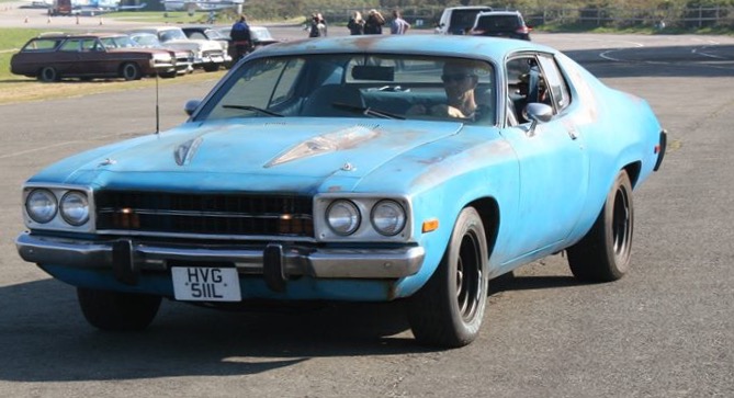

Ive got 235s on an old set of unused 6" rims and they bulge out all over the place. I also have 235 on my current 7" steels and even there you can see a slight bulge.
I hate tyre squeal and prefer tyres that are correct fit. On my rear 15x8 8 have 255s and they sit just right.

These are wheel vintiques steels
