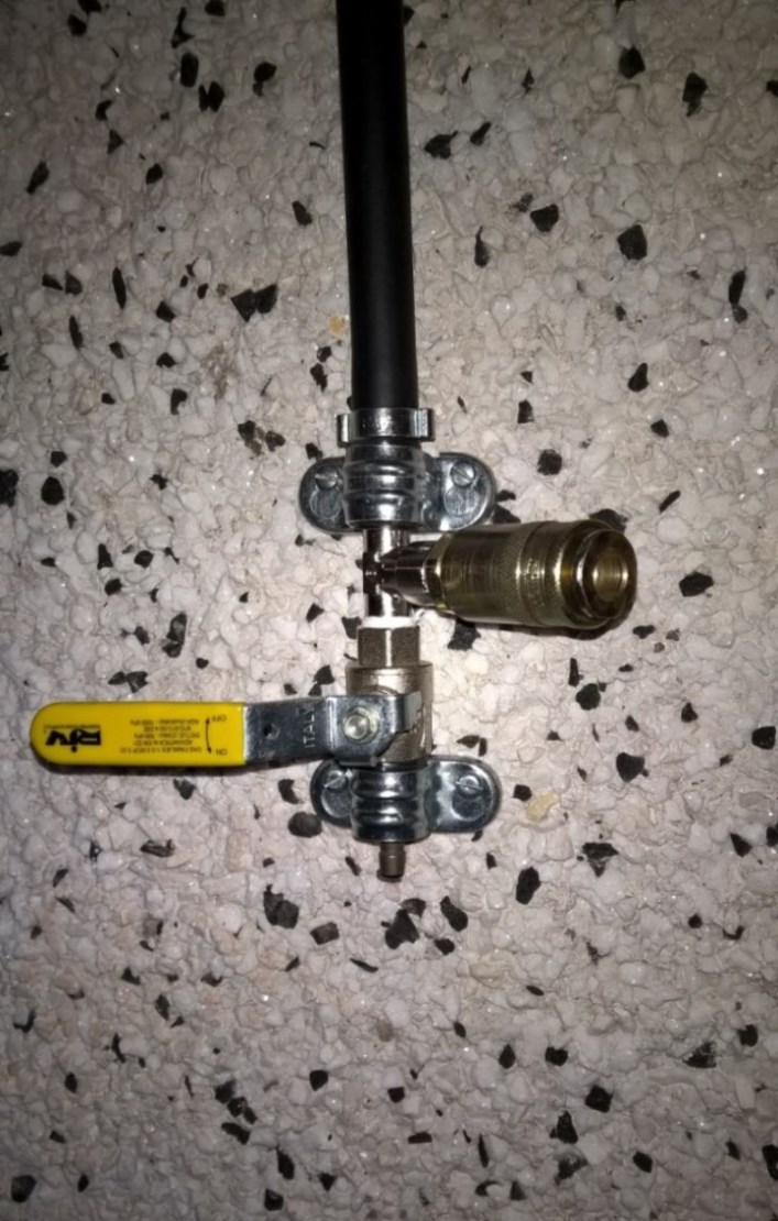

I bought all the bits today, got a 10mm bore pipe and hi-flow fittings. I'm running a line upstairs too (garage not house!). I'll use the ball valve as a condensate drain at the end.
Fingers crossed for a dry day tomorrow to run it across the house wall...

80ft your gunna lose some pressure at the buisness end
Have you not considered getging a portable size on wheels petrol driven saves laying out Cable...just a thought

You won't lose pressure, just volume or cfm, it will be fine for inflating tyres etc but you might struggle if you want to paint anything.
The bigger pipe should help hopefully?
As you say it's mainly for tyres but occasionally I need to hit the Truk with some serious tools and that lives on the road these days, a LONG way from the garage :? Though there's no danger of me spraying it ever ;)

Is there any mileage in a halfway house solution like running rubber tube through some thin plastic tube? Something like 1 inch waste pipe... It'd keep it out of the elements and away from the UV.
Just a thought?

You could always put another air tank in the workshop, that would give you the volume to run high demand things like impact guns & the compressor could just play catch up.
