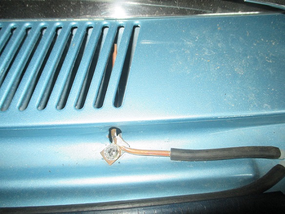

I make my own jets from copper brake pipe,carefully pinching the end to get the two jets,bend pipe to pattern and make a mount like original and solder on. Hard to get repro jets.

latil wrote:I make my own jets from copper brake pipe,carefully pinching the end to get the two jets,bend pipe to pattern and make a mount like original and solder on. Hard to get repro jets.
WHOOOOA !!!!! Come again ? You make these ?
I'm gonna have to "up" my game here ! And then you solder the mount to the piping ?
Cockin' Nora my learning curve just got steep ....... pictures on a postcard please !
Seriously though, you both are soooo matter-of-fact about this, a picture or two would be appreciated
My car had one missing and I did the same, made one out of brake pipe. I've recently fitted new ones, they came with a new washer bottle and motor. Not sure where I got it from but I think it was ebay.

Made these in about 1/2 hour for mot.
1965 Belvedere 2 426 Wedge.

Post by Garp »
Got ya ! Easy once you see it in a picture.

I hear ya ! - but the kick in the nuts is that the postage to the UK is high ! Hence me scrounging a suitable replacement in my local "scrappy"
That white "butterfly" T shaped jet is the thingy I need however .....

Everything's £30 + postage from the US now. That plastic butterfly is just the T piece,any factor or Halfords should have something to do the job.
