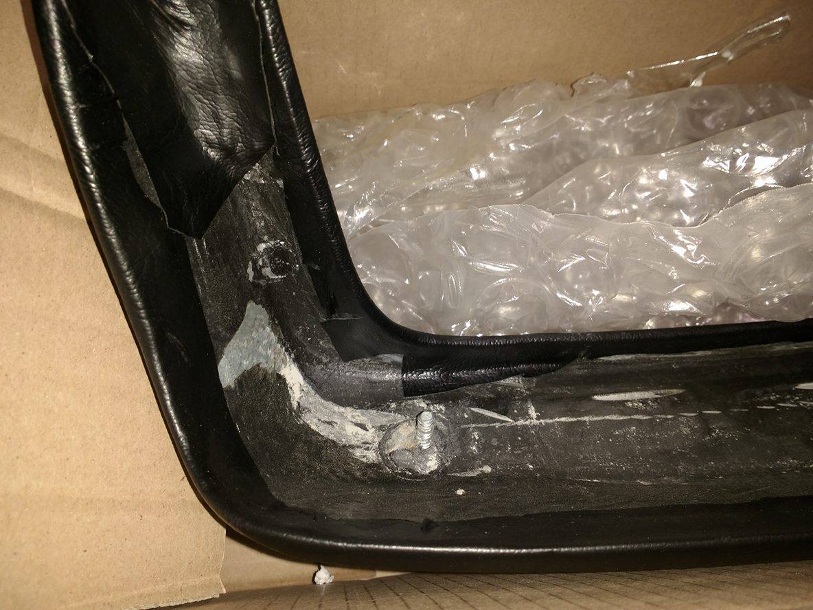

Cheers guys, when you talk about the 'ends' do you mean the parts of the pad that slope downwards either end? Because i dont have anything there, they only run across the top of the pad. Ill get a picture
ChrisN34
Posts: 337
Location: Weston Super Mare
Post by ChrisN34 »
Pic

Posts: 9611
yeah something I leaned in Oz the hard way
my pad wasn't bolted down at all and was Mint
bolted it all down after a bit of gauge cluster repair, few weeks later took it 20 miles inland (much hotter than at the coast) to get the gearbox rebuilt
it sat in the sun in a yard for 3 days
dash pad split in about 1000000000 places
asked the bloke what he did. As in what the !!!!! did you do
he said nuffin but have you recently had the pad out
I said yes
he said did you bolt down the ends
I said yes
he said that's your problem.
do up the two in the middle only it will stay put
heat UV anything that causes it to stretch will end up in cracks eventually
hence after $150 purchase of a spare and $350 re skin and my pocket lighter
I just do up the middle :)
the sun here in the UK can split a windscreen top to bottom from a tiny stone chip so I'm guessing it will have ya dash pad at some point in the next 40 years :)
