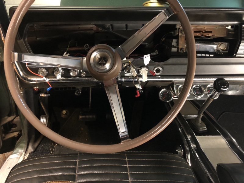

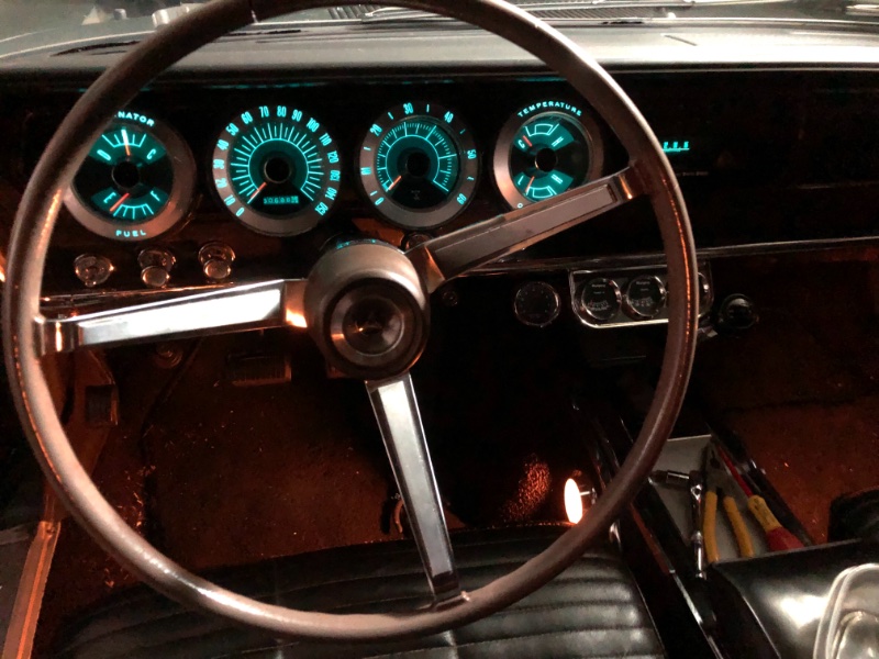

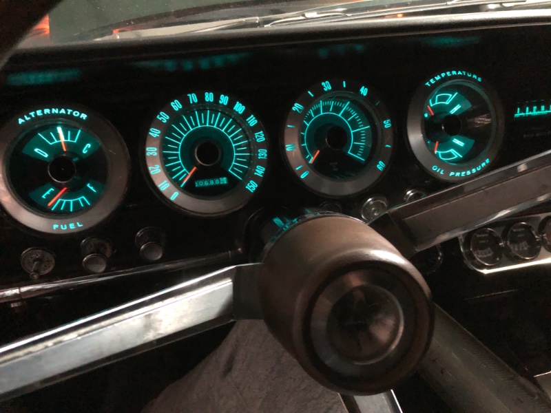

One of the cool features of a 66/67 Charger is the gauge cluster and the electroluminescence. The problem is they (and the headlight motor system) are problematic. By today I've had this out a few times and you get the hang of it. How the system works is 12v goes to a transformer which is behind the glove box. 250v a.c. Comes out, not the best idea to touch or lick this! And goes to the gauges, radio (all I have), auto gear selector and clock. If any one part, there's 12 in the cluster alone, shorts it shuts the lot down. You can isolate the faulty bit and then still have lights. I have two needles that need to be fixed, but no bother for now.
A guy in the US is making modern versions of the transformer which don't run hot, so I got one while I could.

That picture of the gauges lit up on the fender is brilliant , they look really good we never did get them working in the one we had, the modern transformer sounds like a good idea.

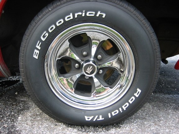

These are keystone klassics , I would use 15x8 with 275/60/15 & 15x7 with 225/70/15 ( this is my usual standard answer for all muscle cars :lol: )
Cragars or magnums would look good as well :thumbright:
