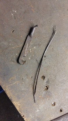

Well the problem turned out to be easily explained once I took off the drum from the noisy side and found these two pieces grinding around inside. Its the cable that attaches to the self adjusting rachet mechanism.... and the diff had plenty of oil in it as well....... mystery solved... Anyone got a spare cable ?

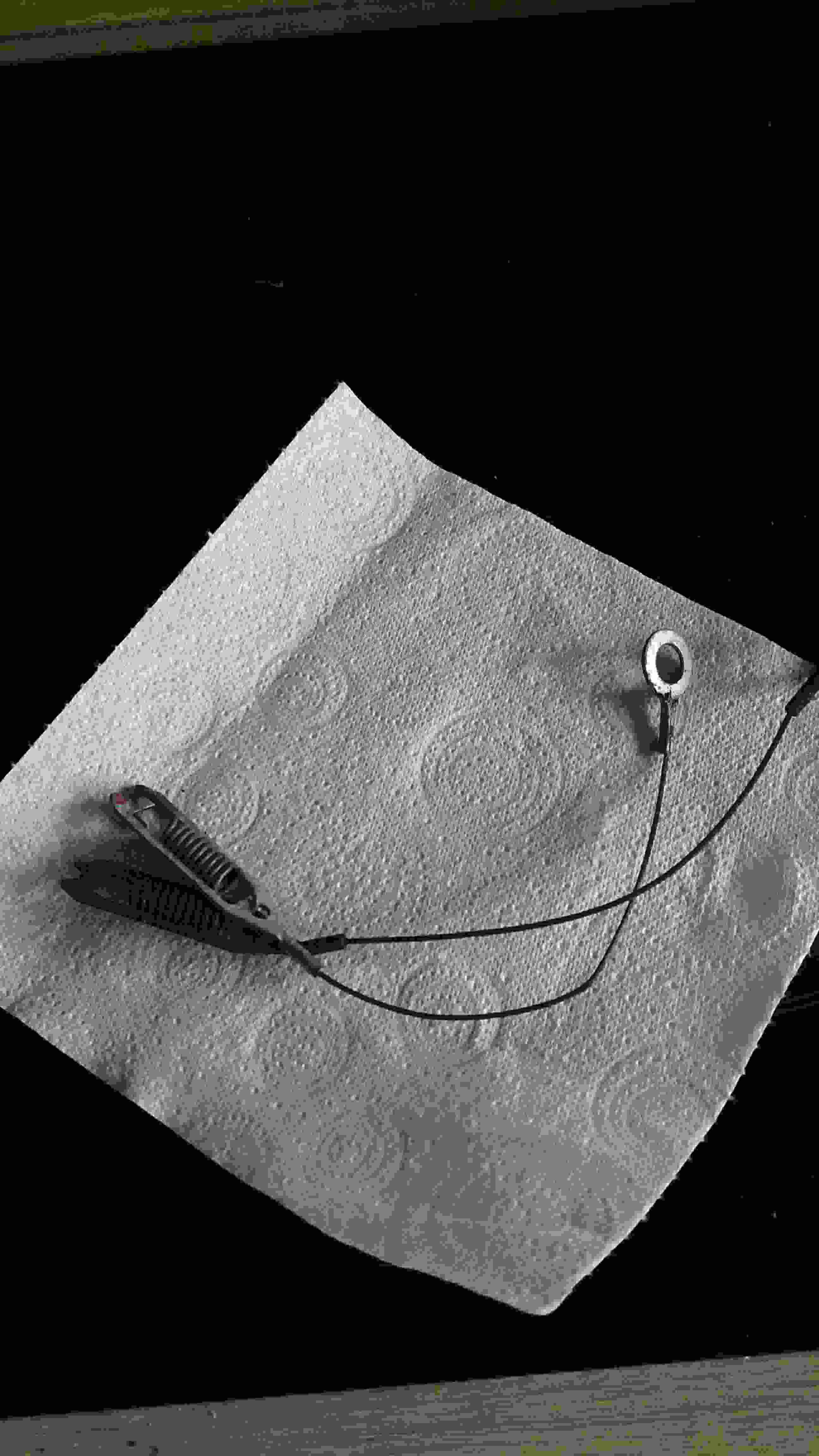

Post by Dart Vader »
this is what I have but it looks different unless anyone knows that it will still fit

Thanks Justin for looking.... the replacement ones from Rock Auto are just plain and there are different ones depending on 10 or 11 inch drums being used - mine are 11's..... What car do you think yours have come off ? I'll also have a search around Rock Auto and see if can spot them off another mopar.
