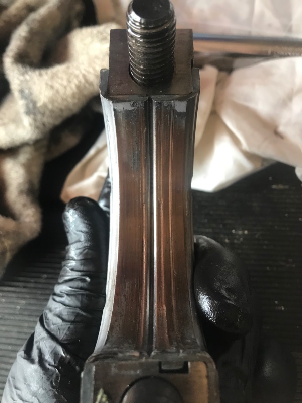

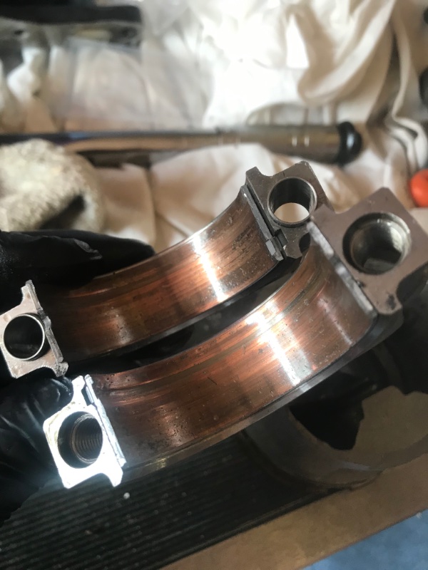

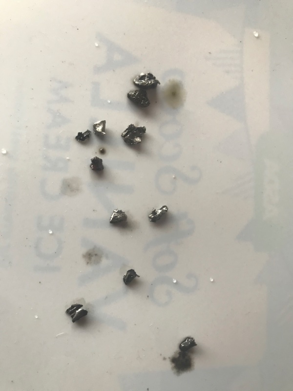

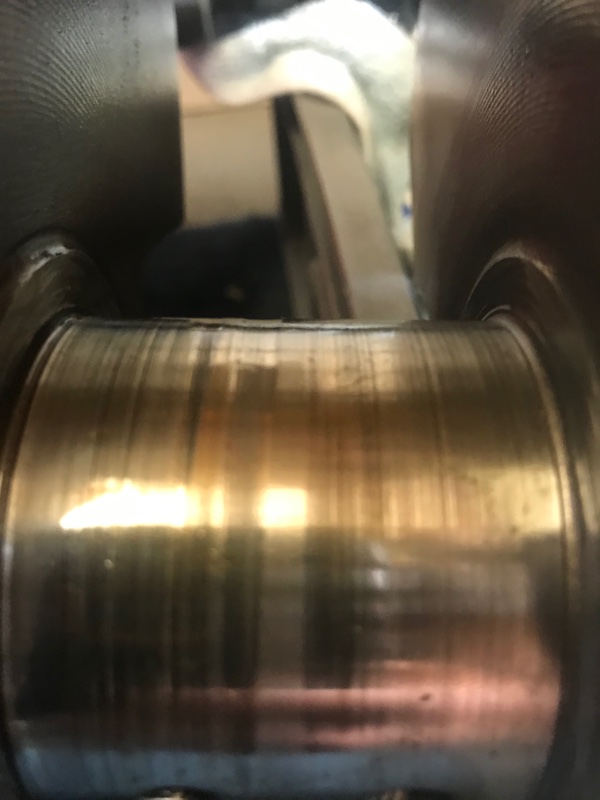

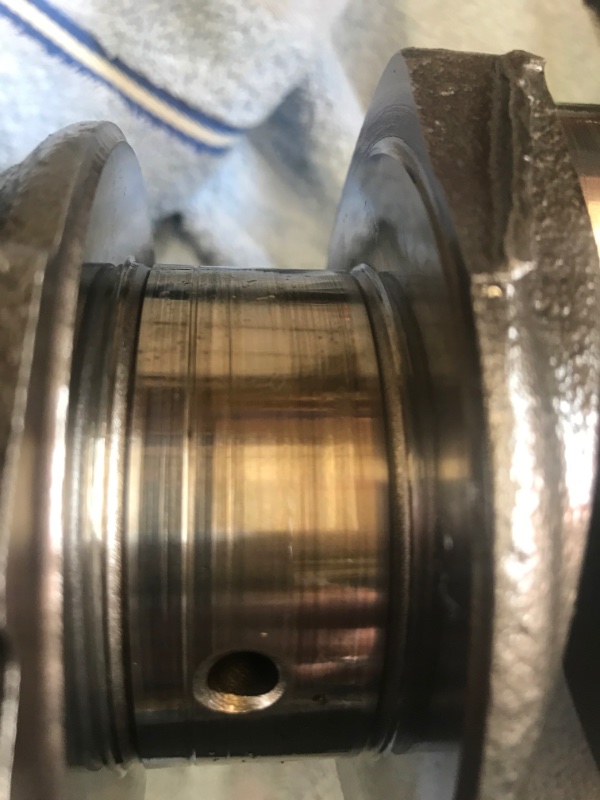

Pulled the engine yesterday and stripped down.
Was expecting this to be a minor overhaul but now think not.
From the pictures can anyone advise as to wether they think the crank is salvageable, at present the bearings are +10thou, can we go any further with grinding. Just asking for any advise before I get a machine shop to have a look. Also the metal fragments found in the oil pan, have checked every over and can’t see anything as to were they might have come from.
Cheers

Check with a magnet to see if they are ferrous - it looks like bearing material to me but I can't be sure.
I think you need to get the crank checked to see if it is out of round / Tapered as well...
Re: Engine advice
bearings are available for most motors to go up to 40 thou if you need to
however depends on what you want to do with the motor. i'd suggest most would be wary of basing a race orientated motor on a crank that is 40 thou under on everything
KingBearings do a range of "get the clearance right for the application" bearings as well in sizes such as 0.021 etc if you ask them
well they do for slant 6 hemi 6 and small block
they can also do one with a thicker thrust face as a block re claimer for blocks that have been machined on the thrust face journal by the factory or just taken a battering.
i can't remember the correct term but if you get your crank ground you will need to decide if you want the standard style undercut at the side of each journal. it helps with oiling but is a stress point. if you don't get it put back you will need to hand chamfer the sides of the bearings and closely check the side clearances to make sure there is some way for the oil to get out the sides and only at the right rate....
if the knurl on the crank for a rope rear seal is gone you will need to use a rubber rear main seal, worth in this case using a "stop rear main seal leak" rearmost bearing while you are in there. https://www.manciniracing.com/rbanlemabe.html
or make one yourself with a dremmel or a good sharp triangular file, quick smooth with the smoothest wet n dry (1200 +) to take off rough top edge, lubed with WD40 or diesel and then brake cleaner off all contamination from the bearing once done
