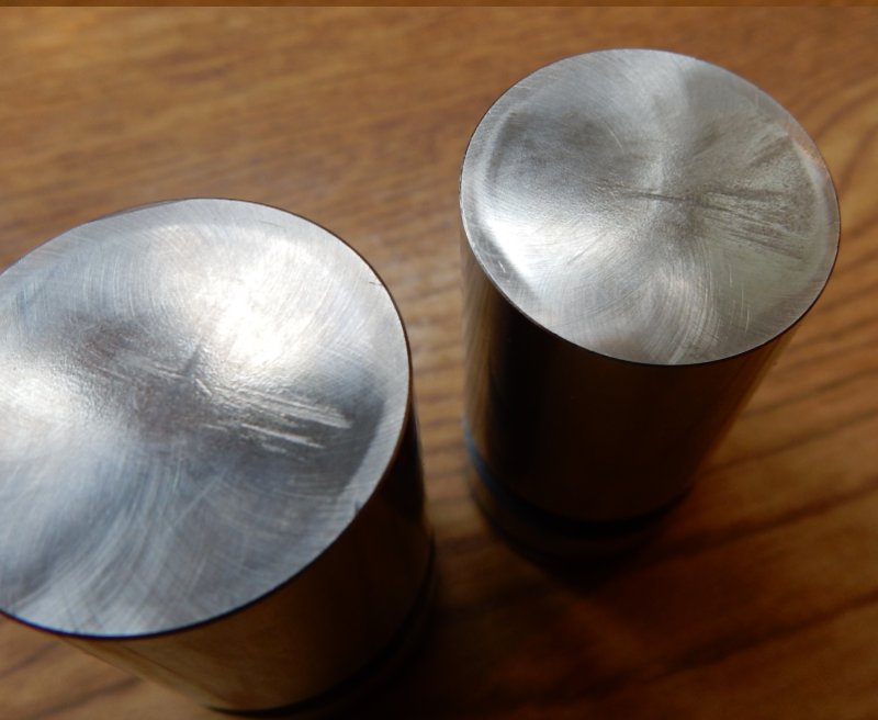

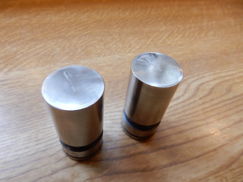

I have just fitted new cam and lifters.
Ran the engine for about a minuet and this happened to 2 lifters
Two questions :-k
* What would cause this ?
* What noise would it make ?
I do have my own ideas but would like some input please

Does the Head have Double Valve Springs?
If so, you should remove the Inner Springs Prior to Break in.
Did you use assembly Lube on the Lifter bodies?
Did you use "Torco" or a Similar High Pressure lubricant on the Cam Lobes, Lifter Bases, and Push Rod tips?
Did you use "Break in" oil?
Did you run the engine at around 2500 rpm for 20 minutes as part of the Break in process?
It looks like the Lifters are not spinning in the Lifter Bores.
My view is that the cam and lifters are now scrap.
They only have case hardening, and once you have gone though that, the wear will be quick and very aggressive.
Grinding paste through the engine....
Sorry its not better news.

Pete wrote: Sat Mar 06, 21 3:30 pm Does the Head have Double Valve Springs?
If so, you should remove the Inner Springs Prior to Break in. I used the original ones , just to break in the cam
Did you use assembly Lube on the Lifter bodies? Ahh! no' I have always used STP thick oil on builds.
Did you use "Torco" or a Similar High Pressure lubricant on the Cam Lobes, Lifter Bases, and Push Rod tips? No
Did you use "Break in" oil? Yes
Did you run the engine at around 2500 rpm for 20 minutes as part of the Break in process? Yes

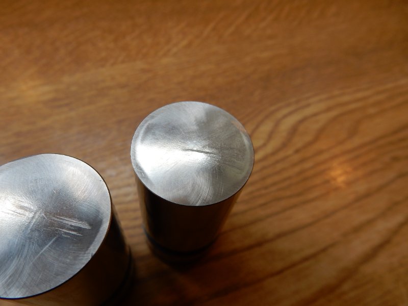

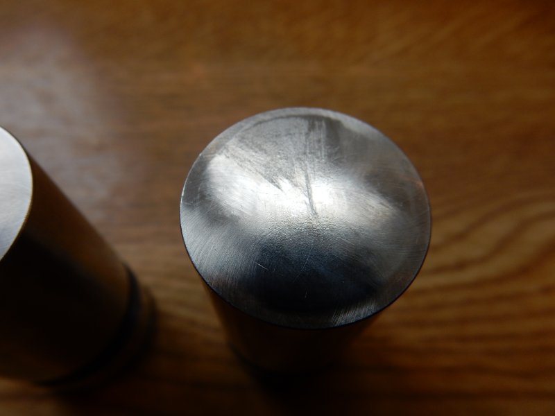

It looks like the Lifters are not spinning in the Lifter Bores. One has two marks , in different directions
My view is that the cam and lifters are now scrap. The cam doesn't look worn, it had a black coating in it, which is hardly removed , as said only ran for about a minute
Sorry its not better news. Thanks for the input
What noise do you think the lifter would make, with this damage ?
All good at start, then a god almighty screech/ howel a bit light a dry clutch release bearing when you take you foot off the pedal

Hydraulic Lifters should not make a noise at all - that is their purpose (that and the lack of need for manual adjustment).
Posts: 22143
Re: Hydraulic lifter damage
The Lifters should have Convex bases, this and a tapered grind on the Cam Lobe makes the lifter spin; which prevents it from wearing.
Any marks indicate the Lifter is not spinning.

I think the lude used was my problem
