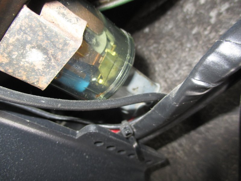

I don't Pete. Above my capabil
ities. Job for my mate Ian. Leg end over here. Hope to get down next weekend. Still working on indicator not flashing. Anyone know wat this is and where I can get one ? Thanks for the advice, Gerry
Posts: 5949
Re: dart info
Gerry, if the flasher is buggering about, get an electronic one from MOSS.
They are cheaper now than when i fitted mine, and don't use bimetallic strips to break the current, just electronics so teh flash rate is always steady. They were £20 a go, now listed at £10.
https://www.moss-europe.co.uk/electroni ... units.html
Car Builder Solutions do them too, even cheaper. They are a great source for parts.
https://www.carbuilder.com/uk/3-pin-tra ... V8EALw_wcB
Posts: 1184
Re: dart info
Cheers Matt :thumbright:
