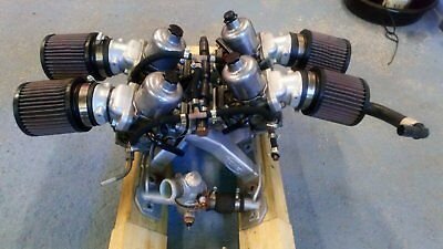

Far too sensible, trikes are all about the look, he wants one of these :geek:
